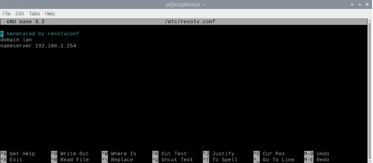

• Your router’s DNS (Domain Name System) IP address. This is typically the same as its gateway address, but may be set to another value to use an alternative DNS – such as 8.8.8.8 for Google, or 1.1.1.1 for Cloudflare.
To find the current DNS IP address, enter the command:
resolve 1
Note the IP address after nameserver – that's the DNS address – and then press Ctrl + X to close the file.

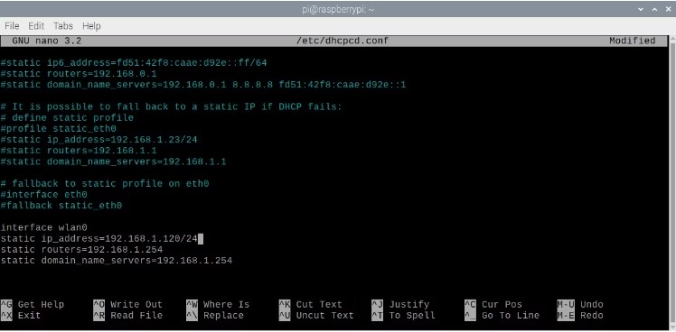

Now you have found all your network connection information, it’s time to edit the dhcpcd.conf configuration file to add the settings you need to set up a static IP address for your Raspberry Pi:
sudo nano /etc/dhcpcd.conf
If you haven’t edited the file previously, it will mainly contain various comment lines preceded by a hash (#) symbol. At the bottom, add the following lines, replacing the emboldened names with your own network details:
interface NETWORK
static ip_address=STATIC_IP/24
static routers=ROUTER_IP
static domain_name_servers=DNS_IP
Replace the emboldened names as follows:
• NETWORK – your network connection type: eth0 (Ethernet) or wlan0 (wireless).
• STATIC_IP – the static IP address you want to set for the Raspberry Pi.
• ROUTER_IP – the gateway IP address for your router on the local network.
• DNS_IP – the DNS IP address (typically the same as your router’s gateway address).
Here is an example configuration to set the static IP to 192.168.1.120 with a wireless connection to a router at 192.168.1.254:
interface wlan0
static ip_address=192.168.1.120/24
static routers=192.168.1.254
static domain_name_servers=192.168.1.254
dhcpcd 1
Once you have entered the settings, press Ctrl + X and then Y and ENTER to close and save the modified configuration file.

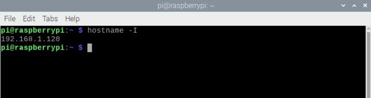

To check that it is working correctly, enter the following command:
hostname -I
You should now see the static IP address that you set in the dhcpcd.conf configuration file.
