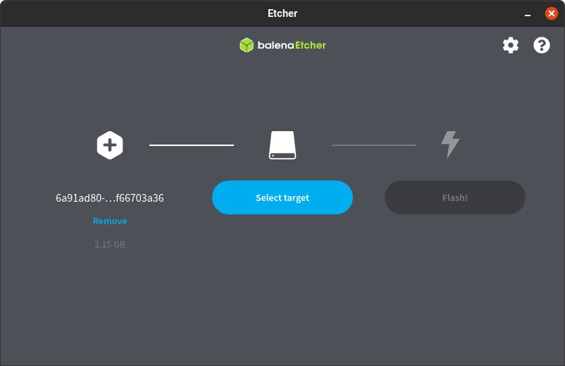

2) Once download has finished, you’ll have a zip file. Unzip it. Put the file on same PC that Etcher is running.

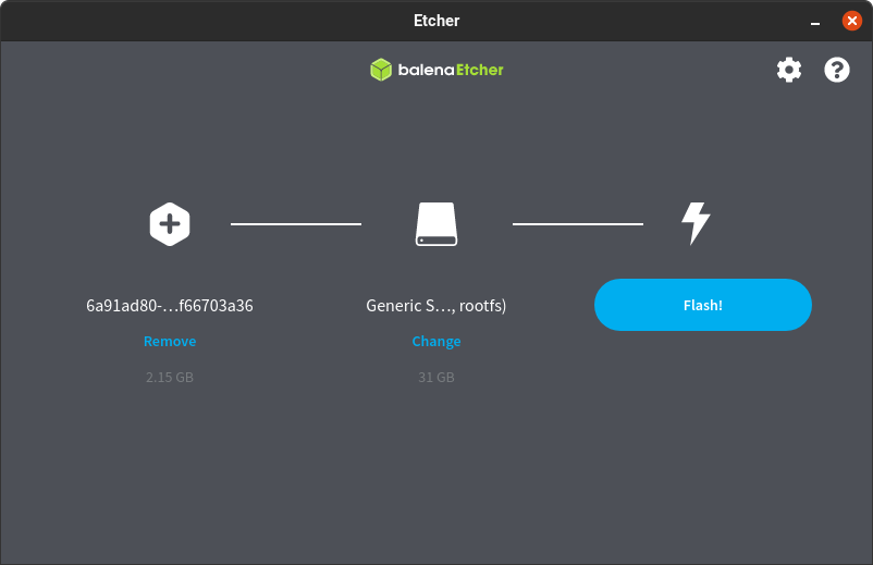

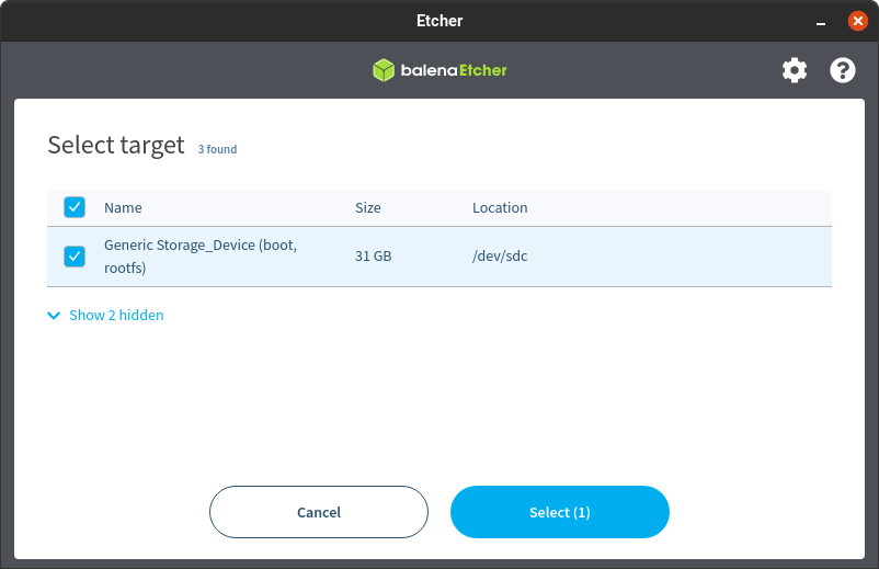

Select the USB Flash drive you want to use for your Raspberry Pi (NOT the Boot Drive! - which is typically hidden from view) and NOT the "Old" corrupt USB (burn to a new USB drive).
Click on “Flash!” to start writing the image:
When Balena Etcher is finished writing and validating the image you will get this confirmation:
