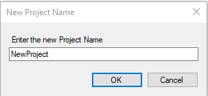

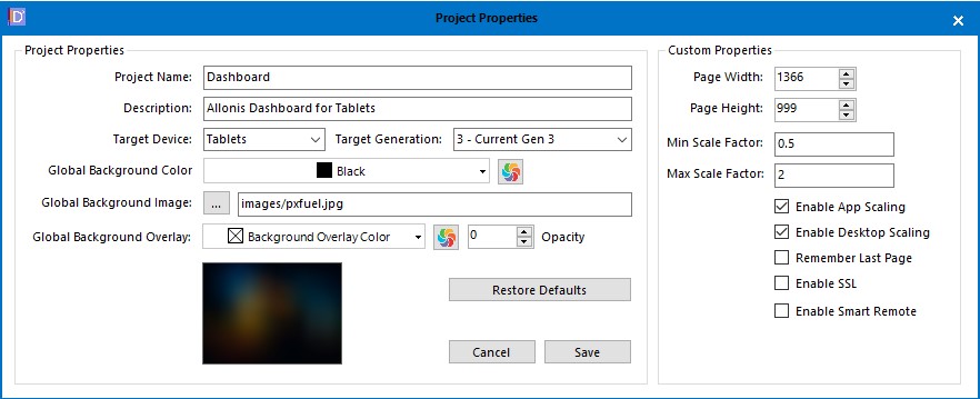

To get started the first thing you want to do is create a new project. Click on the "New Project" button from the main menu. You will be presented with the Project Name and Properties dialogs. Fill out the forms with the appropriate settings for your application.
Enter the name of the folder where you want your new project to live. Note that on Linux systems, all project names must be lower case. This will become a sub-folder of the HTML folder on your myServer PC. When you click the OK button there will be a slight pause as the myDesigner copies the files from the sample project into the new project folder.
Press Save to create your new project.

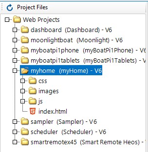

A new folder will have been created on the server with the name you specified. It will also be contain several sub-folders called css, images and javascript. Do not rename these folders and also do not delete or rename any of the files in the css and javascript sub-folders unless they are ones that you created. The myDesigner requires these folders and core files.

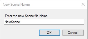

Now you are ready to start creating scenes. Highlight the active project on the Project Files tree view and click on the "New Scene" button of main menu bar. Enter the name of your new scene file (All scene files must have the extension .html or .htm!). You'll be presented with the new blank canvas.

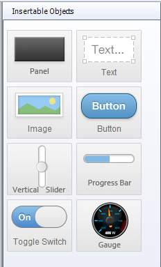

You are now ready to start adding objects to the scene. Click on the "Insertable Objects" button on the main menu bar to expose the objects collection.

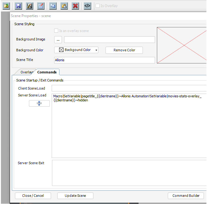

Once the scene is open you can click on the scene properties button on the scene toolbar to display the scene properties dialog. From this dialog you can specify a new background color or image for the scene that overrides the default values. You can also define up to 5 additional overlay scenes to be included with this scene. Overlays are useful when you want to implement popup objects and other advanced scene designs.
This is where you can specify any myServer commands that should be executed when the scene loads.

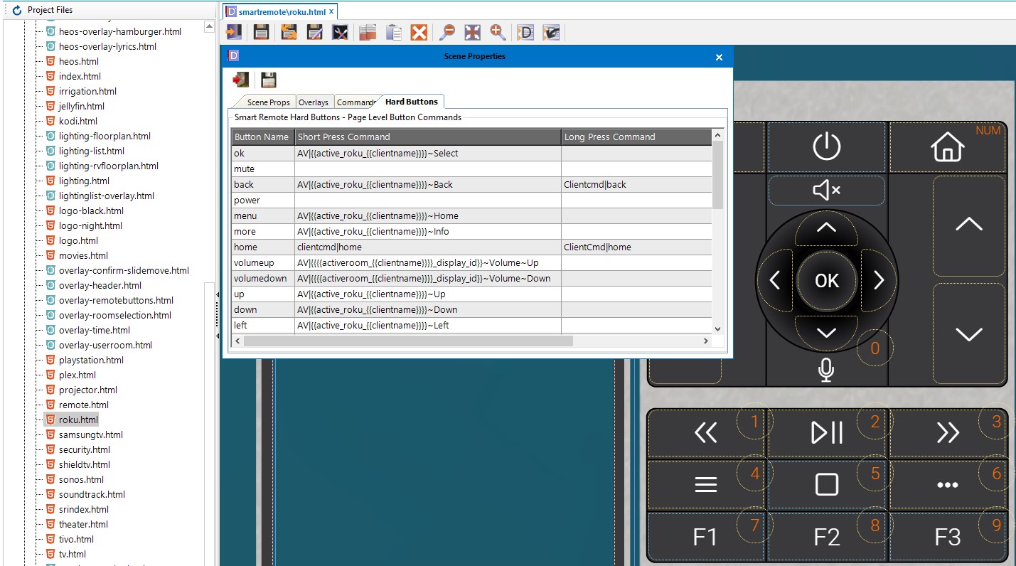

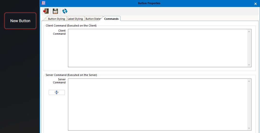

Designing how buttons work for the SmartRemote

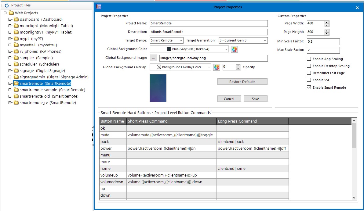

If you click on the web project name and click Properties buttons, you can edit the global project level hard button commands for both Short and Long press.
If you modify commands on a specific webpage, they override the Project Level commands when that page is loaded on the SmartRemote:
Designing scenes all revolves around dragging and dropping objects from the collection of insertable objects onto the scene being edited. Once an object is on the scene it is just a matter of right-clicking on it to define the object parameters. The collection of objects will continually be enhanced as the product evolves. The initial release will provides these eight objects for building the scenes.
To add an object to the scene it is as simple as dragging the image of the object you want to add from the collection of insertable objects onto the scene. The object will be added to the scene close to where the mouse pointer was when you released the button. Once an object is on the scene you can click and drag it anywhere you like. A single click on the object will highlight it and make it eligible for editing. You can click on multiple objects to select a group and then you can use the cursor keys to fine tune their positions on the scene.

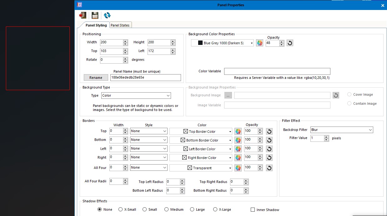

To edit the properties of an object make sure you only have one object highlighted and then right-click on the object and select the "Object Properties" option from the context menu. Every object has its own unique properties associated with it. They will be described in the following sections.

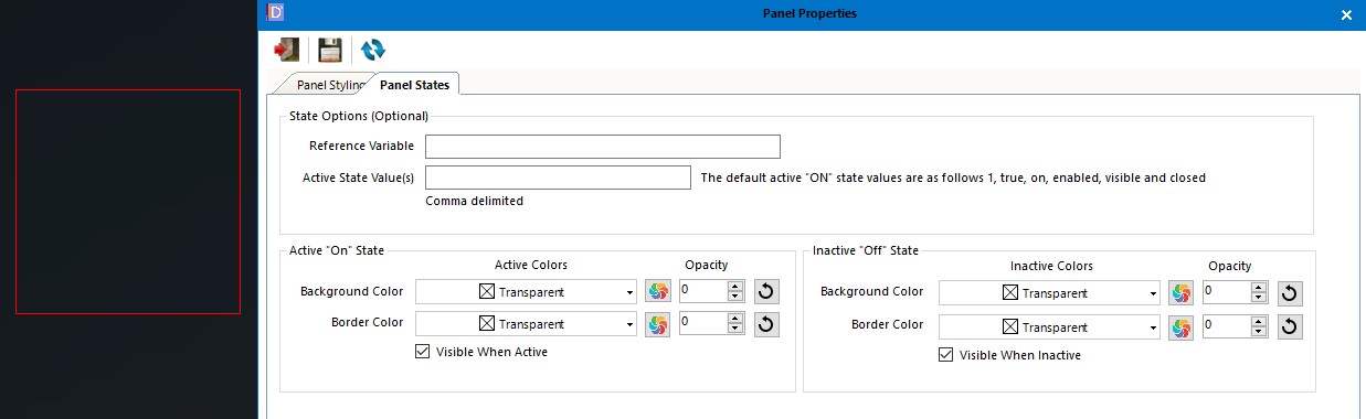

A Panel object is meant to be used as a background element on your scenes. You have full control over color and alpha (opacity) along with styling options like size, position and corner radii.

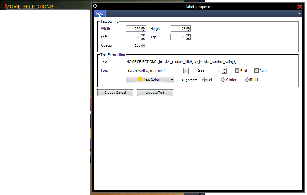

Text objects are meant to be used as labels or multi-line blocks of text. You have full control over the look and feel of the text displayed. Feel free to embed server variables on the text line. Add the server variables using the standard {{variable_name}} convention.
You can use myDesigner tools to only display text if a variable condition is met (like only show "Thunderstorms Nearby" if that's true). Just set the main label color to "red". Then, in the State Field, hide when active (0) and show otherwise.

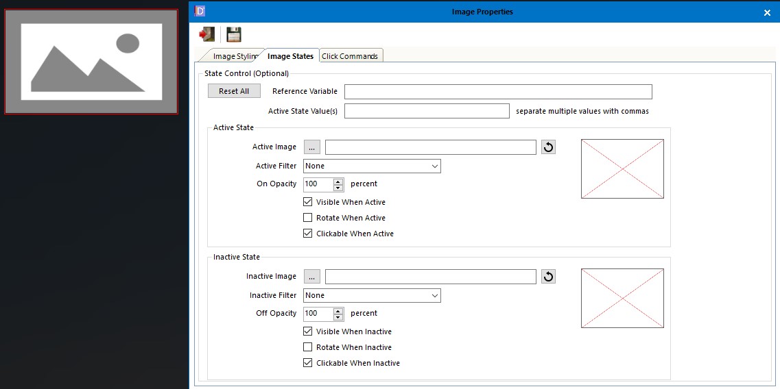

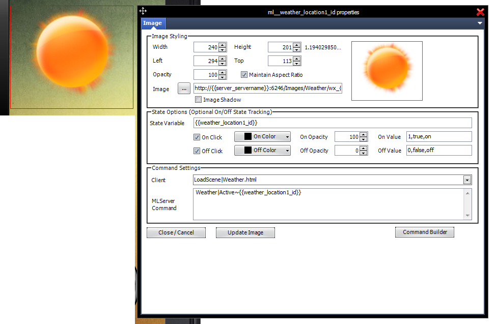

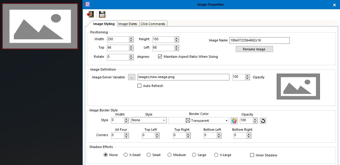

Image objects are used to display the images created via myServer or your own custom images. Drag new images onto the placeholder on the properties dialog or browse for them. If the image is generated by myServer set the path to the image using the appropriate server variable names.
Older V5 myDesigner example:

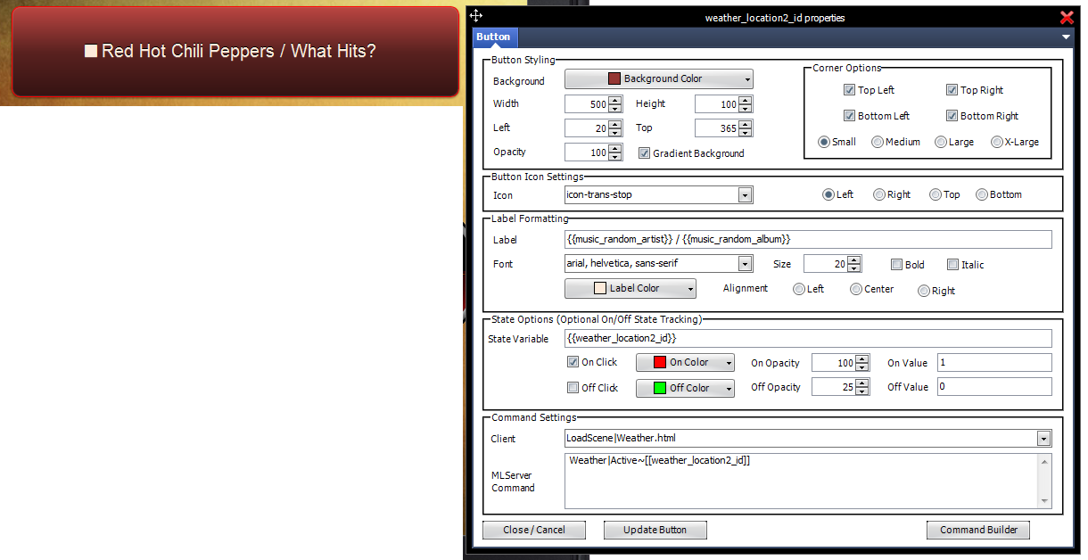

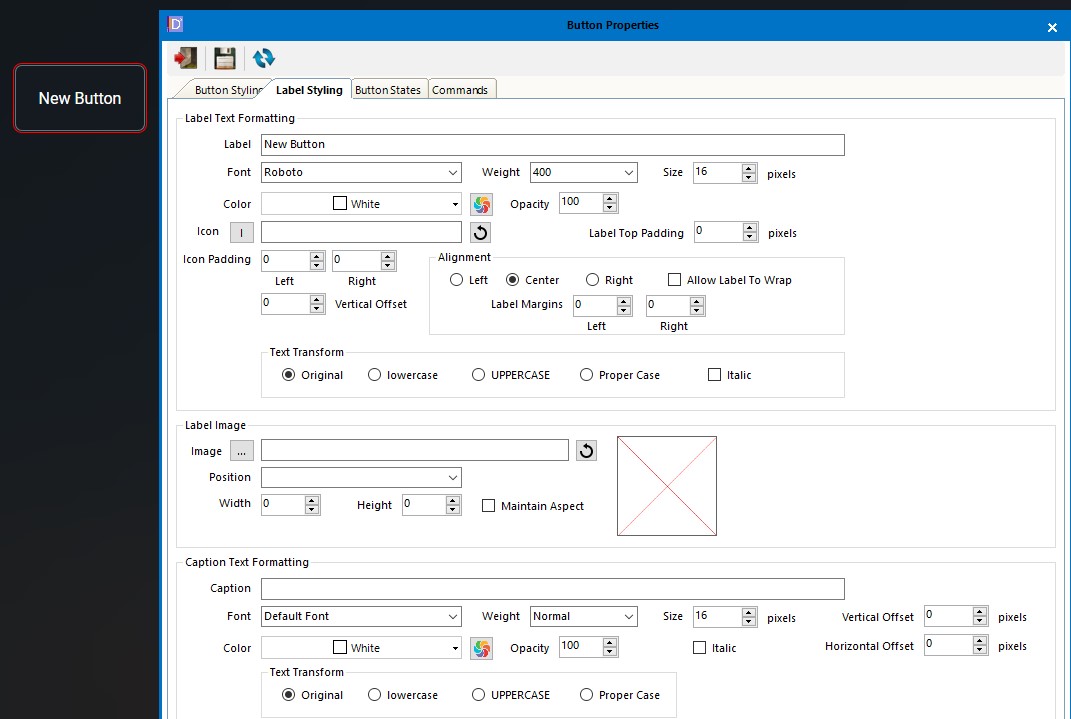

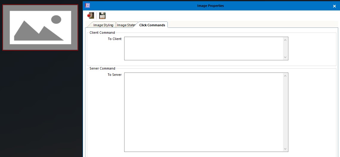

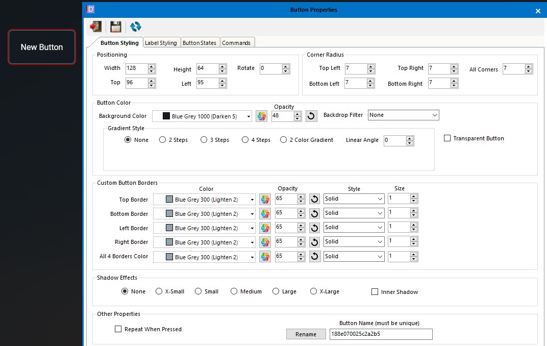

The Button will be the object you use the most. You have complete control over styling and label formatting. Additionally you can specify the local or myServer command to be executed when the button is pressed. The Button object also supports an additional "State" variable that can be used to control the look of the button based on the value of the state variable.

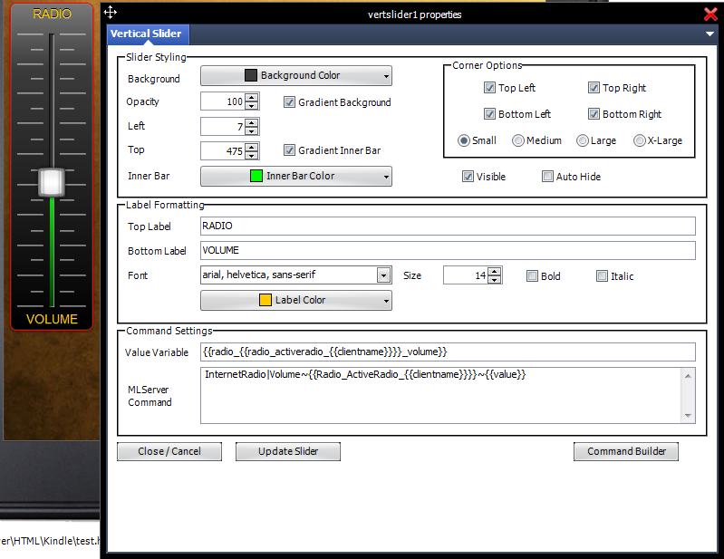

Vertical Sliders are useful for controlling volume and dimming lights. The can be used anywhere incremental control of a device is required. Full control over styling is provided. You only need to specify the name of the server variable that tracks the range (0..100) and the myServer command to be executed when the volume slider is released.

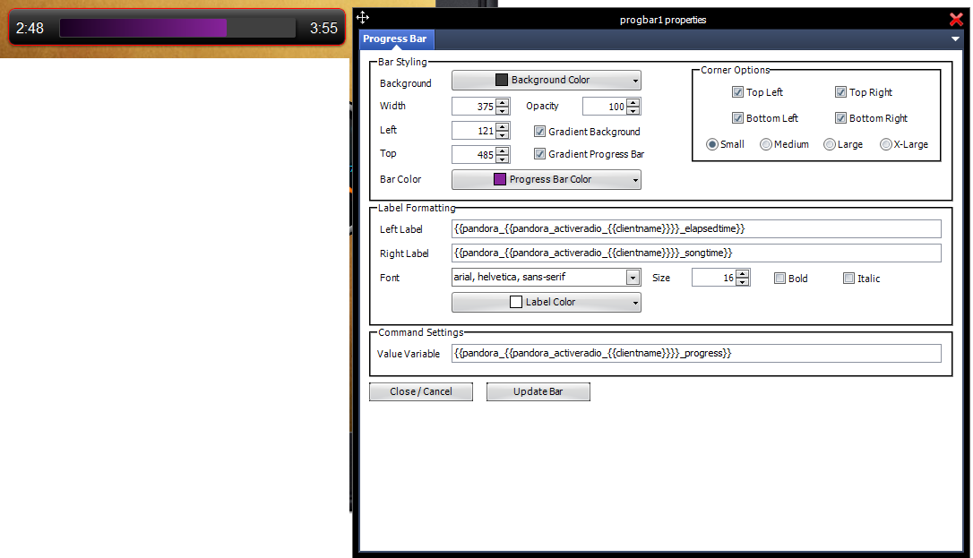

Progress bars track progress or simply can be used to track the level of a light. You make the choice. Style the bar to your liking.

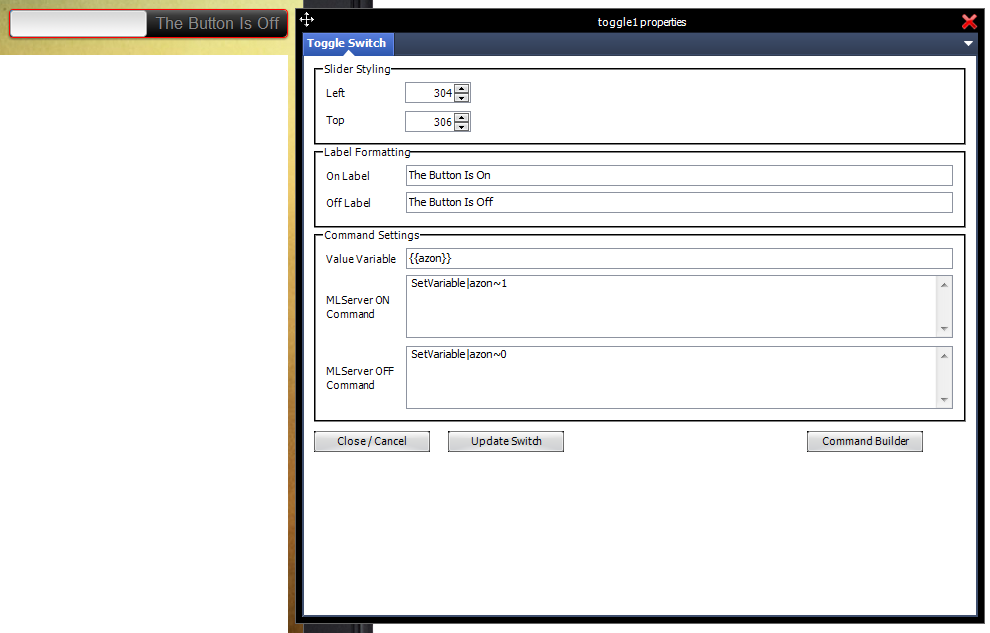

Toggle buttons make great switches for turning lights off and on. You get to specify the label text and the server commands to be executed in the off and on state.

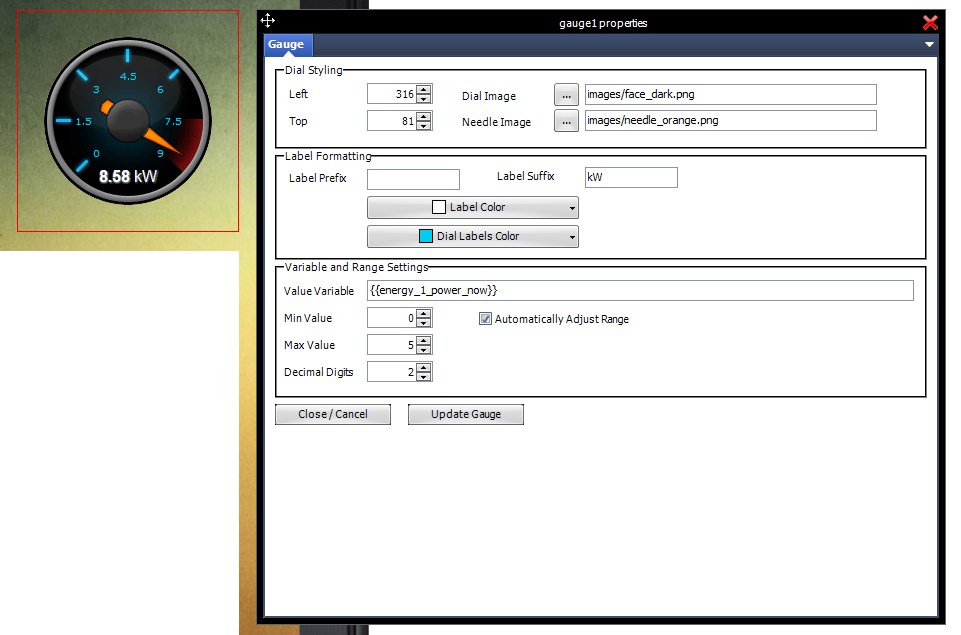

The Gauge offers a different way to track and display the value of a server variable. Create you own gauge dials and needles or use the ones provided. Style the labels and the set the server variable to track. Setting Auto Range will allow the Gauge to automatically adjust the min and max values should the value exceed the defines min and max.

1) Never look or be concerned with what lives in the \SampleProject folder that gets installed with the myDesigner software. That's for the myDesigner to use and nothing (no one) else.
2) All active projects MUST live in the myServer\HTML folder. No exceptions.
3) To make HTML happy project folder names will have all spaces removed from them when the project is created.
4) Same goes for scene files.
5) To get started on a new project install the appropriate sample project from the available sample apps via myInstaller. Currently they will create \HTML\myUI.Phones.samples and myUI.Tablets.samples folders.
6) Once you have installed the base project immediately copy the entire folder to a new folder (like HTML\Samples). In the HTML directory, rename the sample to be HTML\myUI.Phones and myUI.Tablets. This will. This will become to primary working project folder. If you download Allonis's updates, they will install next to your working folder so your customizations won't be lost.
7) You should next verify that you can access http://<your myServer ip address>/<your new project folder>/index.html from all the devices that you will be using.
8) If the Index.html page does not load or does not refresh then stop right there because there is something wrong that needs to be fixed. Most likely cause is that the myServer setting for DNS name has not been set to the IP address of the PC.
9) If you've got this far then it is time to look at the scenes in myDesigner. Make sure myDesigner sees your new project and the sample project in the project tree on the left side of the window.
10) Try editing the index.html file. (Note: that there is a 2 second delay when opening a scene and being able to edit the scene. This is done to allow the page to get fully loaded in the embedded browser. If you click too soon the page will still be "live" and it will execute the command associated with the button you pressed)
11) At this point in time you should be good to go with doing your own designs.

Dynamically updating images
To update images by specifying the file names by having a myServer variable called {{myimage}} with a value of someimage.png. For the image object, If you specifiy the filename as images/{{myimage}}, this will not refresh the screen if {{myimage}} changed value.
However, if you have {{myimage}} have a value of images/someimage.png, and for the image object you specify the filename as {{myimage}}, then a screen refresh will occur when {{myimage}} changes.
(thanx Roman for providing this tip on the forum)

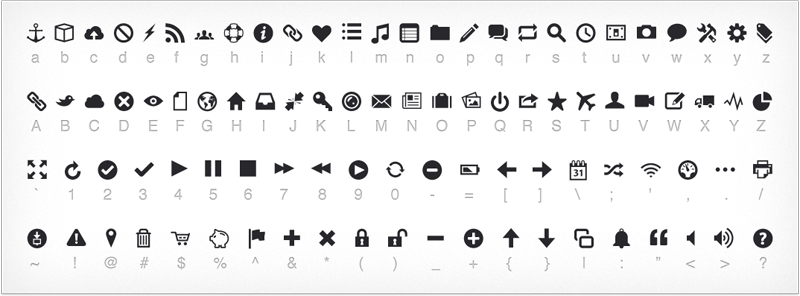

The myDesigner includes several special web fonts that are useful for control icons and other special characters.
If you want to inject an icon into a label you can insert code that looks like
Code: Select all
<i class='fa icon-material-touch-app'></i>substituting icon-material-touch-app with the name of the icon you want to inject. For button objects just pick the icon from the dropdown.
You can install the latest Material fonts into the project\css\fonts folder. Then you'll have to edit the font-icons.css file adding in the new icons that are missing.
The following images depict the keyboard mappings for the fonts.
Pictos Font
Transports Font
Font Awesome
