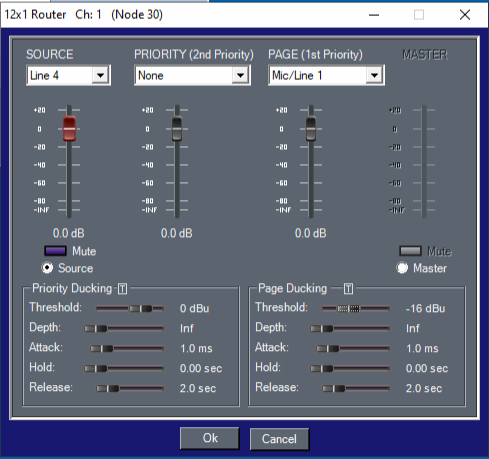

Here is the DBX setup:
DBX setup1
 Note you can also within the DBX software configure Microphone / Line In Ducking to prioritize the media file audio over the top of the current audio source.  The current source then fades back in when the media file audio is done playing.
We used -16db threshold setting.
DBXDuckingExample
