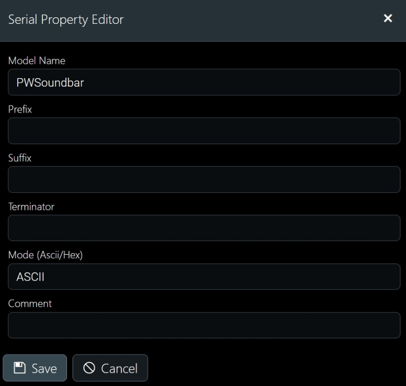

Here's my serial model.

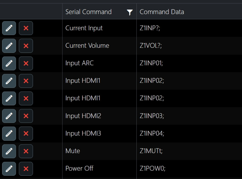

Here's the serial model settings
