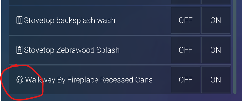

It seems like the Moonlight template is crashing. I go to the lighting screen and click the list view. That brings up all of my rooms. Then I click on a room such as the Basement Amp Shop where my desk is located and I can click the on/off buttons a couple times and then it freezes and won't respond until I reload the Moonlight website. This happens with any room I try.And after a few clicks to navigate around the Moonlight site, some of the icons disappear This happens with any room I try.

OK I went through the Rooms configurator under "Configuration" in Dashboard and I think the Rooms here reflect what I have in the init.house-lighting macro.  The first time I tried it after this I got about ten light switch events so being rather encouraged, I started wandering around the house with my ipad and after a few more switches in other rooms, it froze again in the Kitchen.  I noticed it froze on a circuit that has a different icon in Moonlight that looks like a little flame.  All of the other circuits have an icon that looks like a switch wall plate.

Also, I added a fireplace icon that comes on when the fireplace is on.  I just copied that one from the original Moonlight.  Eventually I will add indicator icons for all of the lights in the house.
