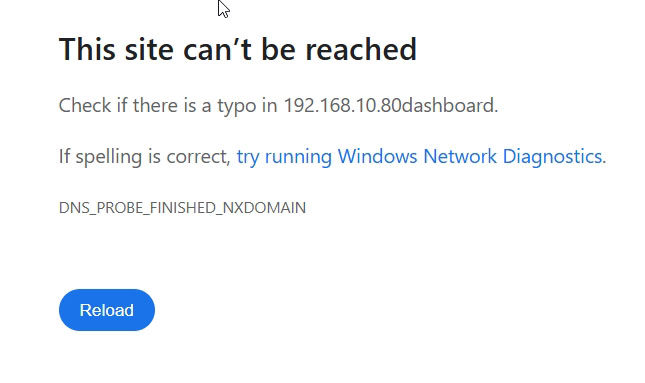

MyServer IP is 192.168.10.80.   Settings in MyDesigner reflect that.   Launch MyDesigner and I see some projects.  If I want to load an html file to check it out I double click it.   When I double click it a tab appears in MyDesigner but just a white screen below.   Also, I can't create a new project.   I create it and save it but it does not appear in the projects list to the left of the screen.  For grins if I try to launch a project I get "This Site Can't be Reached."     Somehow it's navigating to 192.168.10.80dashboard.   Obviously not a good address.    Thx

That sounds like permissions aren't properly set for the HTML folders...is this on Raspberry Pi using the Master Image? or a Windows box?

Sorry David, on a hunch I disabled Norton and I can now launch and edit projects. The strange IP addresses that were being launched really threw me off.

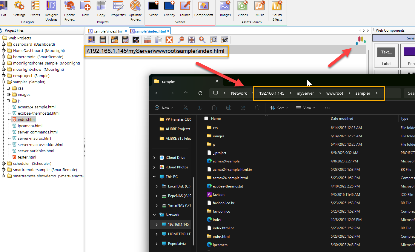

I'm having a similar problem. Can't open any page on the designer:
My Allonis MyServer is running on the original small appliance (original Allonis RPI4). I enabled the myDesigner into the windows firewall, turn off the firewall, but it is not opening anything. It works from the explorer.
Any ideas?
