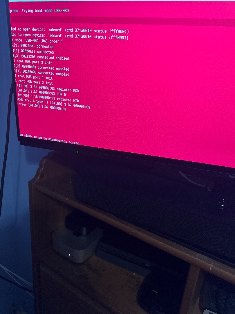

This is what I get when I try to boot from the old SSD
Anything I can do from that?
9 months 1 week ago #4526
Replied by David Li on topic Controller is unreponsive
Boot from a new 400mb/s samsung usb that has the new Master image on it.

Hi Davd. Would I be right in thinking that means I'm screwed?
The new PI booted no problem from a new USB and again when I added the old SSD back in. I couldn't see the SSD in file manager though

Do you have the USB jumper installed? Without that, the Pi can't see the SSD drive.
