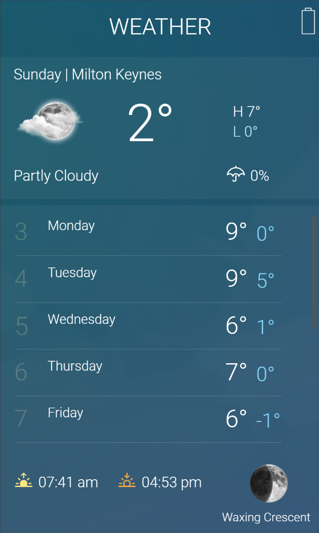

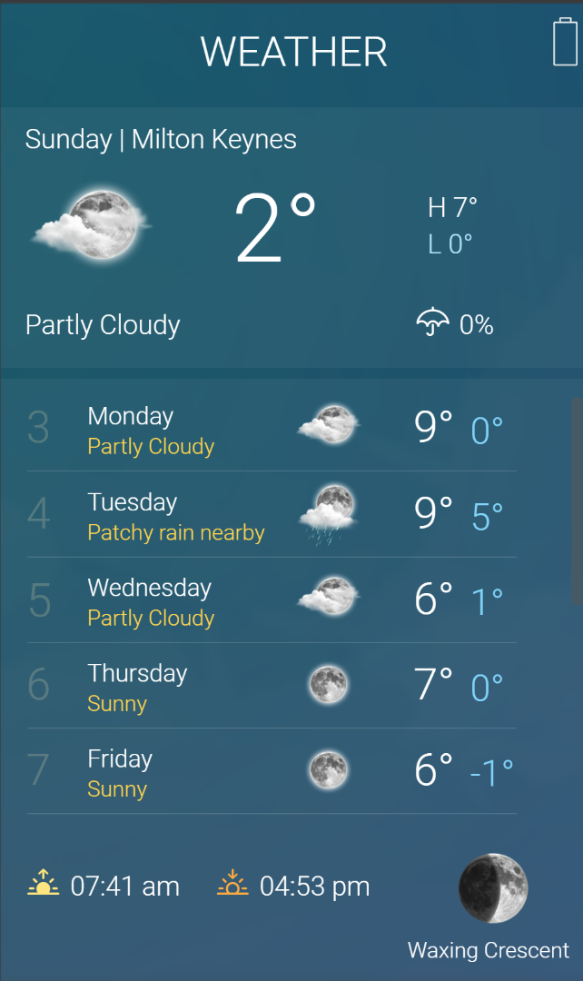

As I feel I'm just beginning to get a grasp of how rooms, devices, sources, IR models etc all fit together I naturally started playing with something else I didn't understand. I'd tried to get the weather app working previously but it hadn't seemed to want to download any data. This time I tried it and success! I've got a massive list of myServer variables related to local weather. Then I had a look at the weather scene/overlay in the smartremote template. It looks like that might be in the process of being updated as the label contents variables have slightly wrong names. Changing all the daily forecast label images to {{weather_forecast_XX_icon}} and the daily forecast labels to {{weather_forecast_XX_phrase}} got me a neat looking scene. Screenshot in next message as per usual (you can't attach files in the first message of a topic which is odd).

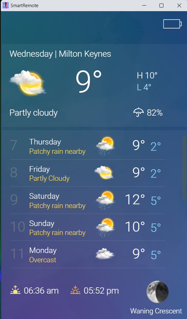

I've actually started using the weather app on my smartremote and it looks nice. Except that the overlay template is still using the wrong server variable names. So you have to change all the daily forecast image variables to {{weather_forecast_XX_icon}} and the daily forecast label variables to {{weather_forecast_XX_phrase}}
Before changing:
After:
Before changing:
After:
