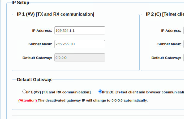

Here is what the Video Controller settings must look like:
HDTVVoIPsetup

  1. The HD over IP Video Controller does NOT issue IP addresses for TX and RX devices on the Video network.  Therefore, they will be on a 169.x.x.x network.  Optionally:  the computer running the HDTVSupply Windows Video Over IP software must be networked directly to the Video Network Ethernet switch on the 169.x.x.x network to "see" the TX and RX devices.  Link to download the Windows Video Over IP software
