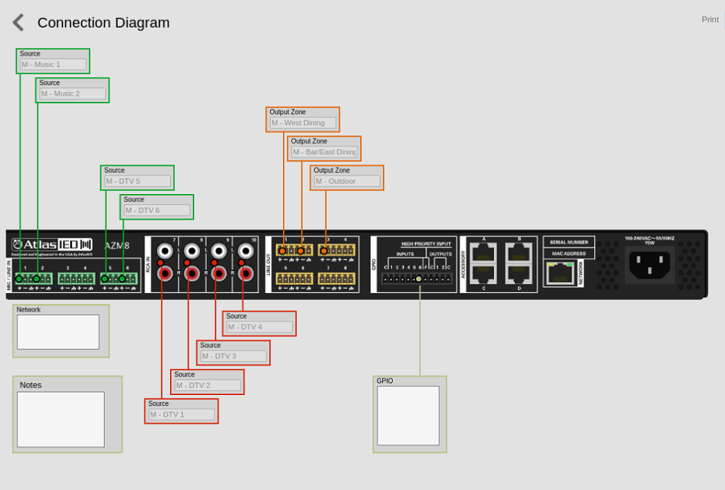

The Atmosphere provides a neat connection diagram that can then be used to configure myServer for the respective Input / Output ports you used.
atlas connections
