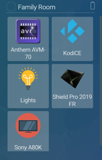

 The Room(s) now look like this:

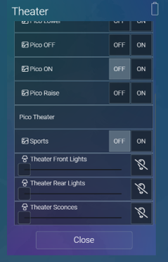

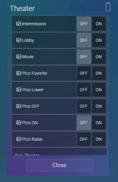

Selecting Lights brings up this screen:
After selecting the Room, it looks like this.  Note that the list is scrollable.
Some suggestions for improvement the layout:
For the Pico Remote, the remote itself appears in the list, along with each button.  It would be nice if the buttons were in a sub-menu under the Remote.  Selecting the Remote would expand the list and selecting it again would collapse it.
I tried assigning the Pico Remote to the Equipment Room, so that only the buttons would be displayed.  That works, but it adds the Equipment Room to the list of rooms to choose from.
Buttons don’t have a toggle.  Having both OFF and ON is confusing.
Scenes are just buttons on the Hub.  They don’t need OFF and ON either.
