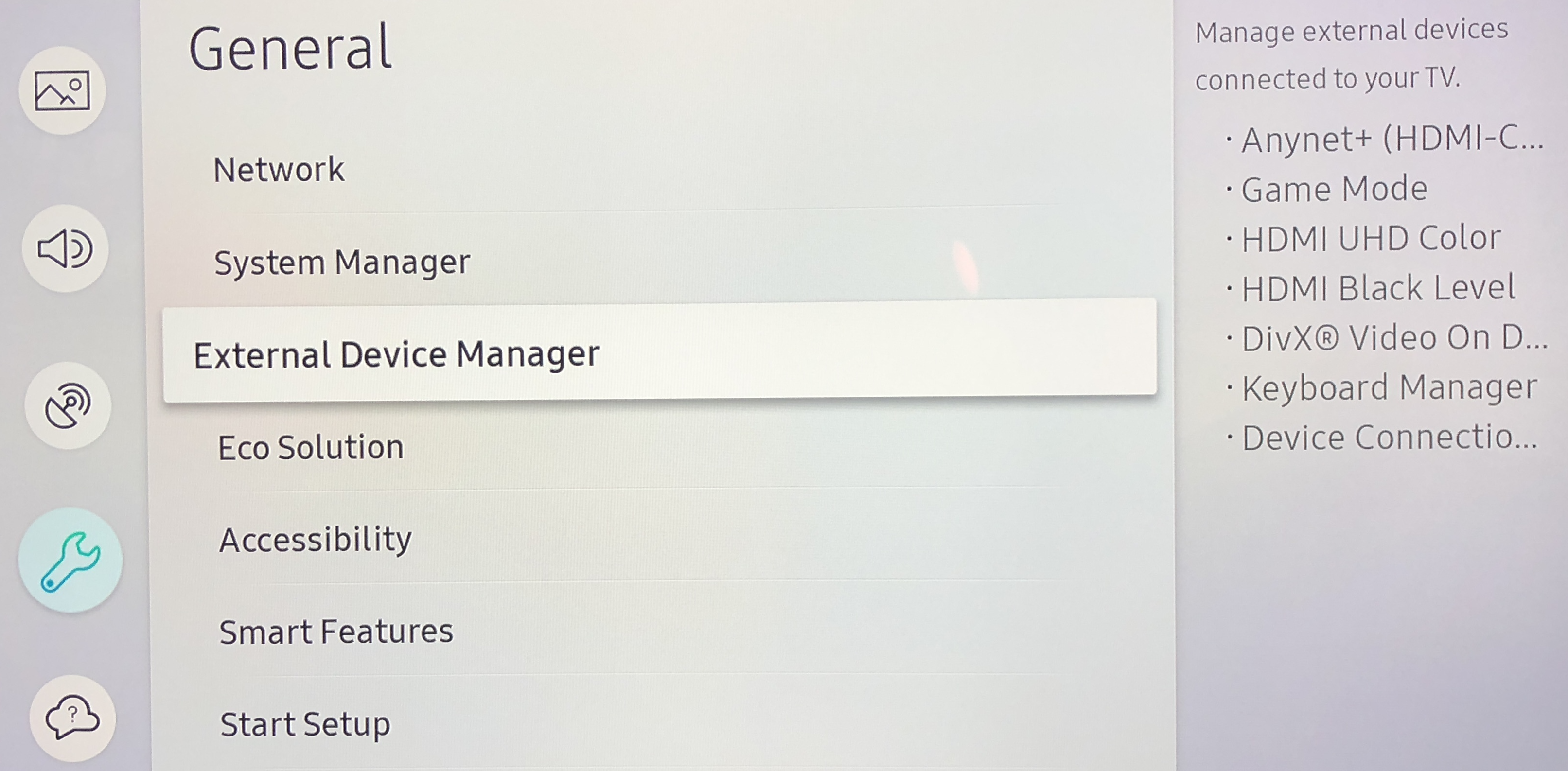

On newer TVs (about 2018 and newer), you need to enable "External Device Manager"
Settings -> General -> External Device Manager

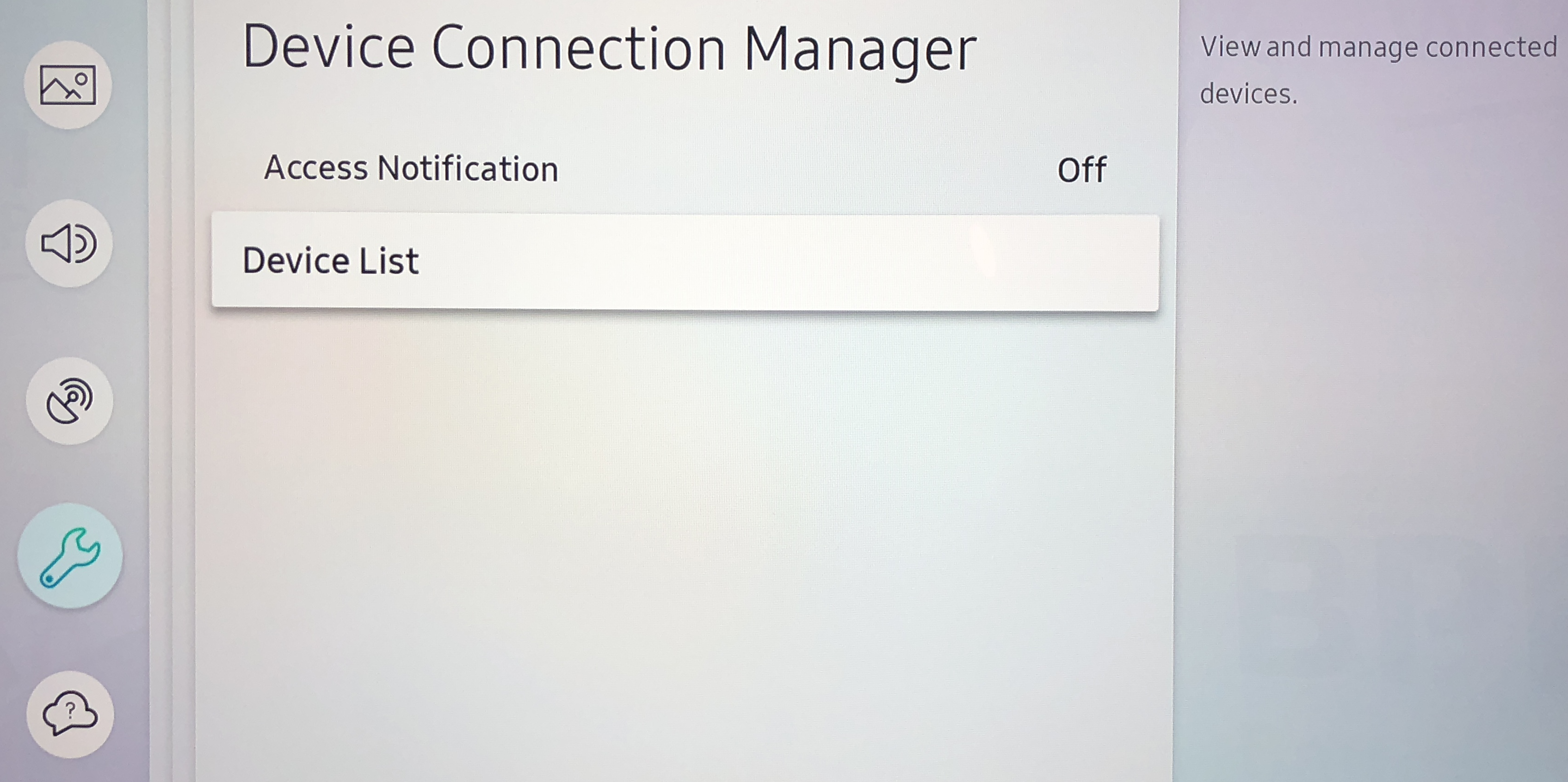

-> Device Connection Manager
-> Device List

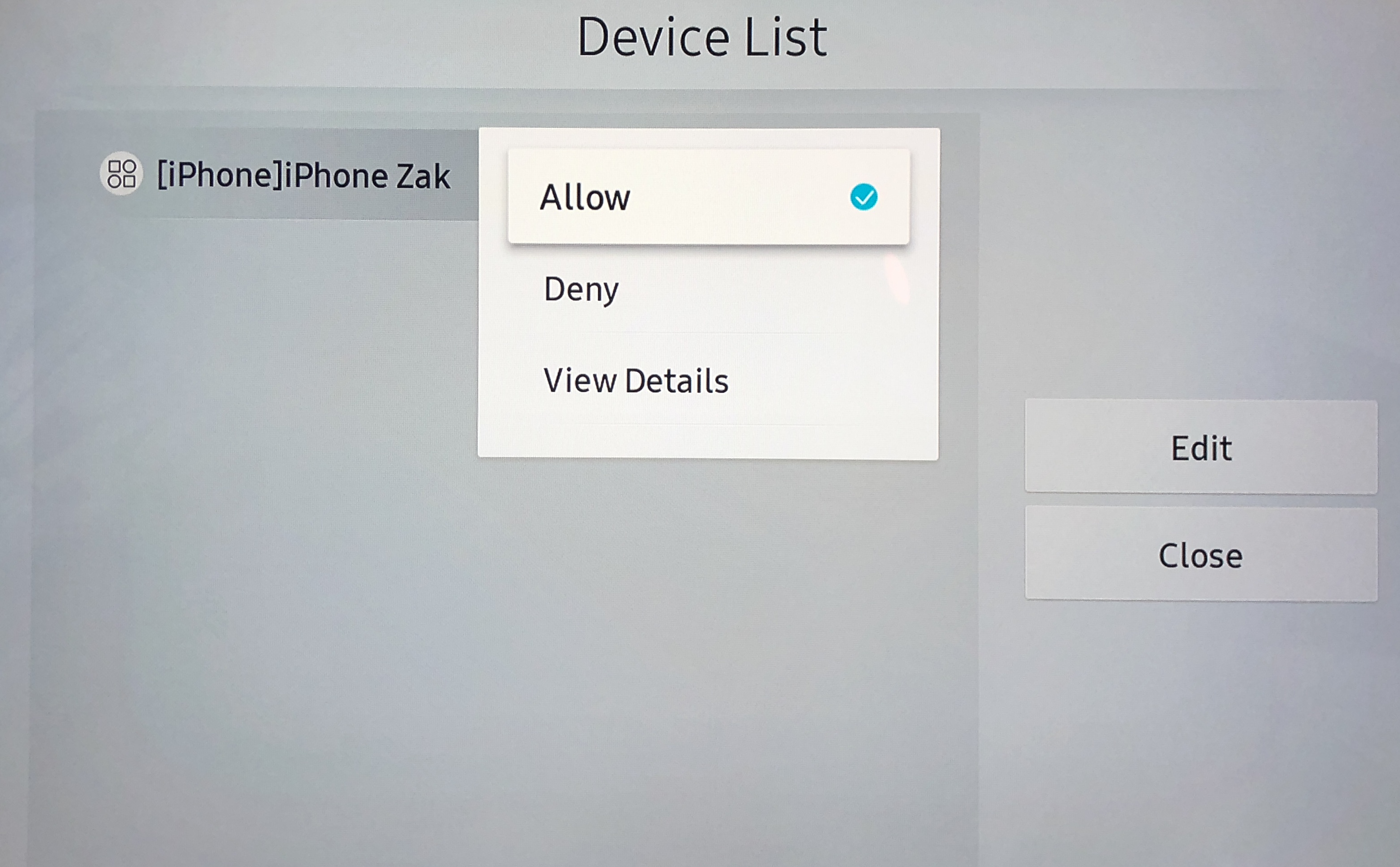

You have to click on iPhone/iPad item to choose Allow
You should confirm that the authentication notification is set for "First Time Only".
