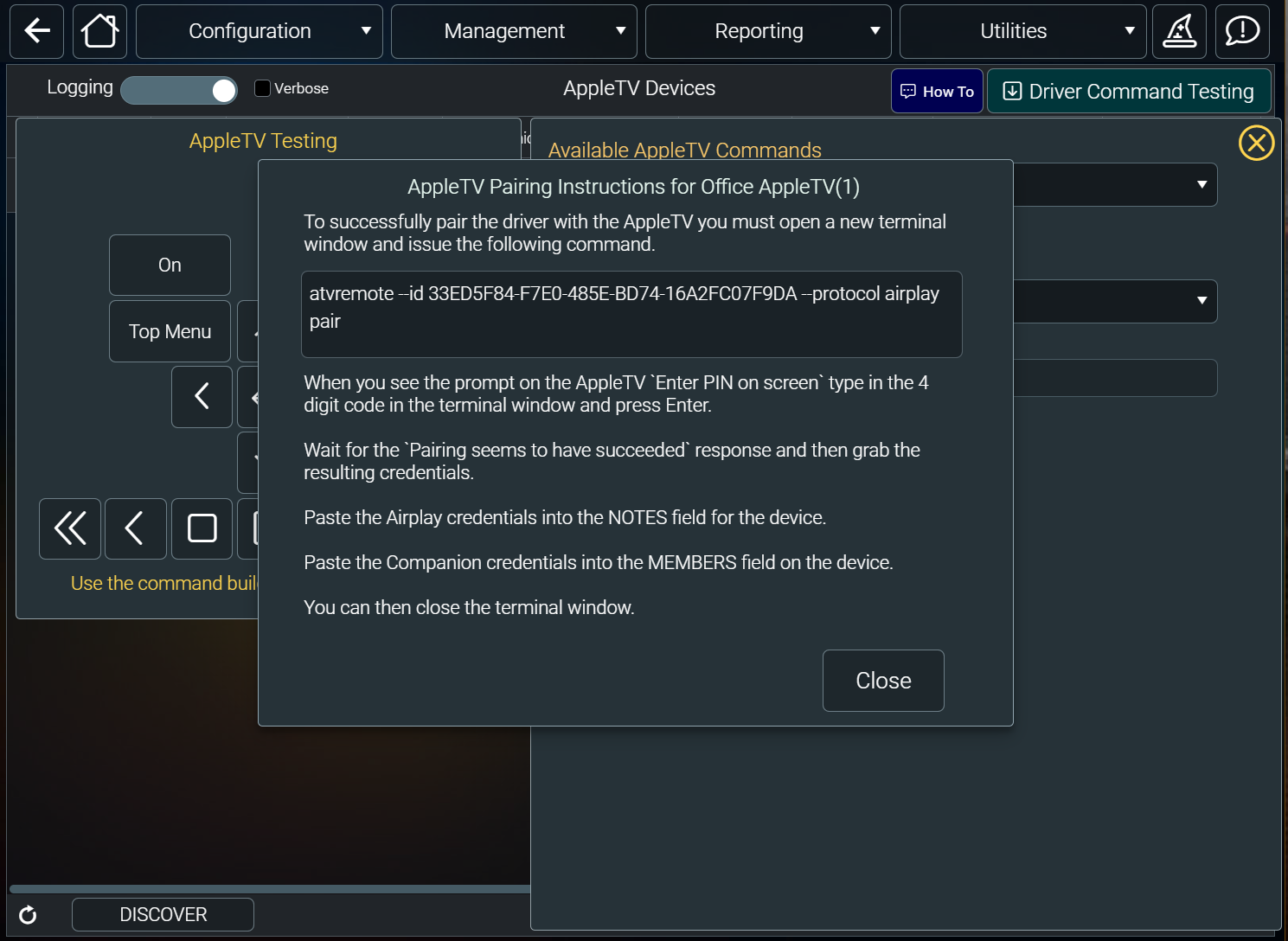

Click on the Execute command button and a new dialog will appear.
AppleTVPair 2

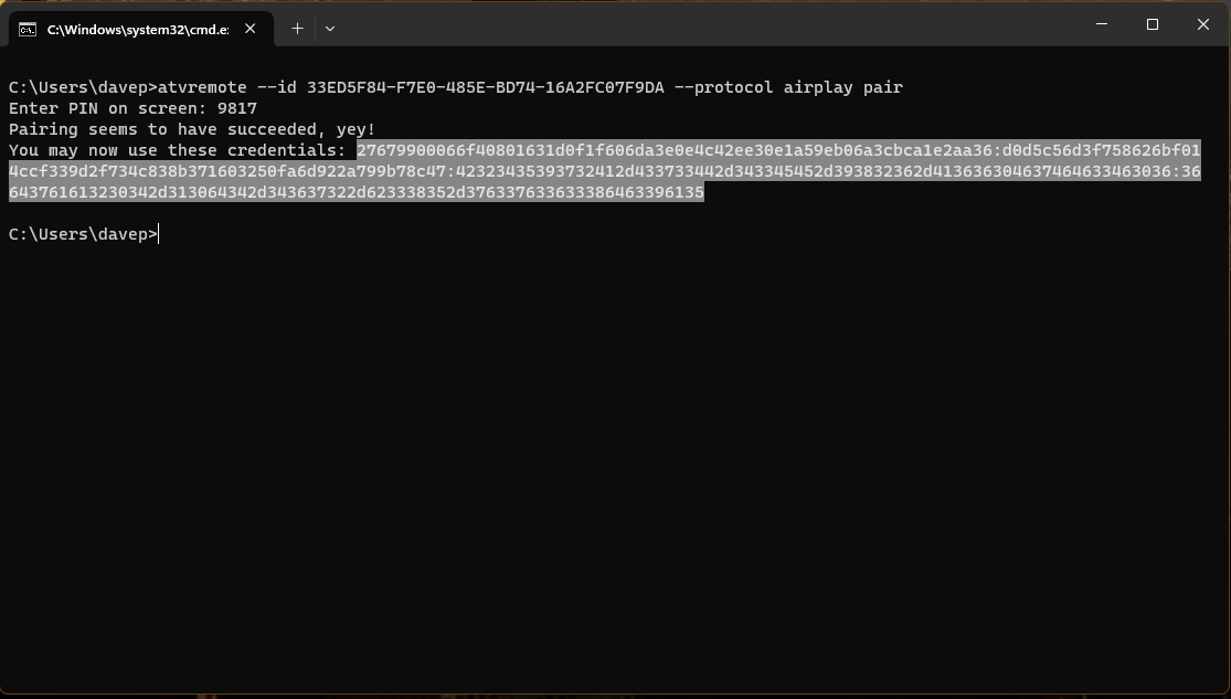

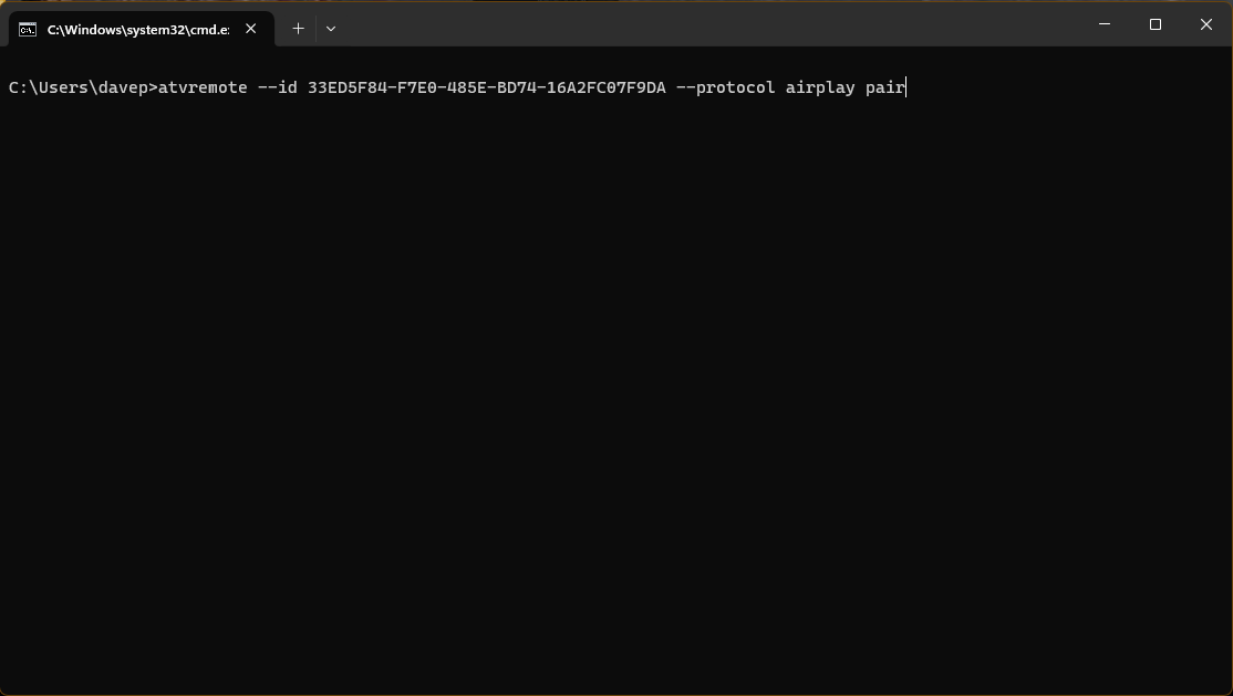

Open up a new terminal window and grab the text displayed in the textbox that starts with atvremote and ends with pair. Copy and paste this text into the terminal window you just opened.
AppleTVPair 3

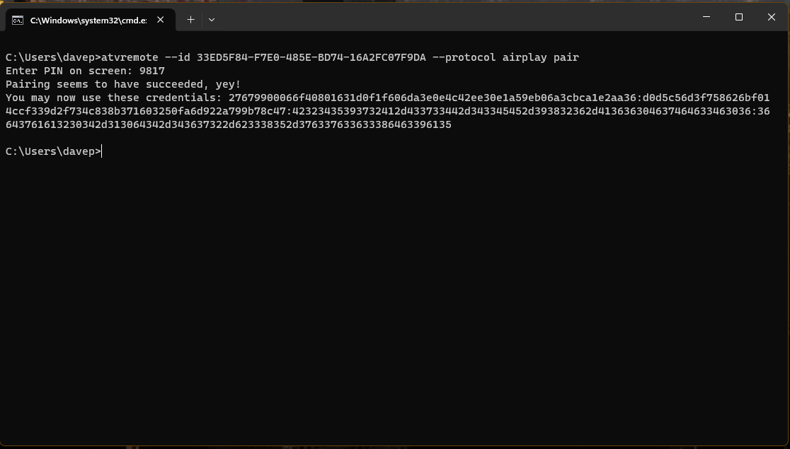

Press enter and watch the screen on the TV where AppleTV is playing. You will see a 4 digit pin code pop up on the screen.
Enter those 4 digits at the "Enter PIN on Screen:" prompt in the terminal window. This will generate the final Airplay authentication token.
AppleTVPair 4
Next grab that token by highlighting the entire token and right-click and select copy.
AppleTVPair 5

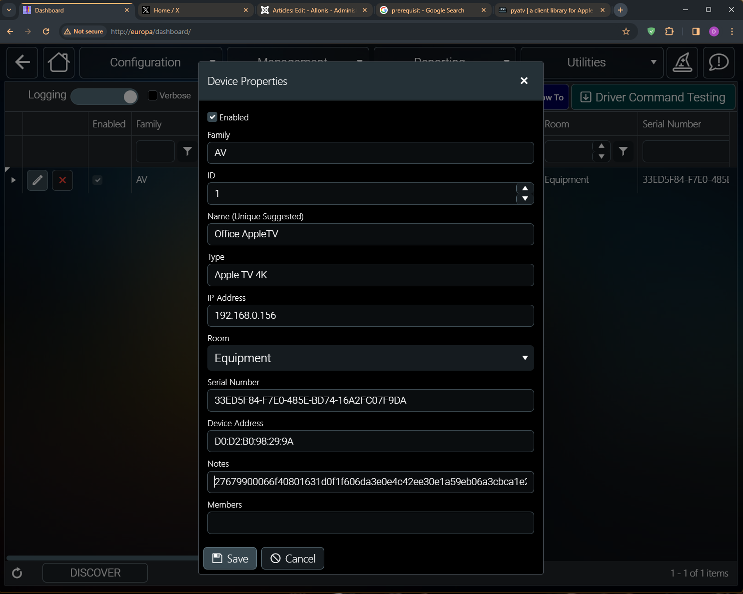

Now go back to the dashboard and close the Driver Command Testing window and click on the pencil icon next to the AppleTV device you are pairing. This will bring up that device editing window.
AppleTVPair 6
 Paste the authentication token you just copied into the Notes field in the editor window and click save.

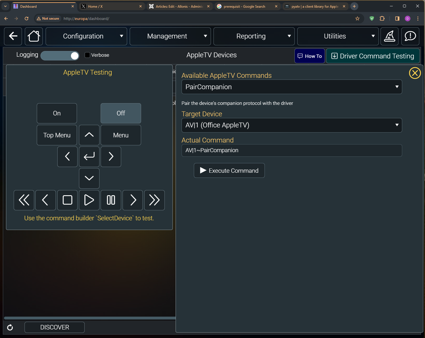

Next go back into the Driver Command Testing and this time select the PairCompanion command. We are going to repeat the same process for the companion token.
AppleTVPair 7

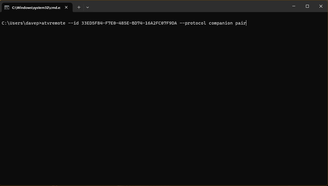

Once again open a terminal window and copy and paste the command into the terminal window.
AppleTVPair 9

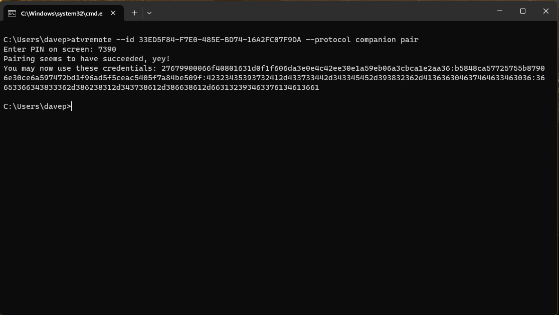

Press enter and then get the new 4 digit code off the TV and enter it at the PIN code prompt to generate the companion authentication token.
AppleTVPair 10

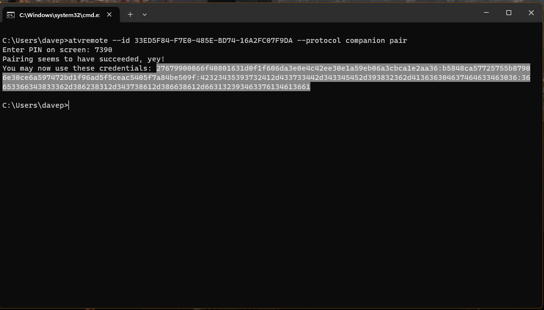

Once again copy this new token like the previous one.
AppleTVPair 11

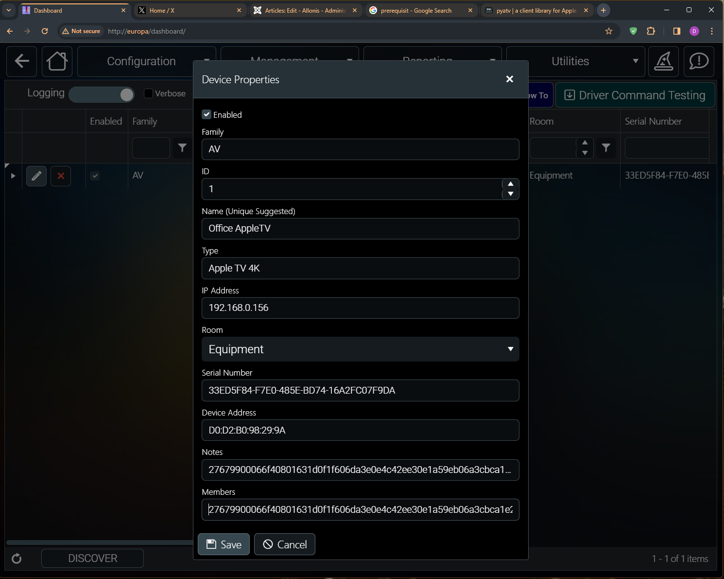

and then close the Command testing window and re-edit the AppleTV device. This time paste the new token into the Members field in the editor window.
AppleTVPair 12
Press save.

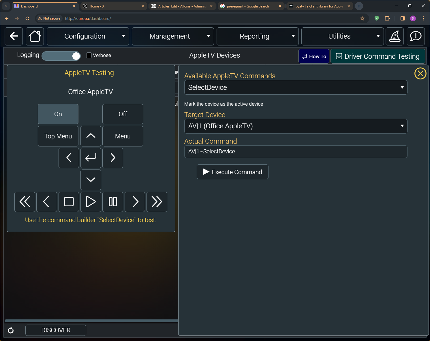

Next to test everything has worked properly once again open the Command Testing window and this time select the SelectDevice command. You can then try clicking on the buttons in the AppleTV testing widow. Click on the cursor keys to prove that you can navigate the AppleTV interface.
AppleTVPair 13
If you can navigate the display then you can successfully paired the AppleTV.
