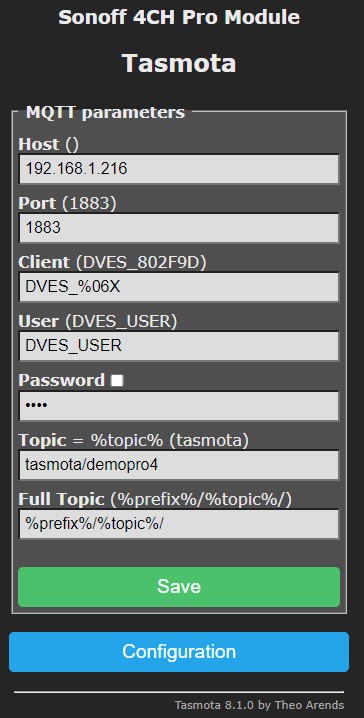

Click on Configuration button, then MQTT
Set the system up like:
Tasmota mqtt config 1
 name the device in the Topic ie: tasmota/name_of_your_device
Click Save.  Device will reboot.
The myServer Tasmota driver should auto discover the new device.  It will name the device as per your topic name (demopro4 in the above example).
