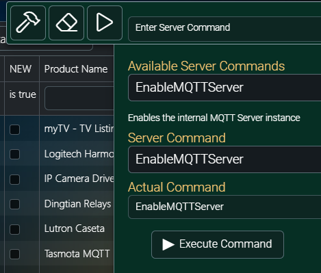

Enable MQTT server on myServer in Command Builder.  FYI: Default port is 1883
