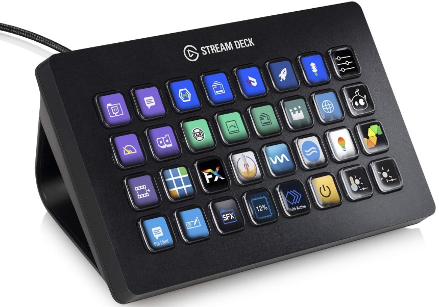

The Elgato Stream Deck is a many button user interface hardware that can trigger other software to do "stuff".
StreamDeckXL 1
With myServer's extensive library of device support, there has been interest in integrating the Stream Deck to trigger myServer macros.  Those macros can then command the vast library of device actions (like trigger a video wall scene, or go to a set volume position on a zone, or turn on the whole system, etc.)
 Easiest integration is to drag a "website" widget to the StreamDeck button (in StreamDeck configuration software).  Name it with your function.  Then, put "http://192.168.1.216/api/docommand?command=AV|294~Power~On" as an example command.  The IP in the example URL is the myServer controller's address.  Any command or macro can be executed.  Choose the "GET request in background" in StreamDeck app so that a web page doesn't launch on your StreamDeck USB connected PC.
So, you can do thousands of activities like:  Bar Open (launch a myServer Preset).  Or "Night time"  or "Outside Cameras" to have myServer display the cameras on the outside of your home / bar.  Or any other manufacturing task sequence, or Audio / Video actions, etc that myServer is controlling.  You can launch a myServer user interface on your PC with a touch of a StreamDeck button.
