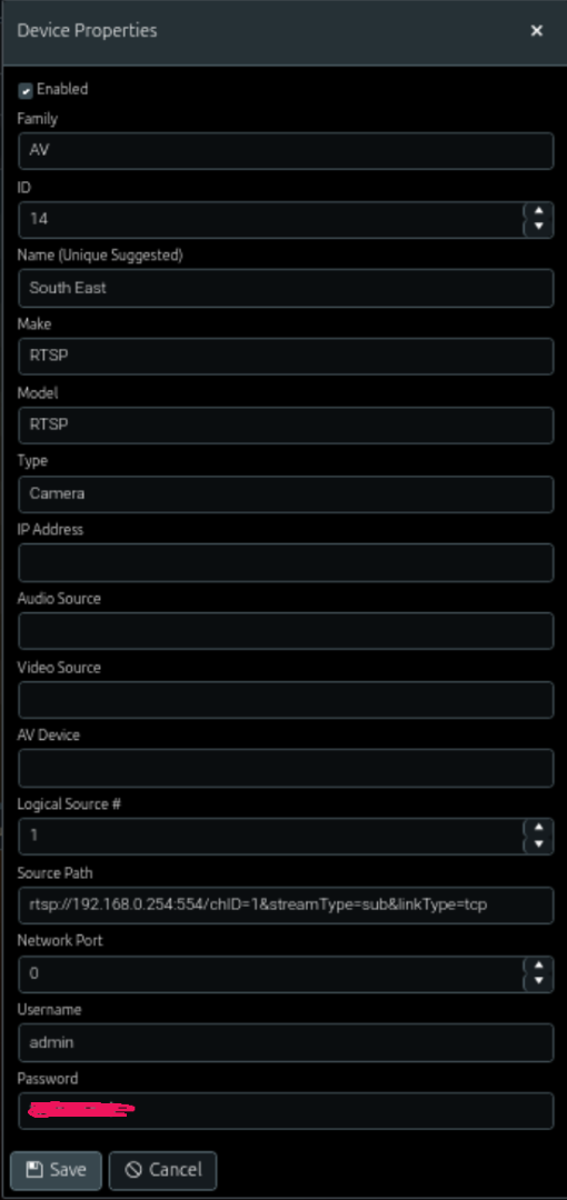

Absolutely, and have done. The issue is not getting mediamtx (the service) to run on the Pi. I think it is running (by adding the host, installing the service etc) - certainly the dashboard reports that the driver is up and running.
The issue is how to configure MediaMTX so I can point it to my RTSP streams. The dashboard interface doesn't seem to allow me to do it - I've wrangled with the MedaiMTX command builder (the most obvious one being 'AddRTSP camera', but seemingly no matter what I put in the fields, the preview never displays the feed.
I suppose in very simple terms my question is this - given I know the URL for each RTSP stream (in standard Hikvision format rtsp://username:password@IPADDRESSOFCCTVSERVER:554/Streaming/channels/101 (201/301/401 or 102/202/302/402 for the lower resolution sub-streams) )
What exactly do I do via the dashboard to point MediaMTX to them and get them working?
CrabbyPatties's Avatar Topic Author
  • Posts: 117
Re: IP Cameras - a struggle
2 years 2 weeks ago
#3329
These are the fields which are autocreated after running the 'AddRTSPCamera' command, save I have changed the Network Port from '0' to 554 (the correct port for RTSP).
It seems to me that most of the fields must be redundant - surely the only field that matters is the URL to the RTSP stream?

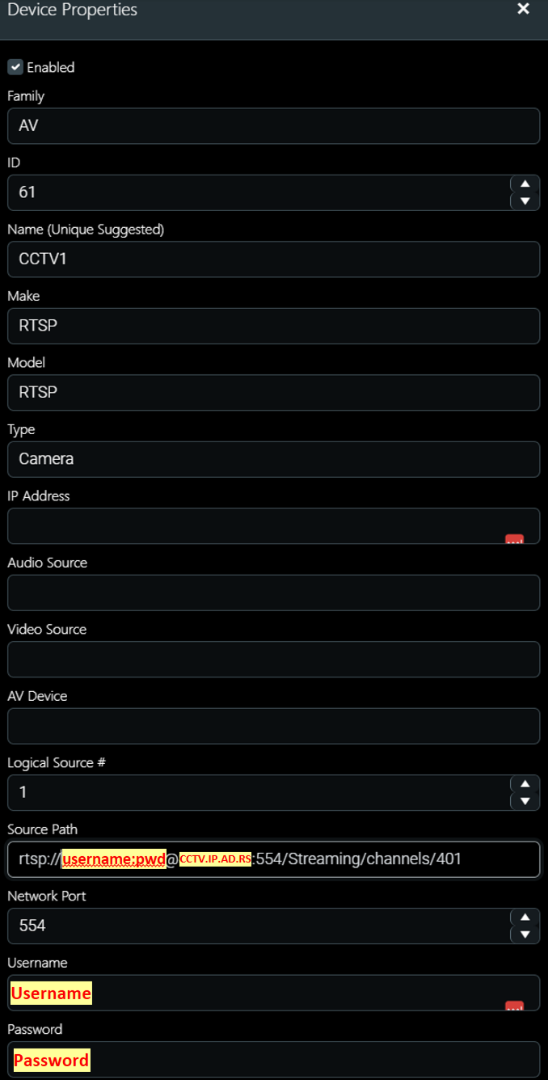

#3334
There are so many fields because the MediaMatrix driver is capable of digesting many forms of video sources and converting them to a webrtc stream that can be viewed on any browser. RTSP is probably the easiest to configure. Here is an example showing the required fields for an RTSP camera. You do not embed the username and password on the stream. Set them in the defined fields.
Then go to Device Previewing and make sure it works
