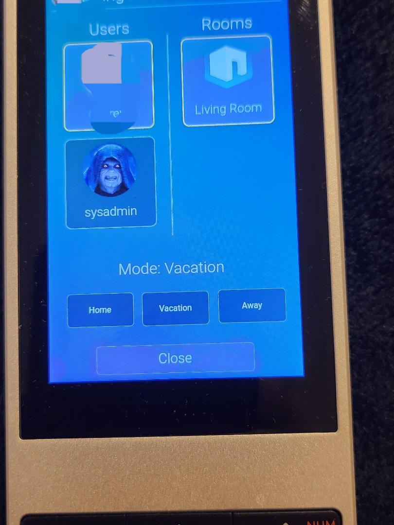

I've added a quick method of setting the system mode to the userroom overlay. Each button just runs SetHouseMode|Home etc on the server.
