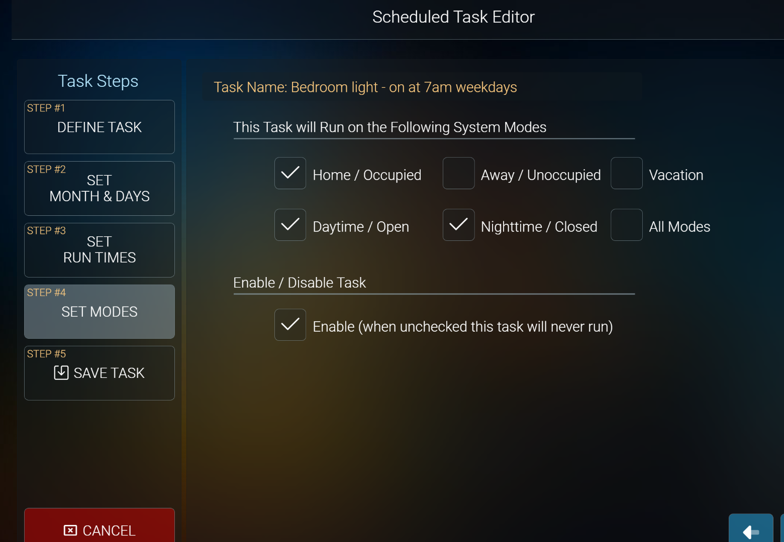

Well I finally tried this and it doesn't seem to work...
I have a scheduled task that turns on the bedroom light at 7am on weekdays and it's only supposed to happen if the system mode is Home, Daytime or Nighttime.
I put the system into 'Vacation' mode (so I thought) by setting the server variable 'housemode' to 'Vacation'. But the scheduled task still fires at 7am.
Scheduled task modes screen:

I think the variable you set is supposed to be 'server_housemode' not 'housemode'. And there appears to be a special command to set it too:
SetHouseMode|Vacation
We'll see tomorrow at 7am if this is it.

Yes that's got it this time:
27/12/2024 06:59:56.59 · DEBUG · AndroidTV.TX: FireTV - dumpsys activity activities | grep "mResumedActivity"
27/12/2024 06:59:56.59 · DEBUG · AndroidTV.RX - FireTV << mResumedActivity: ActivityRecord{b152fe7 u0 com.amazon.tv.launcher/.deeplink.acti
vity.DirectiveSearchResultsActivityDI t779}>>
27/12/2024 07:00:00.00 · DEBUG · Scheduler.Tasks - Skipping Task Bedroom light - on at 7am weekdays. Not in correct house mode.
27/12/2024 07:00:01.00 · DEBUG · Server.doCommand - AV|23~Test~@SYS:MODELNAME=? from
27/12/2024 07:00:01.00 · DEBUG · YamahaAVR.doCommand - Cmd=[23~Test~@SYS:MODELNAME=?] Client=[Internal]
27/12/2024 07:00:06.00 · DEBUG · AndroidTV.CheckAdb - Checking for ADB running
So if you want to use modes on scheduled tasks set the variable 'server_housemode'.
