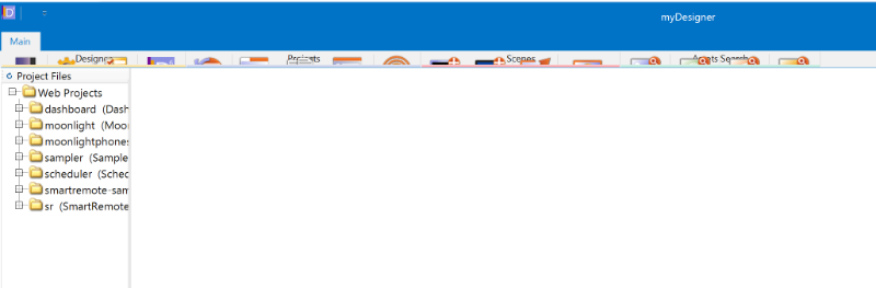

There is a display issue in Parallels Windows VM on a Mac. The icons at the top are cut off. Making the software unusable. I am unable to upload a picture, not sure if is due to being a newer user.

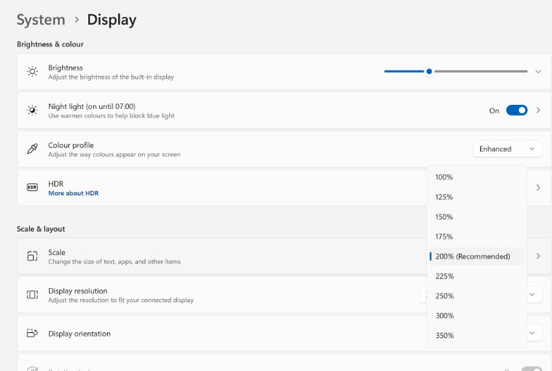

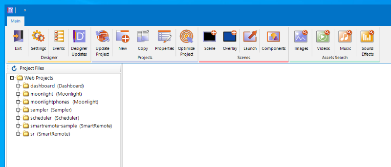

Does it look like this?
If so it might be you've got a high DPI screen and have scaling set. On my Surface Book it looks like this with display scaling set to 200%. If I change it to 100% it looks correct.

Thanks, that did end up working. When using Parallels you have to do it from the Parallels menu, not the Windows menu.

Yes, the resolution change is the fix.
