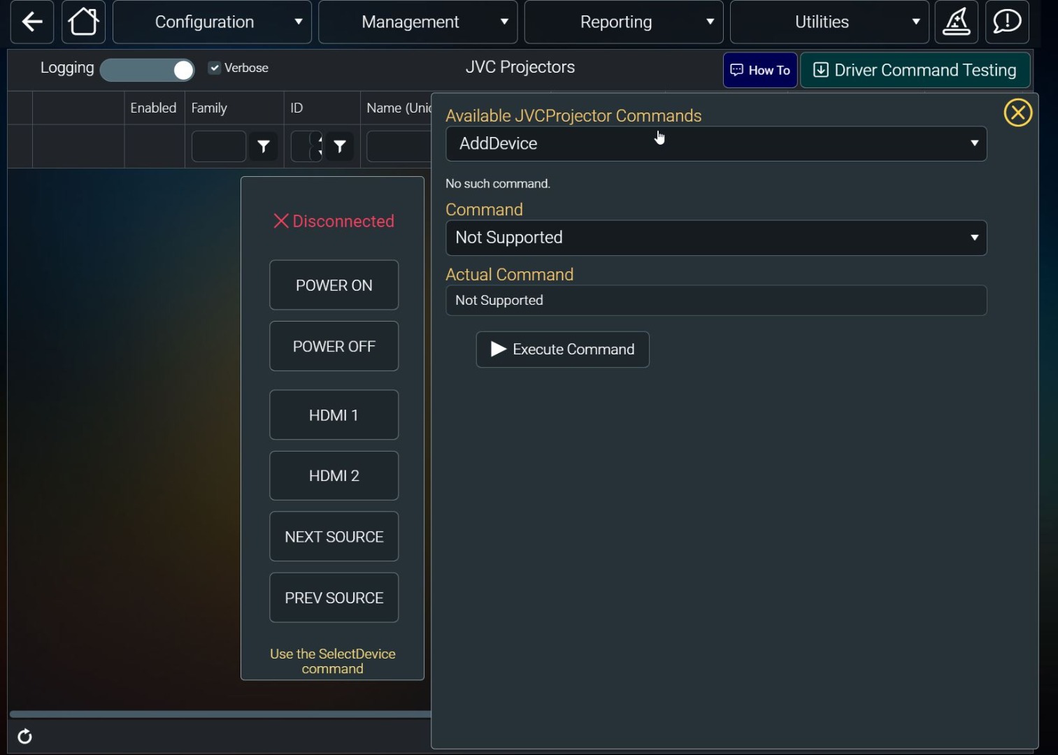

I was going to try out the new password option but it's not letting me add the device.  This is what I see:
Re: Cannot add device
#1288

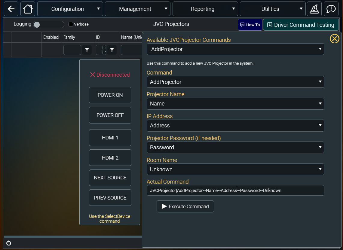

Ah sorry. i changed the command from adddevice to addprojector and messed up the command builder. I'll fix it in the morning.
#1298
Driver issue resolved.
