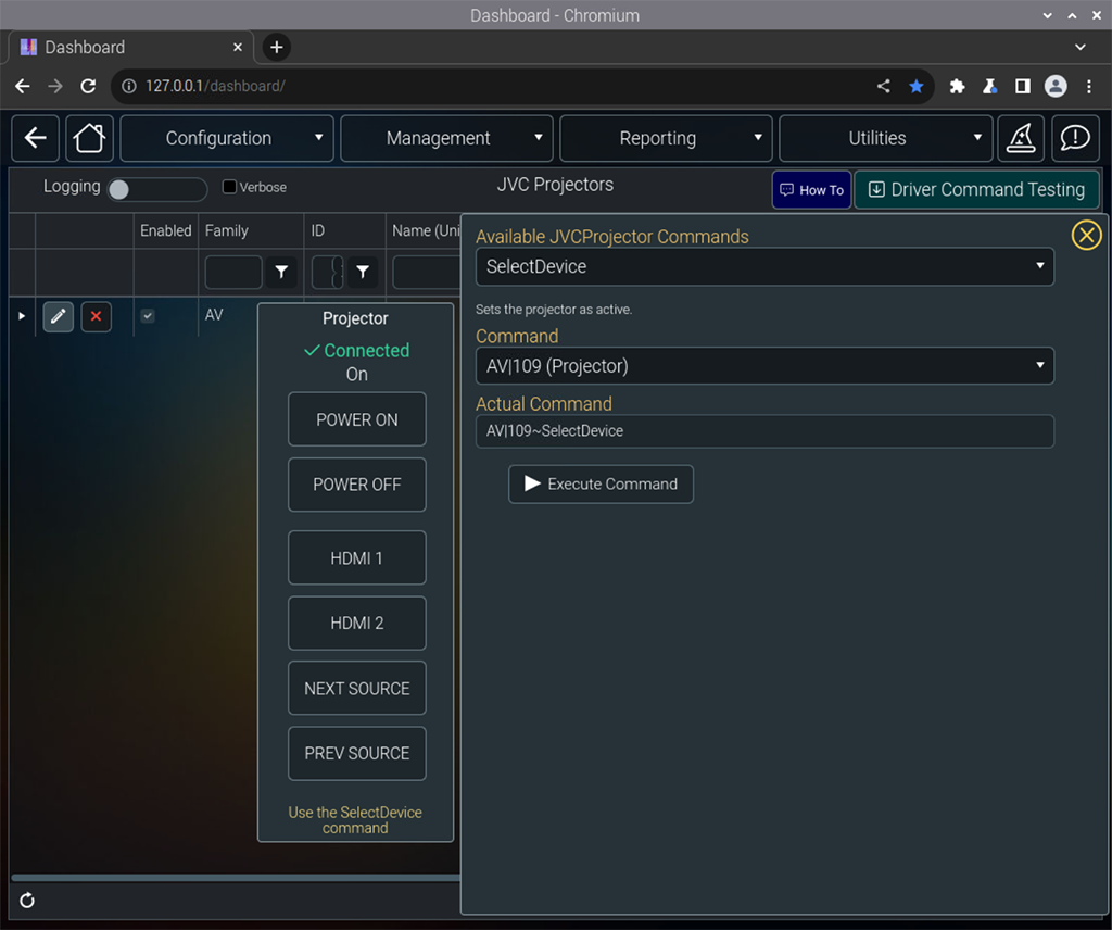

#1253
I was refining the driver to finish making changes.
The driver has been updated and it will now track power state. It will also support sending a password if the projector requires it. The AddProjector command now supports an optional password parameter. If you projector does not need a password leave it blank.
Finally the command builder overlay exposes a side panel so that you can directly test command and control of the projector.
