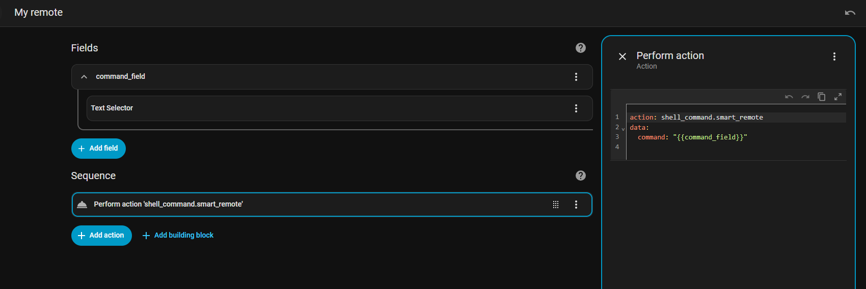

You should be able to put something like this into your configuration.yaml(make sure to restart HA after you put this in so it's available to select in the gui)
Code:
shell_command:   smart_remote: curl http://192.168.20.70/api/docommand?command={{ command }}
Then you could create a script that takes an input field(the command you want to run) and calls the shell_command.smart_remote action.  In the script you'll have to edit the action in yaml to pass the field to the shell_command.  Picture below of the script.
After that you should be able to call the script and enter the command you want in the field.  That shouldn't require anymore yaml.
