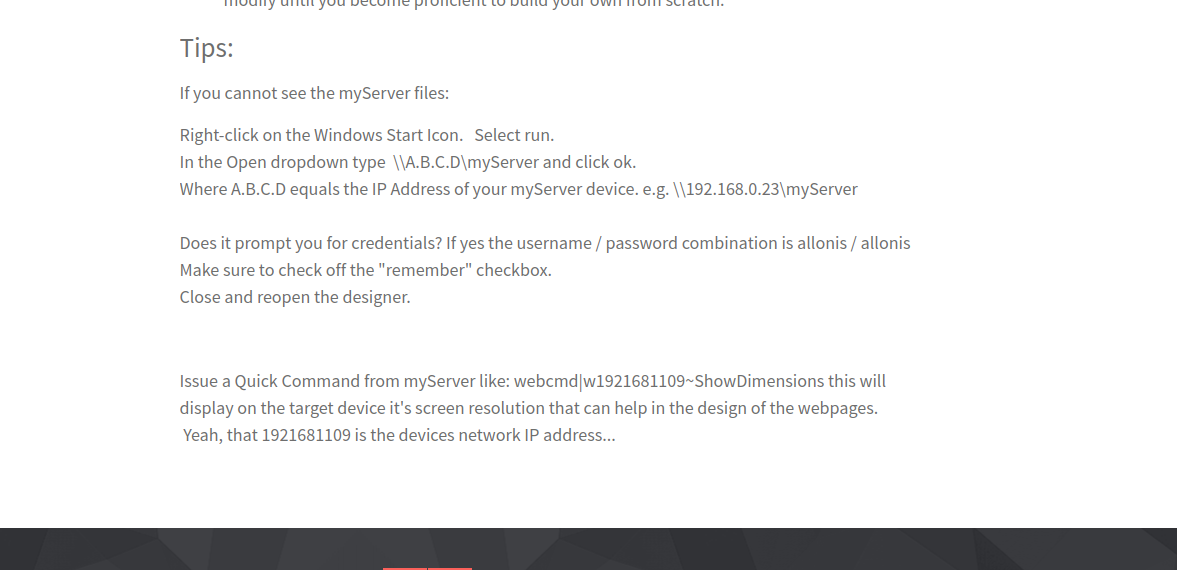

Ah, that was what I was remembering. It's in the docs isn't it? But I couldn't find it. Mind you it was 2am so I was a bit bleary-eyed by then. Anyway I'm afraid that has the same effect as typing the share into the File Explorer path bar - absolutely nothing happens (except the run dialog disappears in this case).
