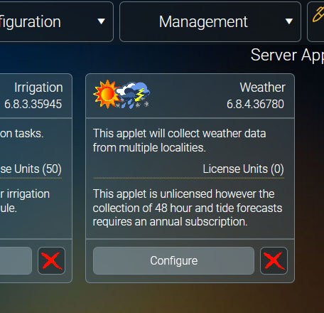

Thanks David.   " the Weather App was not loaded from Software Updater."   Did I download the wrong thing?   Attached is  a screenshot of what shows up under Management ==>  Applets.   It does seem to work now.   I don't live in Detroit, though.   I live in West Bloomfield.

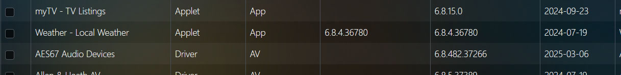

Checked this morning, still no new weather variables are loaded.   There appears to be some standard weather maps in there but nothing more.   Attached pic shows the app that is installed - 6.8.4.36780.
