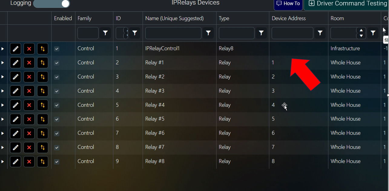

I tried IPRelays|AddController~IPRelayController1~192.68.10.25~30000~8~Infrastructure.
The resulting screen looks like the attached - blank device address.. I have tried manually configuring the address 192.168.10.25/30000 or 192.168.10.25:30000 or 192.168.10.25:80 or http://192.168.10.25:80. Can't find something that makes MyServer happy.
Thx
I did find this in the iMatic documentation."Note: the "Port" is not really a port number at all. It is just a custom URL path. So, the device is always on Port 80 and cannot be changed if you need to Port Forward your firewall for some reason.
Thx

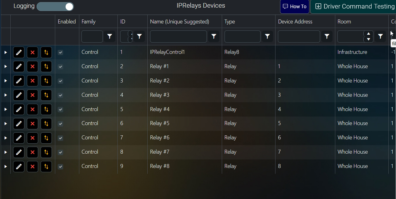

Still can't figure this out. Response to my previous message would be appreciated. I also tried the iMatic driver with similar results. Thx.
