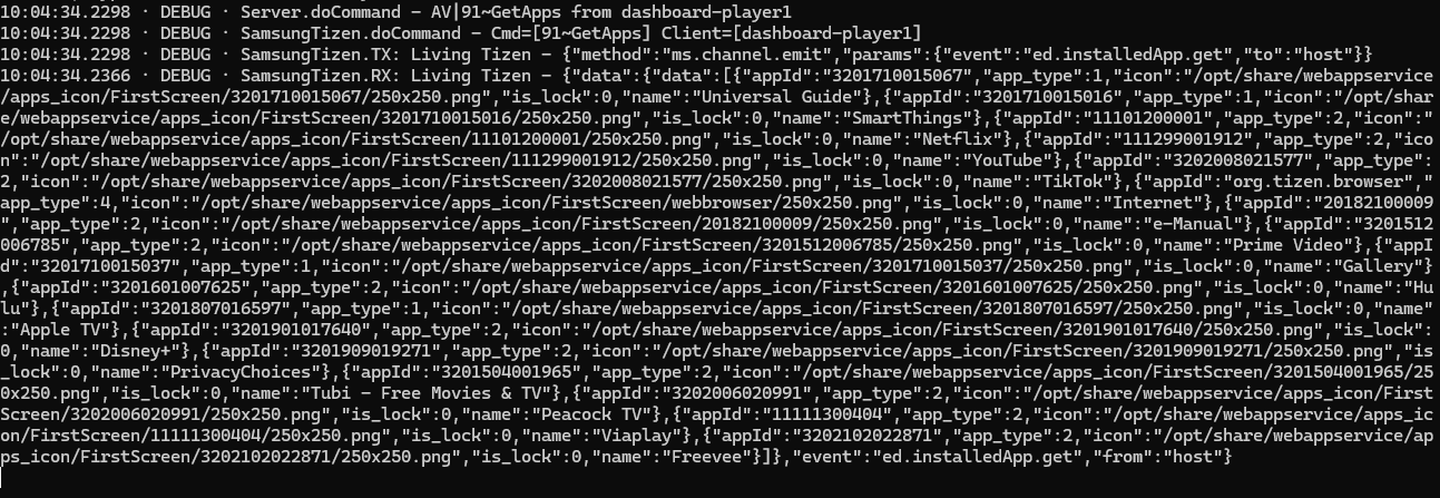

Make one more test for me. Update to the driver I just released. I've added a bit more logging. Then run the same GetApps with verbose logging turned on. I'm expecting to see something like the following. TX and RX messages or error messages saying why it could not do it.

Hi Dave, I just did that. Here's the logging output:
23/05/2024 13:34:02.34 · DEBUG · Server.doCommand - AV|56~GetApps from dashboard-fx-if06
23/05/2024 13:34:02.34 · DEBUG · SamsungTizen.doCommand - Cmd=[56~GetApps] Client=[dashboard-fx-if06]
23/05/2024 13:34:02.34 · DEBUG · SamsungTizen.Socket - SSLValidationCallback SamsungFrameTizen
23/05/2024 13:34:02.34 · DEBUG · SamsungTizen.Network - TV SamsungFrameTizen connected
23/05/2024 13:34:02.34 · DEBUG · SamsungTizen.TX: SamsungFrameTizen - {"method":"ms.channel.emit","params":{"event":"ed.installedApp.get","to":"host"}}
23/05/2024 13:34:02.34 · DEBUG · SamsungTizen.RX: SamsungFrameTizen - {"data":{"message":"No Authorized"},"event":"ms.error"}
Interesting that it's throwing an auth error here, as I mentioned earlier, I'm able to use Tizen to control the TV in other ways (power on/off, mute, etc)
