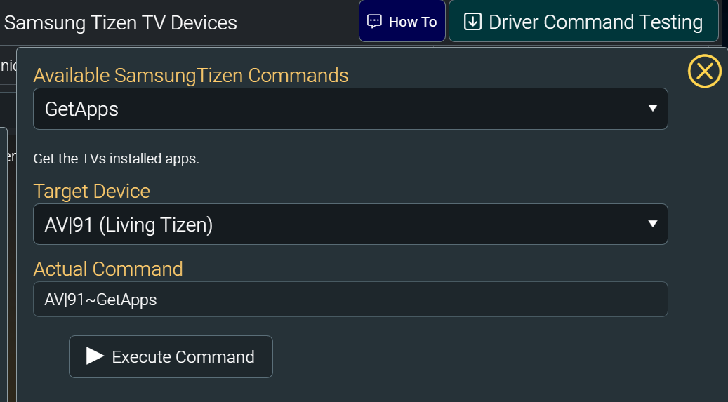

Install the latest Tizen driver. The GetApps command was previously hidden. Now it is exposed in command builder.
Turn on verbose logging in the Tizen driver.
Make sure the TV is on.
From Tizen command builder run the GetApps command on the TV.

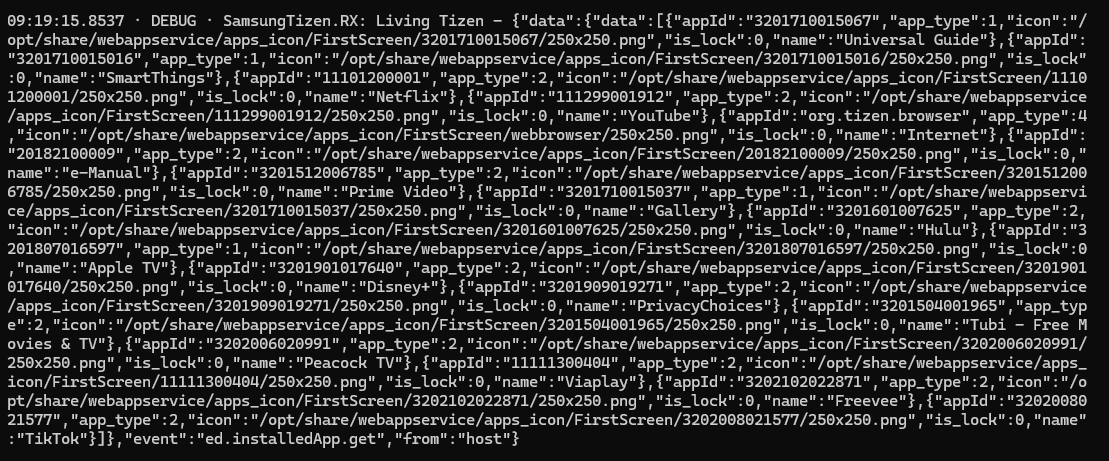

The server event log should show a large json response.

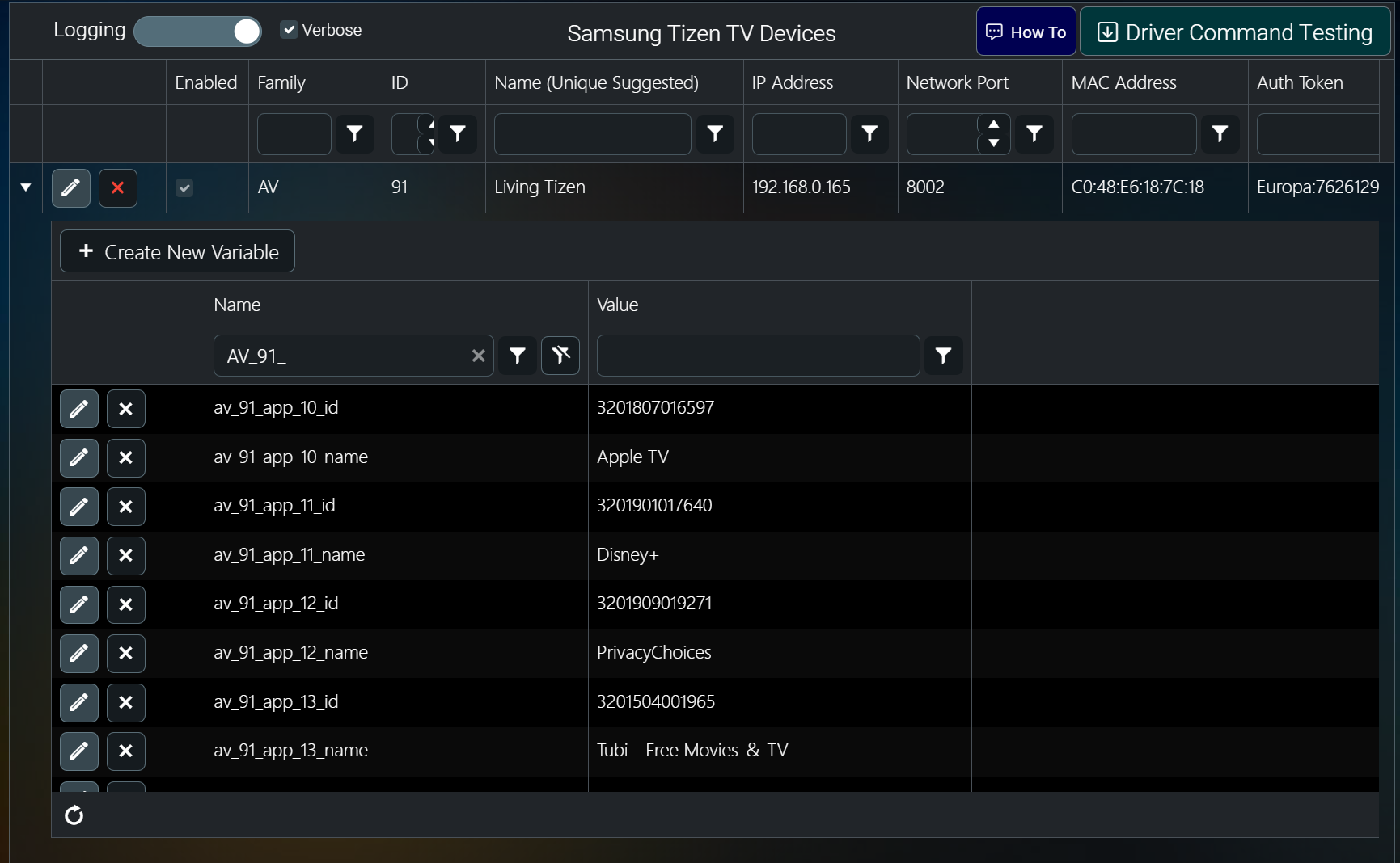

Then refresh the device grid in the dashboard and expand the selected TV to see it's server variables. You should now see a series of variables that describes each of the apps on the TV. To launch an app you would use the Launch command specifying the app id.
