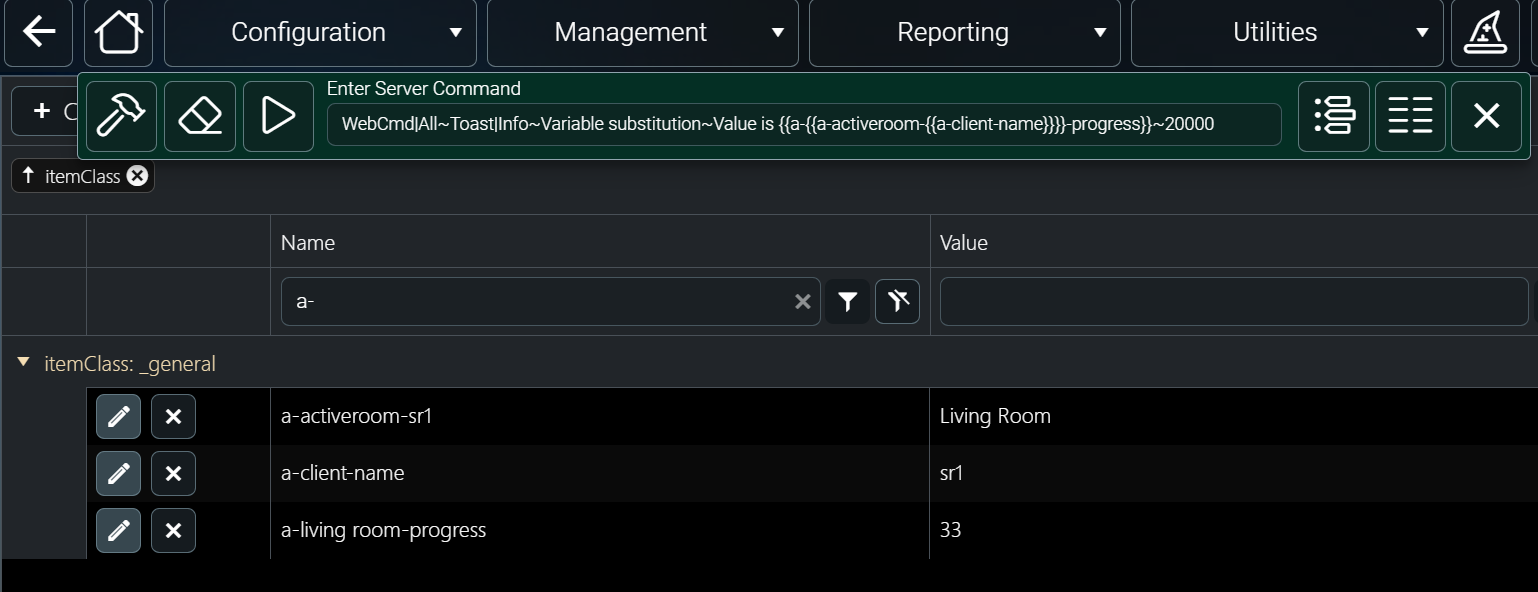

I've mocked up something to illustrate what I was imagining. I'm a rubbish graphic designer but you get the idea. Custom scene and driving macro attached.

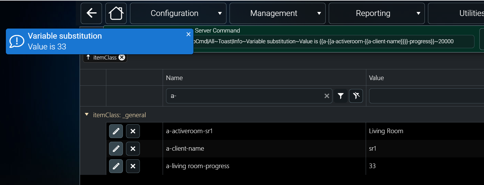

I've just tested this sort of thing with a set of made up variables using Toast in the dashboard and it looks like it works in that environment at least.
Replied by andrew on topic Progress bar not updated during macro
Obviously I don't know because I can't see your macros and variables but I would expect if things were working properly that {{{{activeroom_{{clientname}}}}_poweron_progress}} would resolve to something like {{{{activeroom_smartremote1}}_poweron_progress}} which would resolve to {{theater_poweron_progress}} which should work. So I'd be looking at the values of the activeroom_smartremote1 variable (or whatever your client name is) over time, before and after you run the SetActiveRoom command. Maybe you've already done this as you're obviously technically inclined.David - Any thoughts on why calling the "SetActiveRoom" command would cause the progress bar problems with the {{activeroom_{{clientname}}}} substitution?
