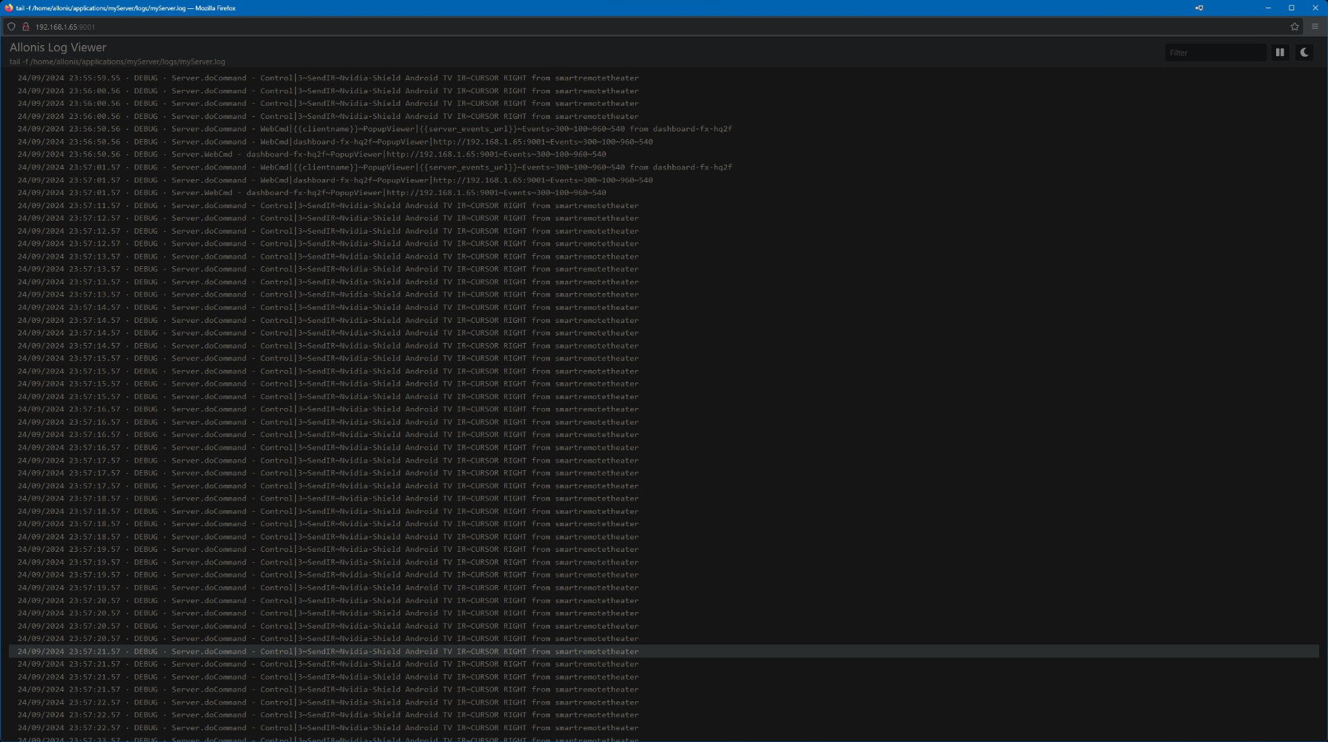

So if I was to press the right dpad button (this one has worn out first on both remotes because it tends to get used the most) my current command is:
Control|3~SendIR~Nvidia-Shield Android TV IR~CURSOR RIGHT
If I switch to ADB I use:
AV|{{active_shieldtv_{{clientname}}}}~Remote~Right
The results are the same with both. If I longpress the dpad right button it starts scrolling right, as expected. When I let go of the button it keeps scrolling right. How long it keeps scrolling for depends on how long I have held the button for. If I've held the button for 5 seconds the server will keep issuing commands for maybe another 6 or 7 seconds. If I've held the button for 10 seconds it might keep issuing commands for an additional 20 or so. This interval keeps getting longer as you hold the button for longer durations. It's also uninterruptable by pressing another button on the remote. I have to let the system finish processing all of the commands that have queued up first before I can do anything else. This can be literally dozens of additional commands after releasing the button, dramatically overshooting the intended onscreen target.
There is nothing amiss in the logs at all. It just keeps issuing the same command repeatedly until it's finished doing it's thing.
The highlighted line in this screenshot is where I released the button after 10 seconds. If you could scroll down the page you would see that there is an additional page and a half of dpad right commands being issued after the button release.
To eliminate the possibility of this being due to changes I've made to the system I've set up a second pi4 myServer for testing purposes. This is bone stock, as in I haven't made a single change to anything in myServer or myDesigner other than to apply the latest driver and Linux updates. I've also updated the remote used with this server to the new apk. The only device that it is connected to is yet another Nvidia Shield bought for testing purposes, which is also bone stock out of the box. This is connected strictly via ADB. The longpress behavior is exactly the same as on my primary server.
