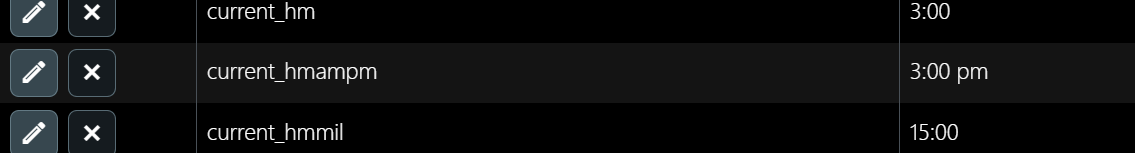

Not sure what the problem is here, but could you use a different server variable while you're trying to get to the bottom of this? {{current_time}} should get you to the same time format as {current_hmampm}}.

current_time bought back the same value. It appears that my current date and time values (on the server) are stuck at 11:59pm and the date is 01/18/2025 23:59:59
