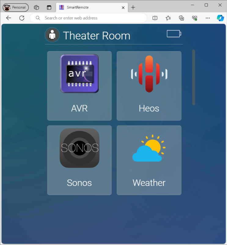

The Pi has always had heatsinks on all 3 compute chips, including yesterday.
Attached is a screenshot from my webbrowser for demonstration, but it's basically what the remote is showing (remote displays properly the battery, etc).
Selecting any of the four icons (AVR, Heos, Sonos, Weather) does nothing.

Ok, good. What is the temp of the CPU that is displayed in the myServer Dashboard? Should be 50C or lower. 70C is way too high and is where the RaspberryOS / firmware starts to drop CPU performance to self protect. You typically need heat sinks AND a fan to keep temps down. Also, are you still seeing the "Low Power" message on the top right of the Raspberry OS dashboard? If so, then there is a power supply problem still. These aren't a myServer / Allonis issue, it's standard Raspberry Pi requirements.The Pi has always had heatsinks on all 3 compute chips, including yesterday.
