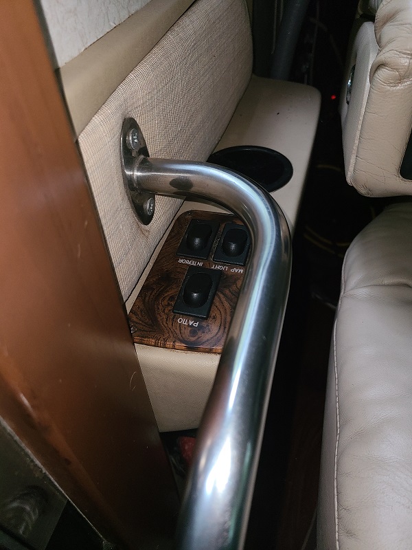

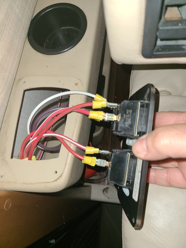

This is the original switch layout. For overhead lights, Map lights, Patio.

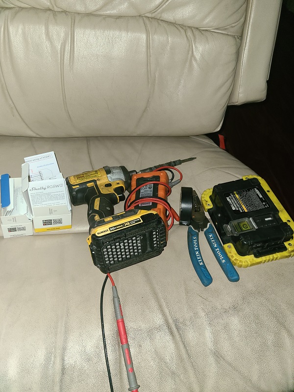

Typical wiring tools needed. Important is a multimeter.
Here is the original wiring. Each Switch is fed Power. Then the Load (the lights) are on the other side of the switch. There is no Ground cable here.
Check with the multimeter which switch connector has constant power. Check for power with the light switch off.

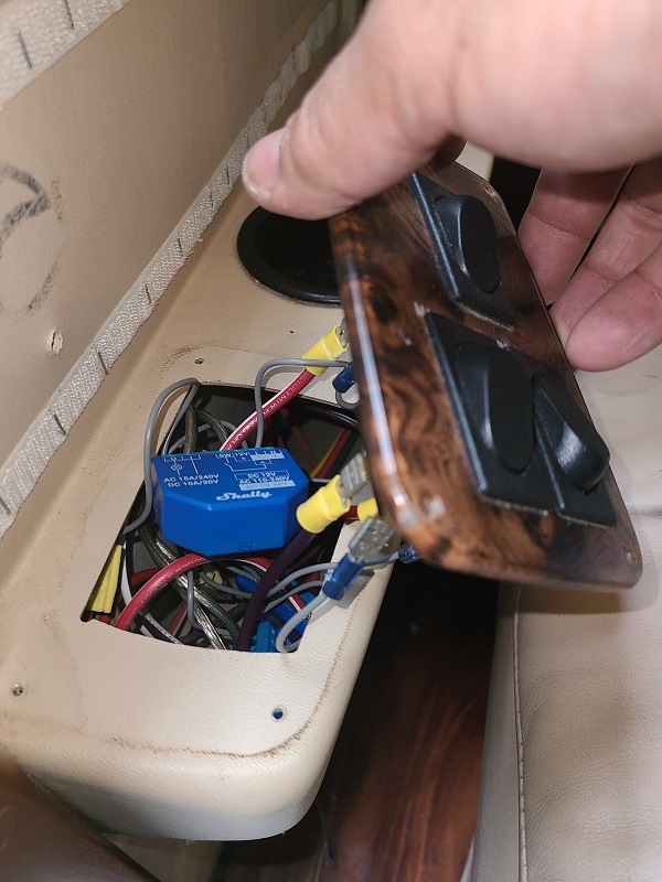

Splice in the new Shelly relay.

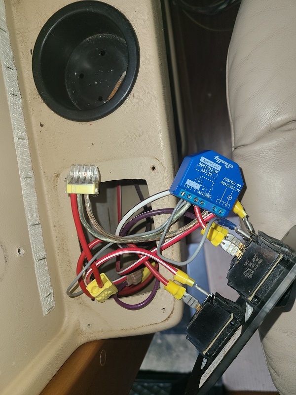

The old power wire goes to a Wago 3 or 4 position connector. Then run a shorter 12 gauge wire to the Shelly 12V+
I added a new ground wire that is connected to the window frame screw above the switch assy. This can be a smaller gauge wire as no large current will flow to it.

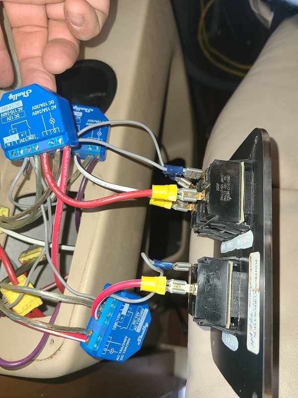

Wire the old switch to the Shelly Switch connection. Run the Ground to the other side of the switch
Run the large positive wire from the Wago connector to the Input of the relay
Run the large Load wire to the Output of the relay.
Repeat with the other two relays
