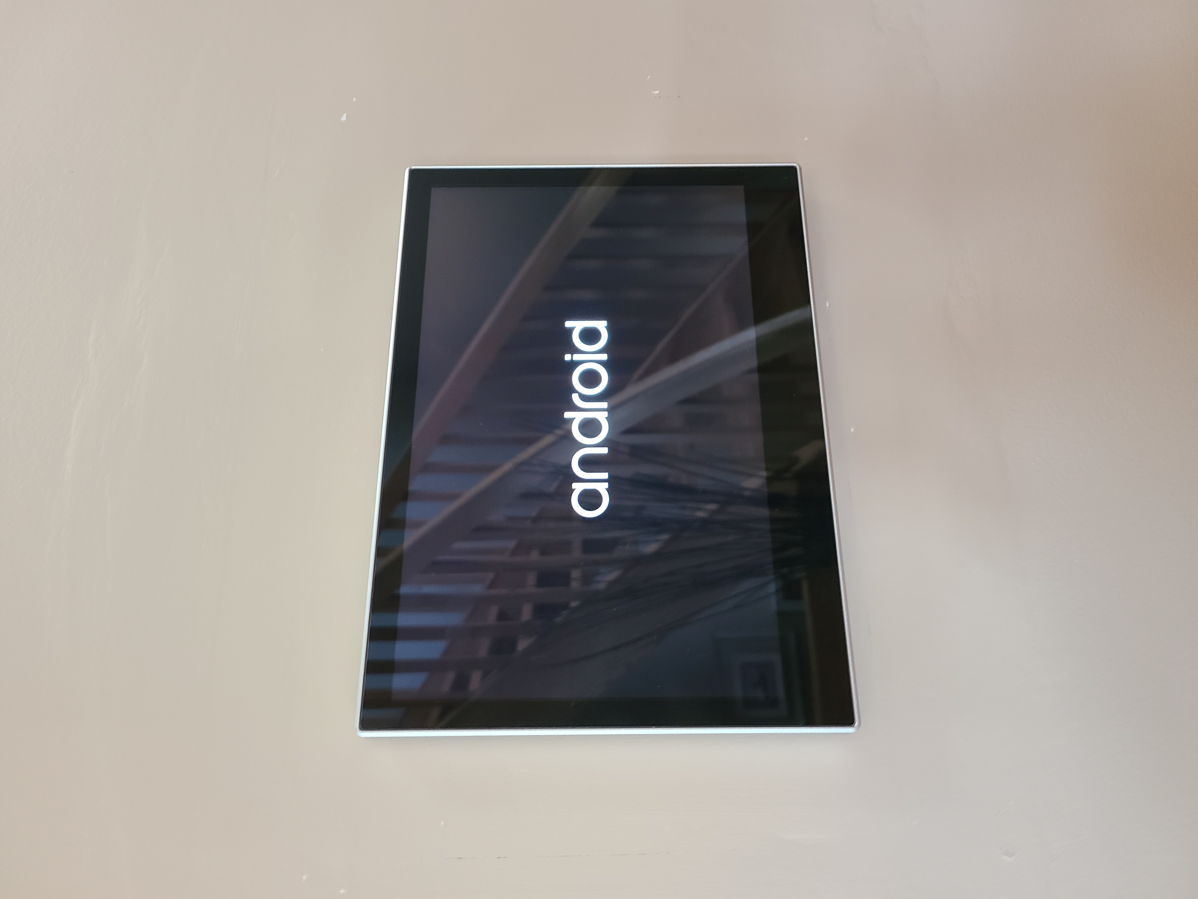

You will see the Android logo followed by the Android Desktop. Click on Settings and configure your network (either Wifi or Ethernet (recommended)).

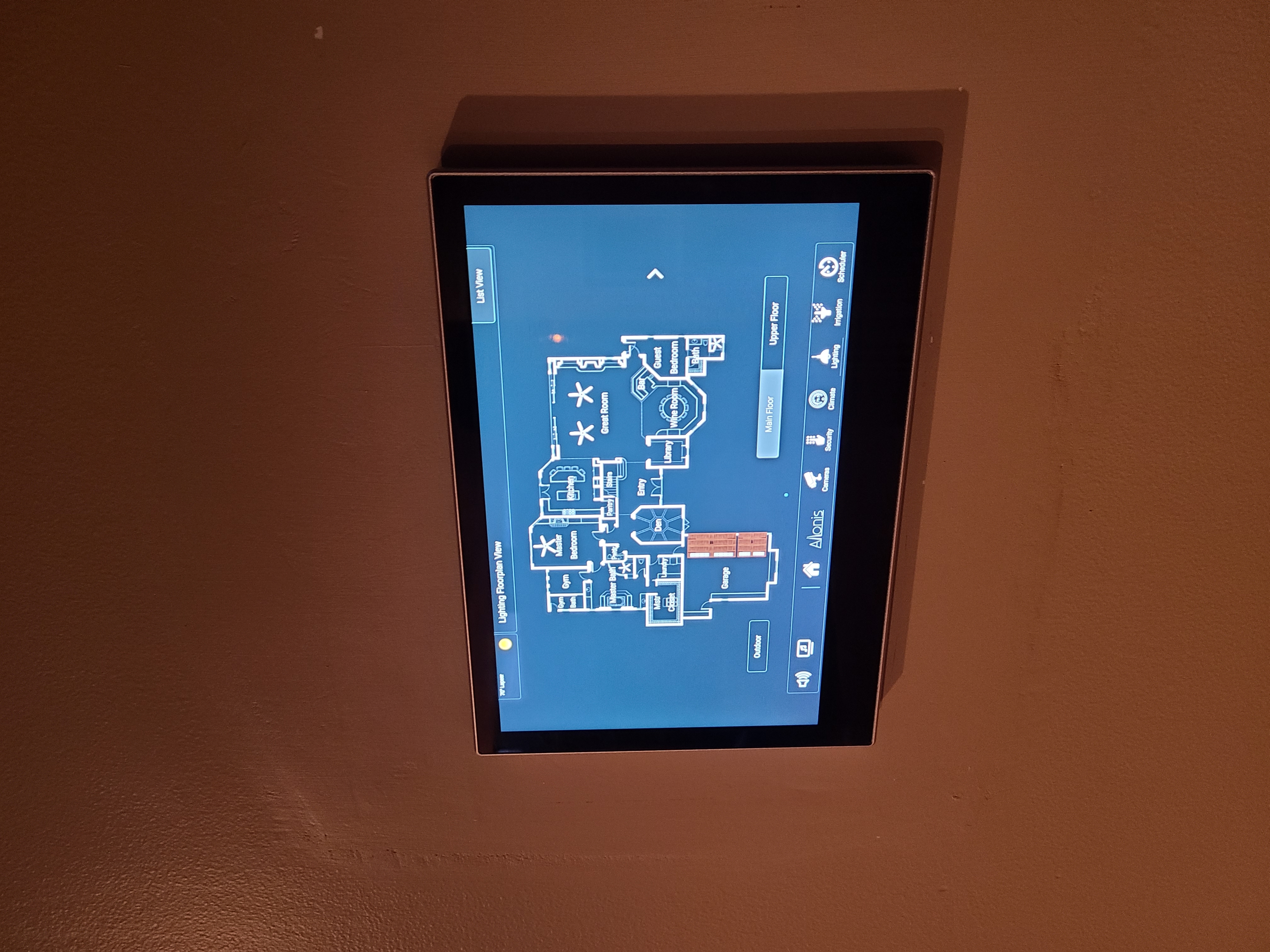

Wall Installation Example

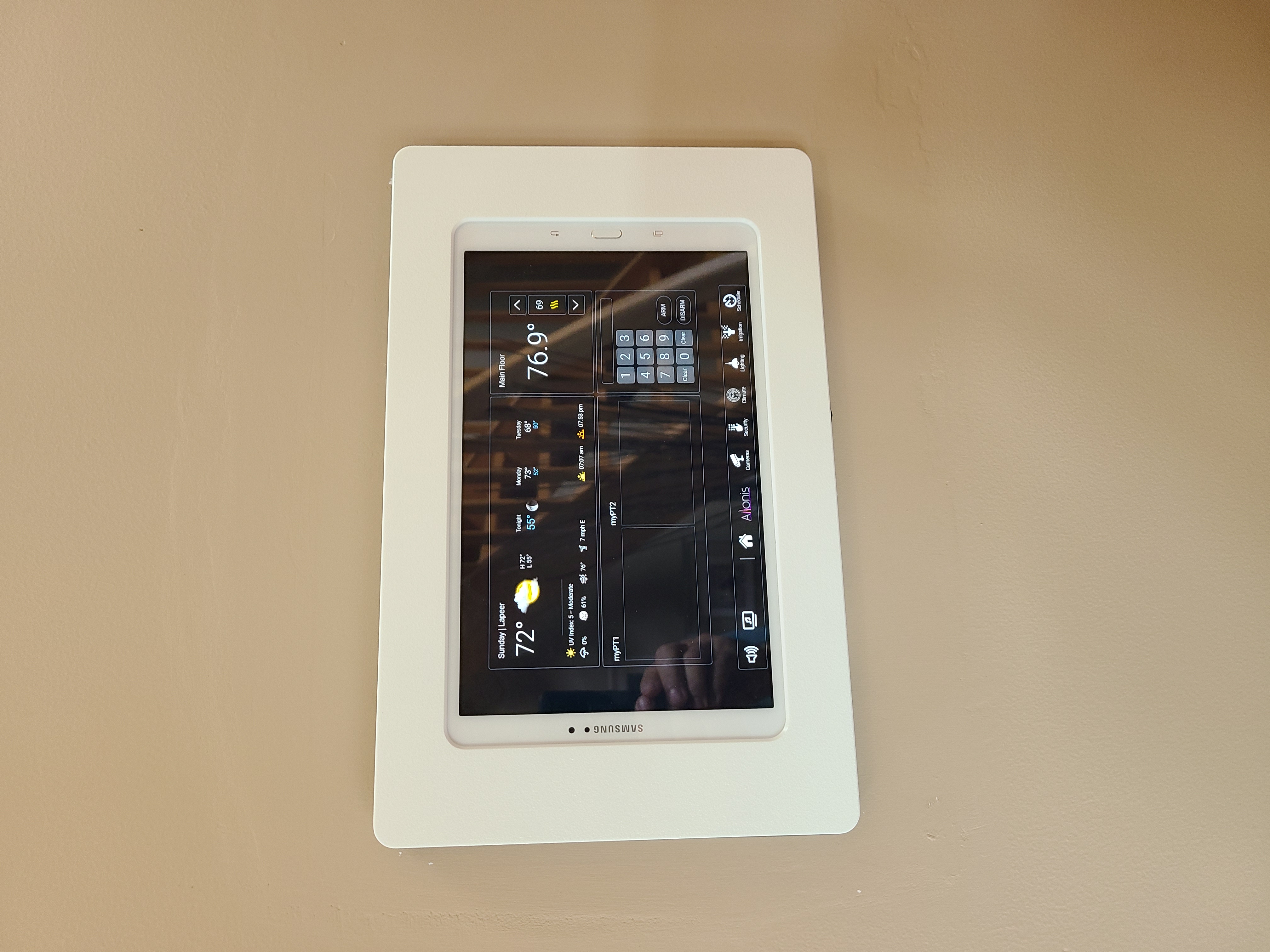

We had an old Galaxy Tablet in a surface mount. It was getting a bit slow so we wanted to upgrade to the Allonis SmartScreen 10.
Here is how we did it.
Picture of the old Galaxy

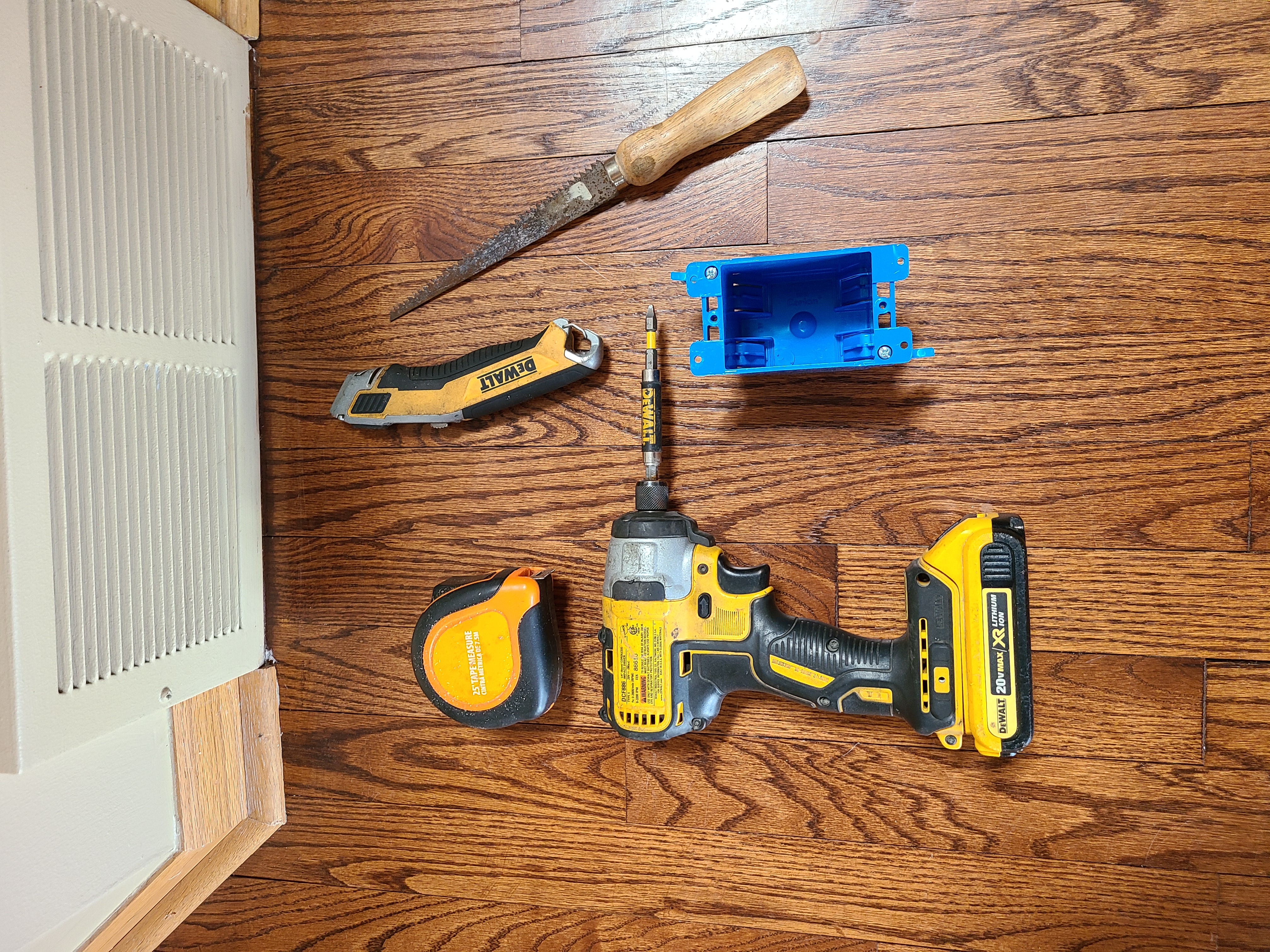

Tools Used

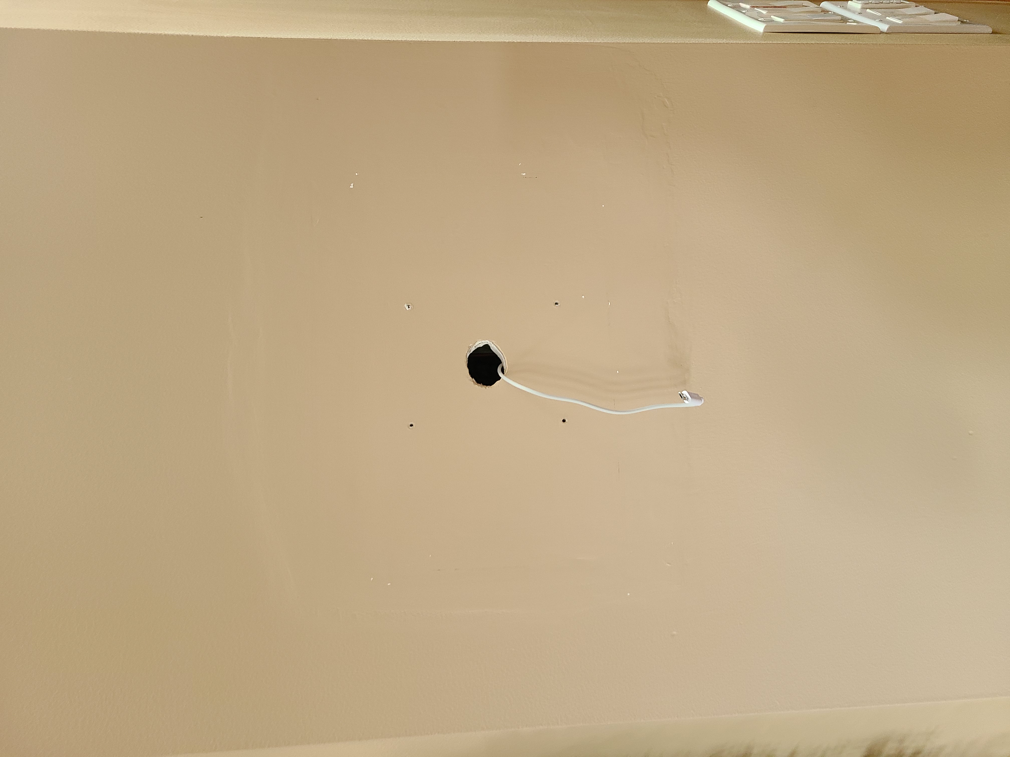

Tablet Removed
Ready to Install New Mount

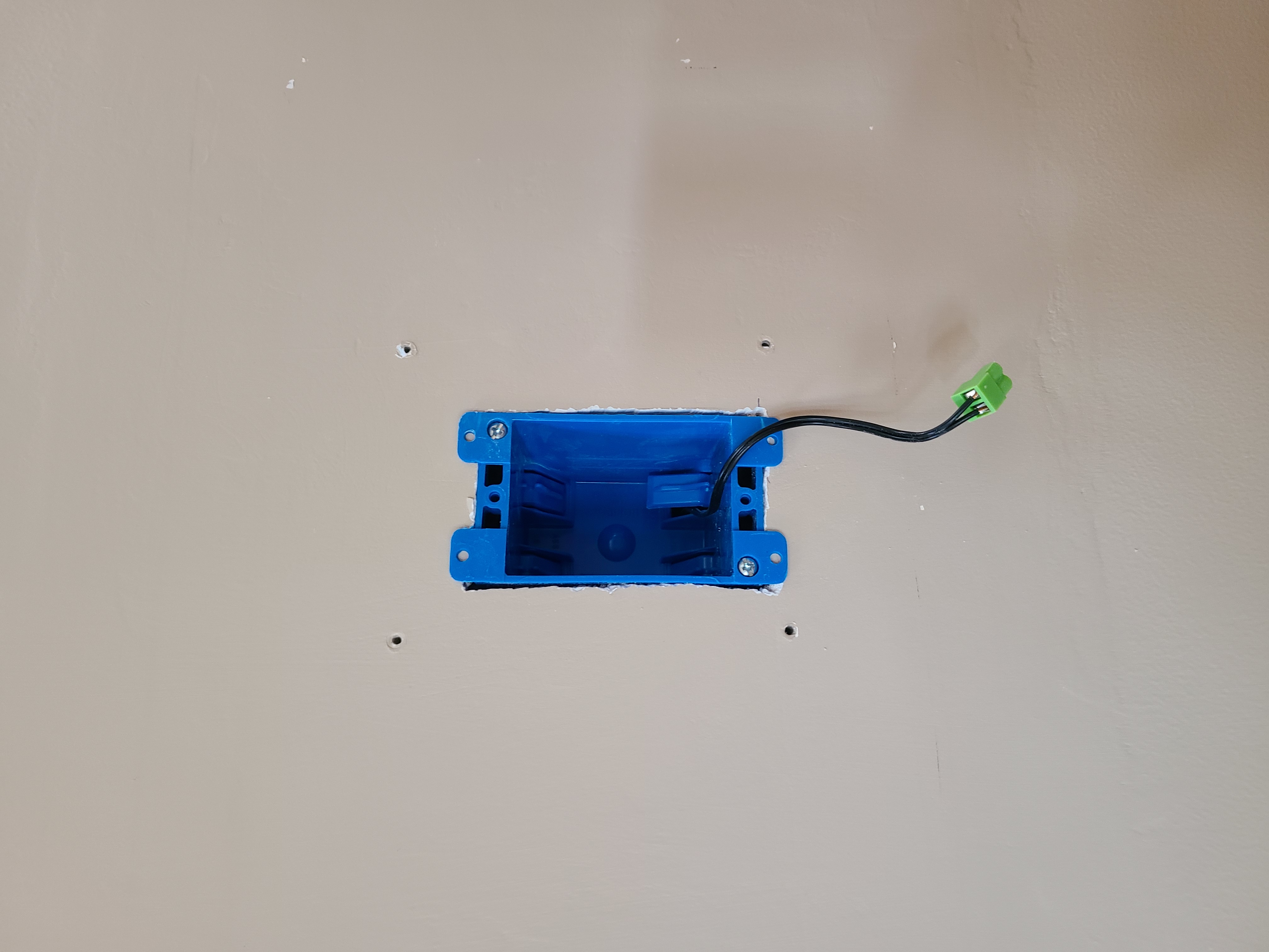

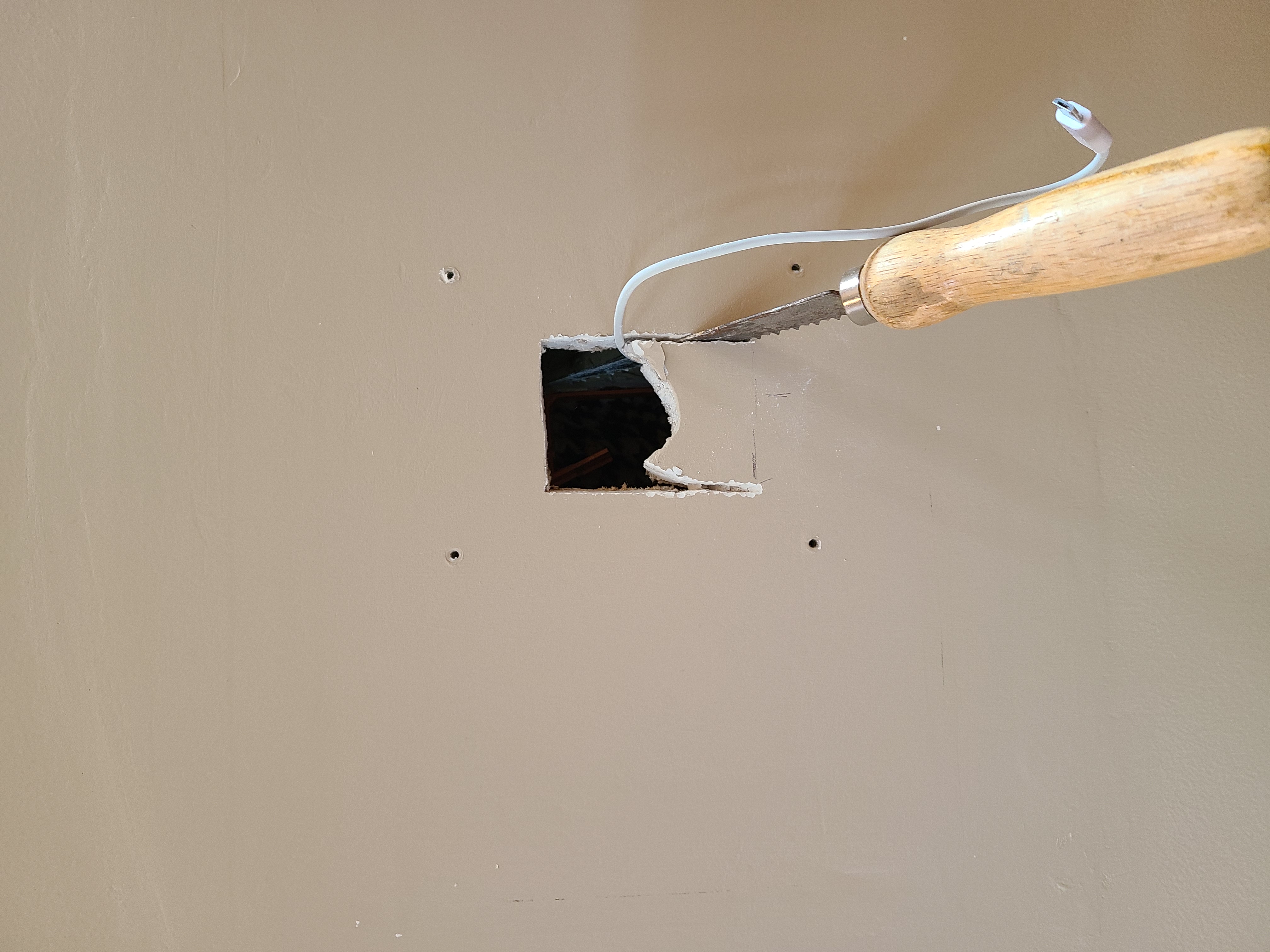

Put "New Work" electrical box against wall in the center location you want the screen, and mark where to cut the hole
Make your cuts with a Drywall Saw

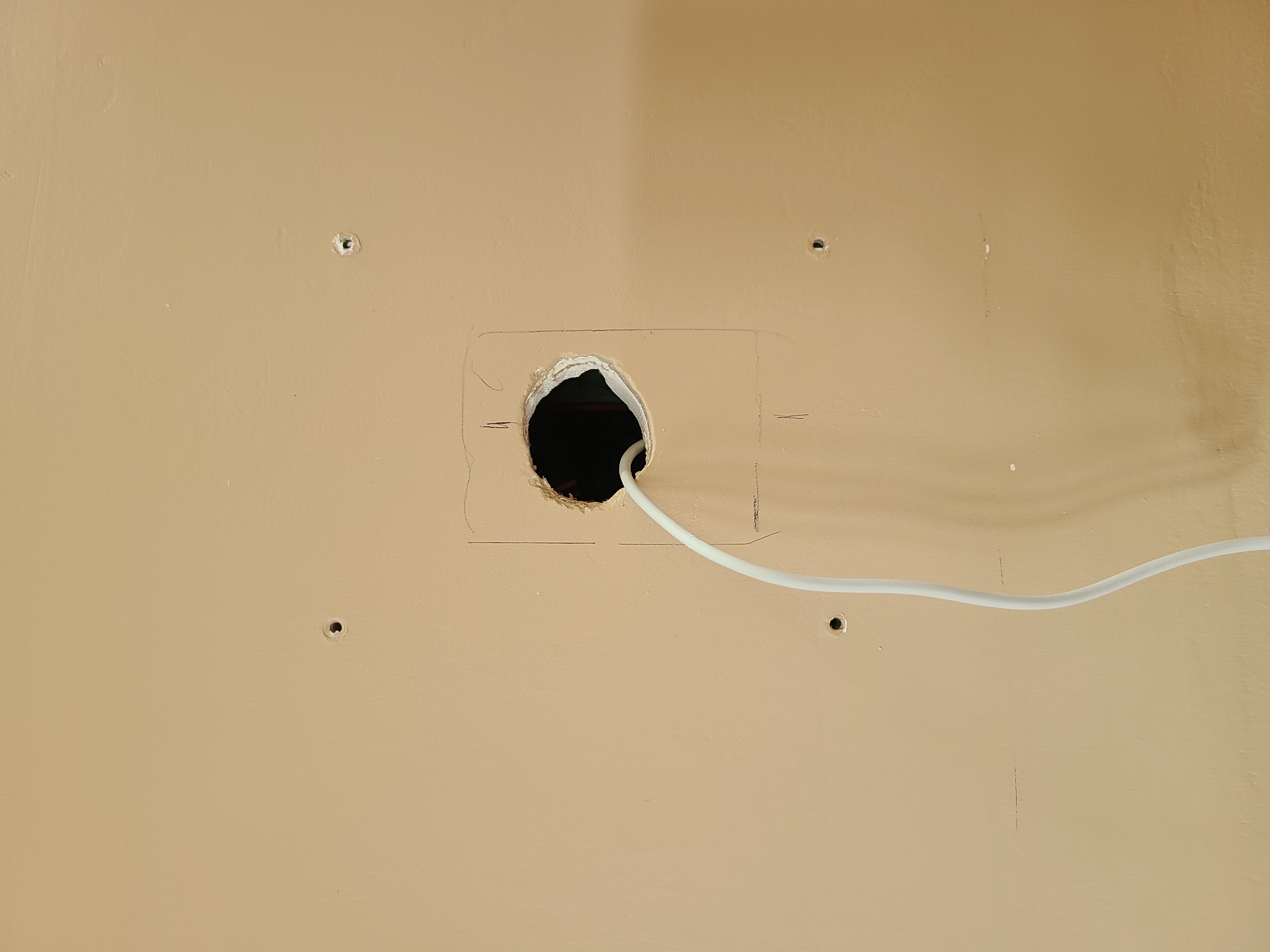

Install your new wire (we will be using 12 Volts from a wall power supply on the opposite wall. Best is to use a POE ethernet cable to both power and supply data).

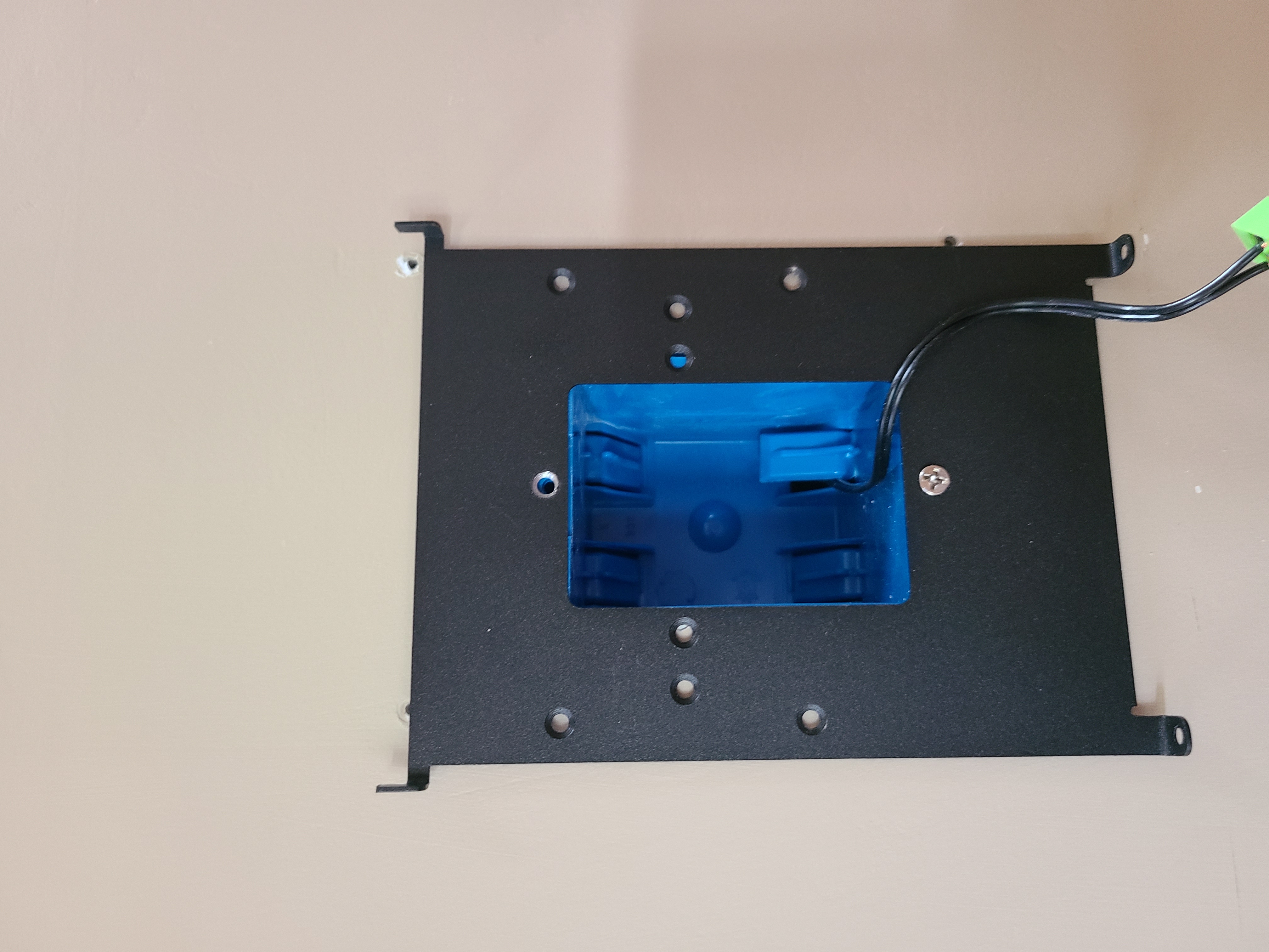

Install the "New Work" box into the hole. Tighten the wing screws to draw it tightly to the drywall and hold it in place.

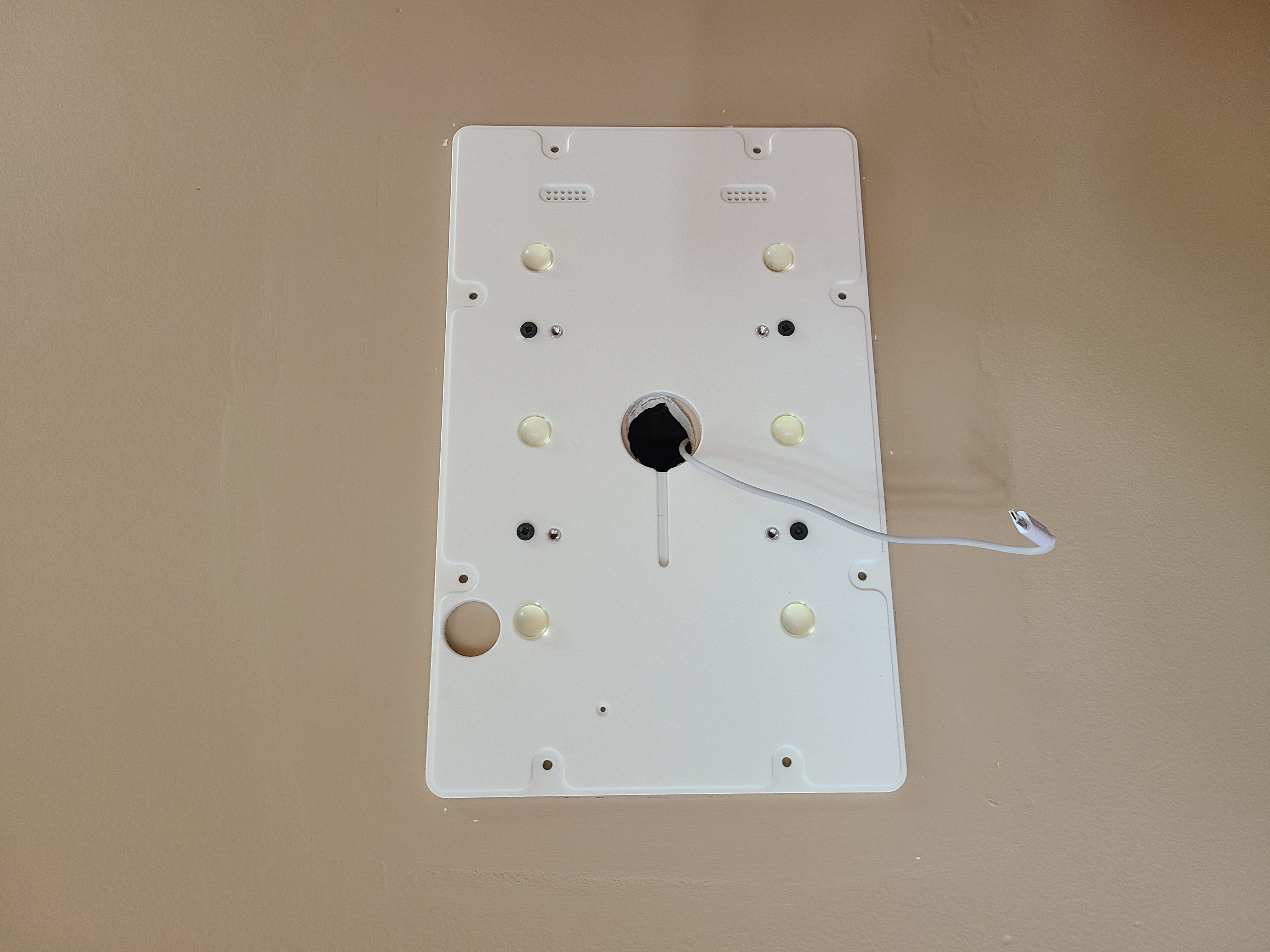

Install the two screws to hold the Mount to the New Work box. Note: we drilled two new holes to position it Landscape. Future mounts will include these drilled holed.
Plug in the power wire.
Insert the top wings into the slots in the back of the touchscreen, swing it down so the bottom tabs grab the outside of the screen and secure with the two tiny phillips head screws to affix it to the mount.
Plug in the power and let it boot.
Once booted, we configured the Wifi Network (since no ethernet cable was available).
Total installation time: 30 minutes for our example and circumstance.
