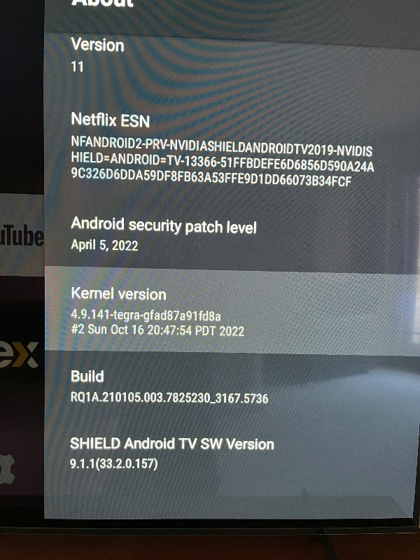

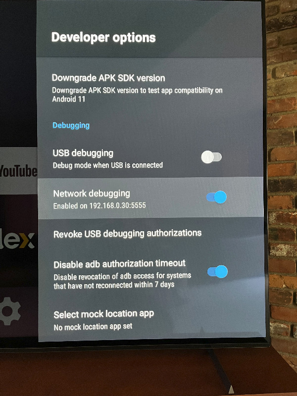

Screenshots showing versions and ADB settings are attached.

Replied by David Li on topic NVIDIA Shield Pro 2019
The Shield should show a prompt to choose to allow myServer connection. This has not been apparently not been approved yet.
AndroidTV driver will flush the ADB connection and the driver will auto attempt to connect again. You should then see the prompt again on the TV connected to the Shield to approve with the Shield's handheld remote control.
If you are using a non standard implementation re: a VM / Proxmox etc. Does your installation have the priviliges to do this? Is ADB installed in the VM? This is why this is not supported by Allonis....
