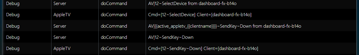

Thanks Dave.  Typo in my message, damn fingers.  I transposed it.  I have not figured a way to copy paste from the dashboard. The command being generated by the driver check is correct.
AV|12~SendKey~Down
Here is the actual screenshot.
I'll email you the teamviewer ID.  Thanks!
