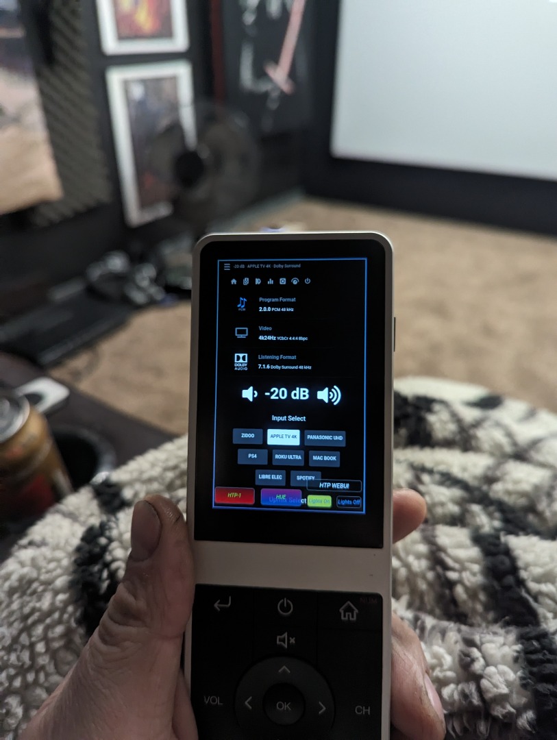

Still no dice on the power commands. Below is the ouput of the log. It is definitely communicating with the htp through the command, just not giving the desired result.
23/05/2024 20:22:29.22 · DEBUG · MonoHTP1.TX: - http://192.168.50.197/ircmd?code=02fd
23/05/2024 20:22:29.22 · DEBUG · MonoHTP1.RX: - {"volume":-28,"status":{"raw":{"streamType":0,"inputSampleRateEnum":0,"inputSampleRate":-1,"outputSampleRateEnum":0,"outputSampleRate":-1,"activity":0,"decProgramFormat":0,"encListeningFormat":0,"delayms":-6,"streamInfoBytes":[0,0,0,0,0]},"DECSourceProgram":"none"},"cal":{"lipsync":0,"vpl":-50,"vph":-8,"ampsense":4,"diracactive":"on","currentdiracslot":1,"caltoolconnected":false},"unitname":"Fatty's HTP","bassenhance":"off","eq":{"tc":false,"treble":{"level":0,"freq":5000},"bass":{"level":0,"freq":120}},"upmix":"native","fastStart":"on","fastStartPassThrough":"off","night":"off","loudness":"off","dialogEnh":0,"input":"h1","muted":false,"hw":{"fpBright":7},"stat":{"TVSoundSrc":"NONE","TVSoundSrcDefault":"none","earcLinkStatus":"UNK, mode:EARC","CECStatus":" Enable:Off, LastReq:, SysAud:0, Map:0x0000","displayVideoStat":true,"displayAudioStat":true,"displayAdvancedSettings":true,"newupdate":"noupdate","gitbranch":"master","devrespavail":false,"enableSupportTools":false,"systemAudio":true,"updateprogmsg":{"updating":false,"title":"your title"}},"versions":{"apm100":"258: APM 119 v258, May 20 2023","avController":"4.89 Built Aug 3 2021, 14:46:17\n","backplane":"51","hardware":"Backplane HW: 3. MIO HW: 2 DAC HW: 3","hdmiVer":"73.50.34","SerialNumber":"192","GuiNodeRed":"commit 3071dcc\nDate: Mon Jun 5 23:31:49 2023 -0400\n","rootfsVer":"rootfs-20191215.xz\n","swVer":"V1.10.0"},"videostat":{"VideoResolution":"
","VideoColorSpace":"---","VideoMode":"--","VideoBitDepth":"--","HDRstatus":"--","Video3D":"--"},"peq":{"currentpeqslot":0,"peqsw":true}}
23/05/2024 20:25:20.25 · DEBUG · MonoHTP1.TX: - http://192.168.50.197/ircmd?code=26c9
23/05/2024 20:25:20.25 · DEBUG · MonoHTP1.RX: - {"volume":-28,"status":{"raw":{"streamType":0,"inputSampleRateEnum":0,"inputSampleRate":-1,"outputSampleRateEnum":0,"outputSampleRate":-1,"activity":0,"decProgramFormat":0,"encListeningFormat":0,"delayms":-6,"streamInfoBytes":[0,0,0,0,0]},"DECSourceProgram":"none"},"cal":{"lipsync":0,"vpl":-50,"vph":-8,"ampsense":4,"diracactive":"on","currentdiracslot":1,"caltoolconnected":false},"unitname":"Fatty's HTP","bassenhance":"off","eq":{"tc":false,"treble":{"level":0,"freq":5000},"bass":{"level":0,"freq":120}},"upmix":"native","fastStart":"on","fastStartPassThrough":"off","night":"off","loudness":"off","dialogEnh":0,"input":"h1","muted":false,"hw":{"fpBright":7},"stat":{"TVSoundSrc":"NONE","TVSoundSrcDefault":"none","earcLinkStatus":"UNK, mode:EARC","CECStatus":" Enable:Off, LastReq:, SysAud:0, Map:0x0000","displayVideoStat":true,"displayAudioStat":true,"displayAdvancedSettings":true,"newupdate":"noupdate","gitbranch":"master","devrespavail":false,"enableSupportTools":false,"systemAudio":true,"updateprogmsg":{"updating":false,"title":"your title"}},"versions":{"apm100":"258: APM 119 v258, May 20 2023","avController":"4.89 Built Aug 3 2021, 14:46:17\n","backplane":"51","hardware":"Backplane HW: 3. MIO HW: 2 DAC HW: 3","hdmiVer":"73.50.34","SerialNumber":"192","GuiNodeRed":"commit 3071dcc\nDate: Mon Jun 5 23:31:49 2023 -0400\n","rootfsVer":"rootfs-20191215.xz\n","swVer":"V1.10.0"},"videostat":{"VideoResolution":"

So there is no way to power on the HTP-1 with the SR?
Fattykidd's Avatar
Re: Monoprice Monolith HTP-1 driver
2 years 4 months ago
#2648
I use an ip2ir to power on and off. You could also use the webui as a page on the SR and power that way.
#2654
if you are able to control the HTP-1 via a IP2IR via Infrared, then the SmartRemote can control it too.
The whole problem with this driver is it's a poorly executed integration by Monoprice's supplier.
The removed Power Off / Power On from their API. Silly.
Fattykidd's Avatar
2 years 4 months ago - 2 years 4 months ago
#2655
The power commands via the ip2ir work.
The power commands from the htp driver do not.
So at this point in time,
No you cannot power the htp via the SR without extra hardware or workarounds.
Last edit: 2 years 4 months ago by Fattykidd.
#2656
If you have an IP2IR controlling the HTP-1 via IR, then yes, you can control that via the SmartRemote.
