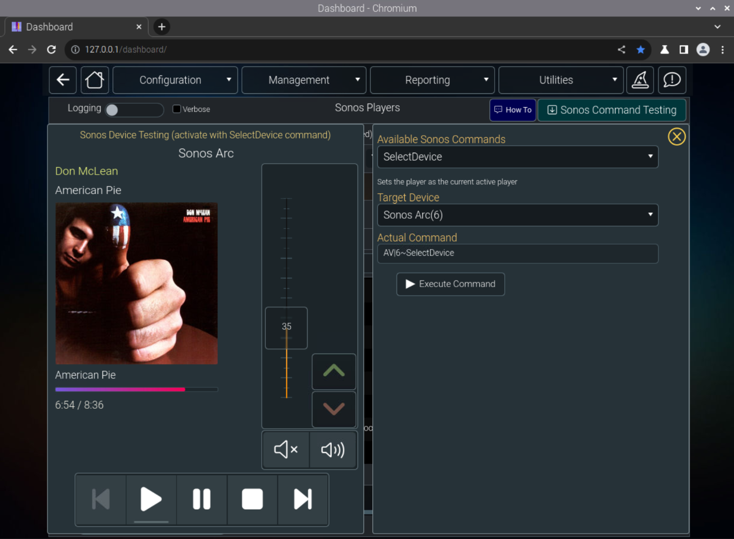

I have the Sonos Driver installed, it found my Sonos ARC and is configured (I think, the "how to" drops you back to the Allonis home page).  None of the commands seem to work.  The IP address is OK.  Suggestion?

That works (the left side "app"), but the individual commands don't work.
AV|6~PlayersVolume~Up for example
Executed on the server doesn't do anything.

Here's the issue...the app issues this,
AV|6~Volume~Up~3
But the command builder issues something different.
AV|6~PlayersVolume~Up~3
Re: Sonos?
#2101
That was a typo in the command builder. I just fixed it.  The correct command is AV|<id>~Volume....
