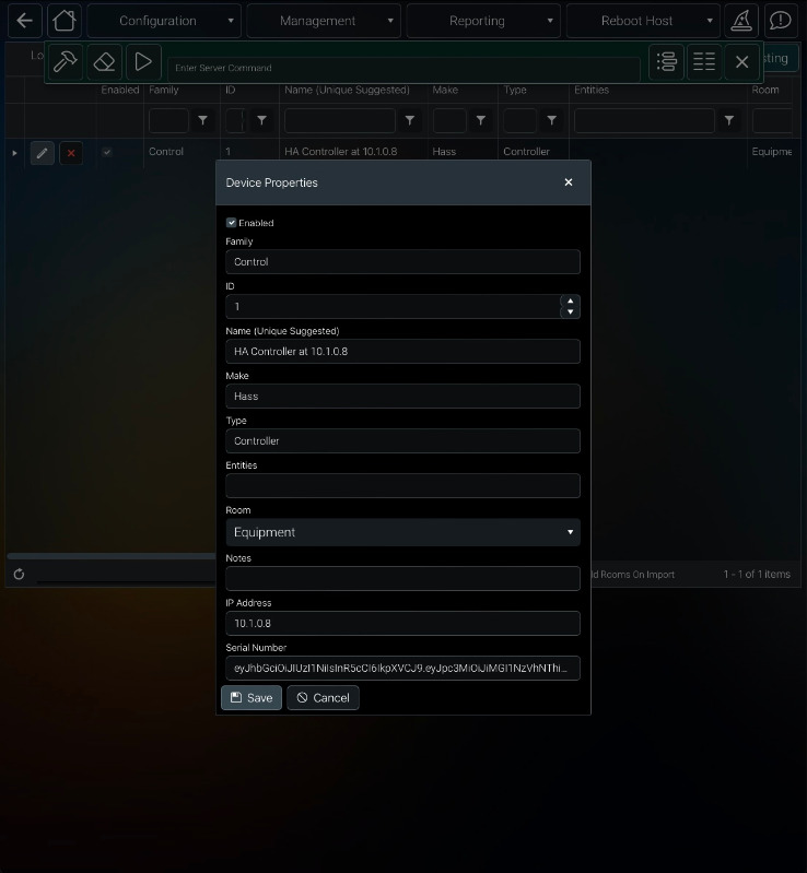

I was able to discover and add my Home Assistant controller and set the serial to the long-lived token I created but no devices are discovered.

One thing I just thought of.  I have the DuckDNS with Let's Encrypt addon installed on my HA.  That requires HTTS access.  I'm guessing myServer only connnects to HA via HTTP?
