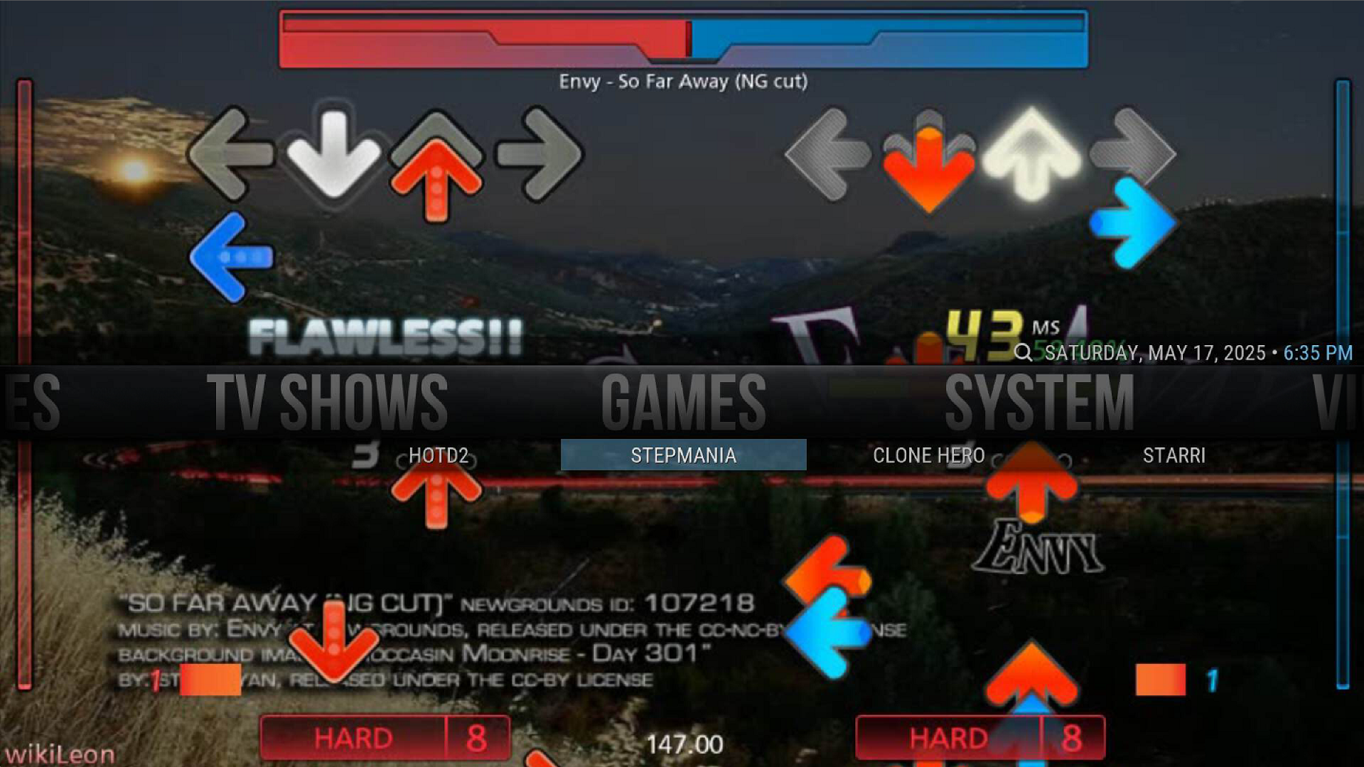

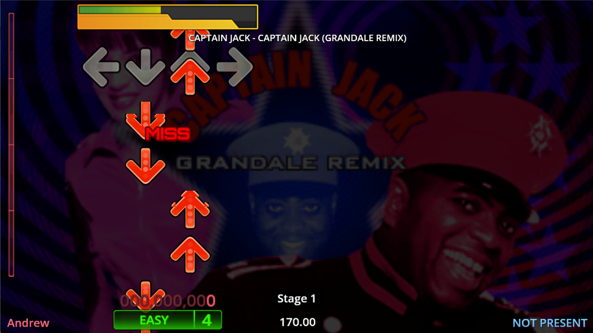

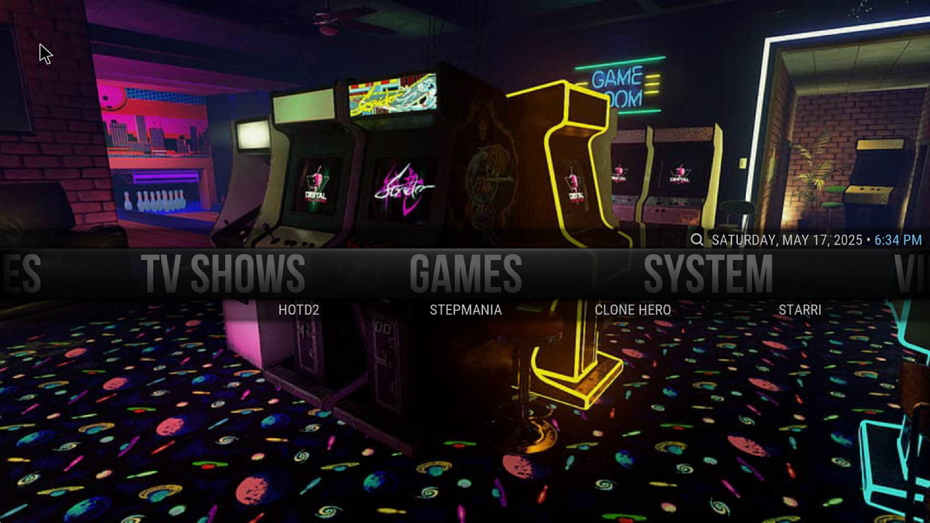

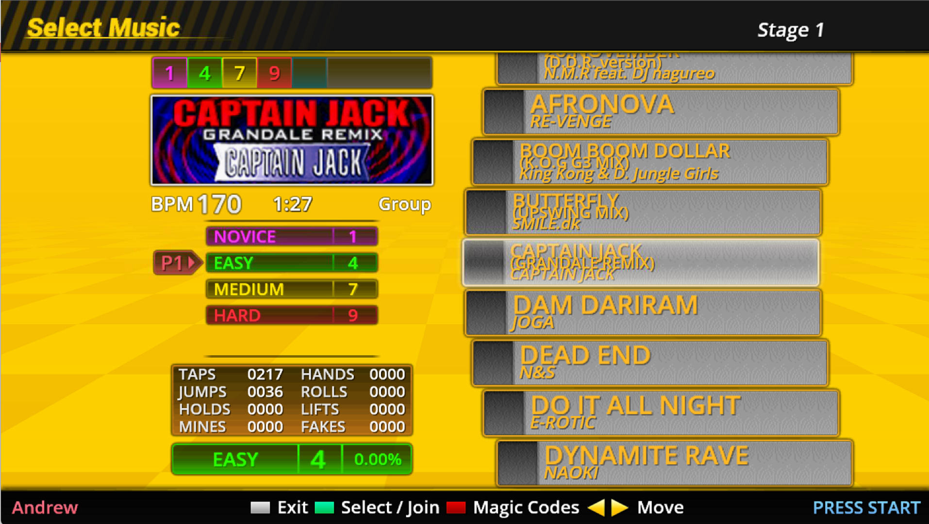

#4282
Just using the remote to operate effectively cursor controls within the game - up, down, left, right, select and back. It's Stepmania which is a Dance Dance Revolution clone so you pick a song with the 'keyboard' then when it starts you do the actual playing by jumping around on a dance mat. I use Kodi as a front end to select which game to play - it's a nice interface for TV and movies and I've added a games section. They're all shown on the attached TV.
