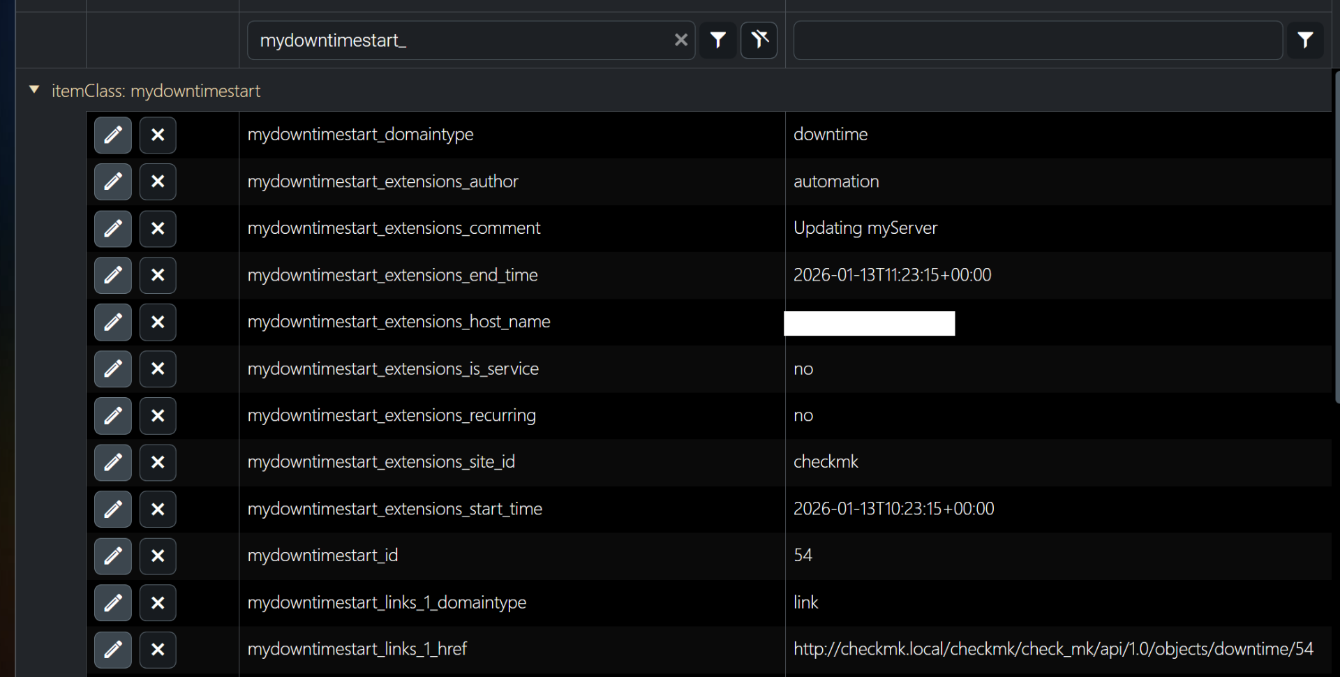

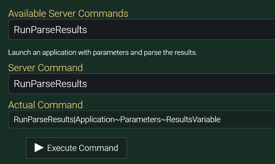

I use RunParseResults to run a local shell script on the server and parse the returned JSON output into myServer variables.
Code:
RunParseResults|/home/allonis/scripts/startdowntime.sh~~mydowntimestart!
