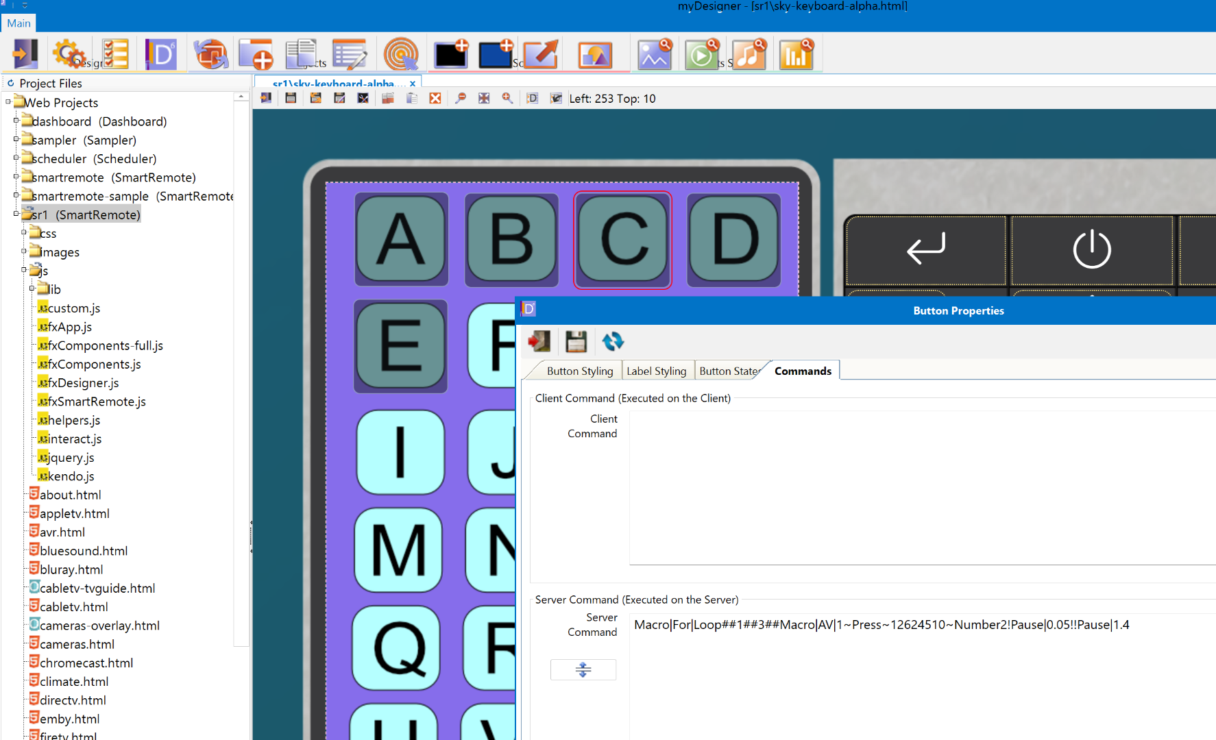

andrew's Avatar Topic Author
  • Posts: 352
Re: Alpha/numeric keypad layouts already included?
2 years 9 months ago
#967
Because I'm me I always try to run before I can walk with a new system. So I've got a proof of concept of my alpha keyboard working in myDesigner. It would be improved if it didn't have the long pause between typing letters if it wasn't necessary e.g. if you go from an 'a' to a 'd' you don't need to have the long wait. I expect I could do that by setting a server variable remembering which letter group you are in ('abc', 'def' etc.) and only having the long pause if your next letter is in the same group. But that's for the future. I'm just pleased I got this working.
