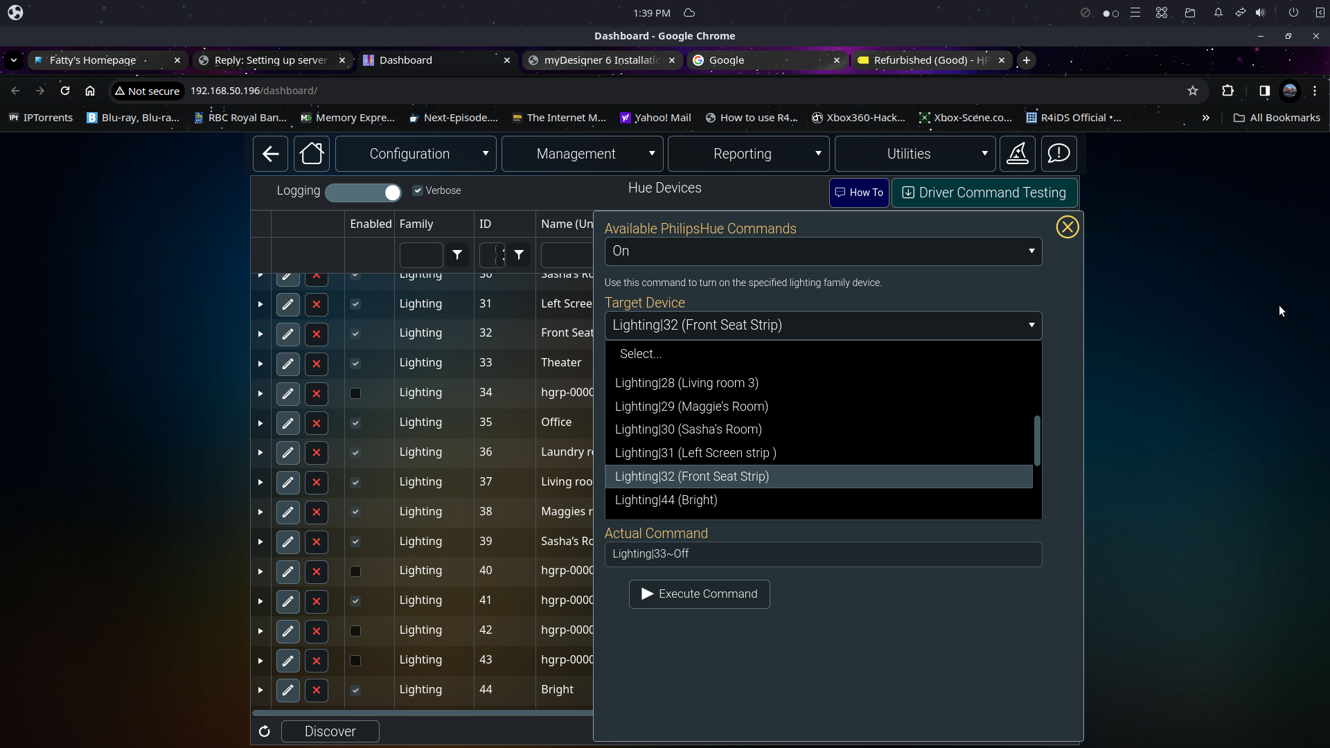

I'm setting up my hue lights and it appears as though when you try to activate a scene it turns all lights in the house to that scene.
Also the "toggle" command only turns lights on, you need to send an "off" command as the "toggle" does not shut them down ?
I'm trying to figure out how to "toggle" a group as well. Seems to only allow toggling of "dimmers" and "scenes".
If I could set it to toggle a group, it would be able to include the 4 "dimmers" in my theater and a corresponding "scene". Is this possible ?

The groups you have defined in the Hue hub should be imported. They'll appear as devices with device addresses starting with G. They should respond to the On, Off and Toggle commands.
If there are no groups you could create a macro to logically group individual lights.
LivingRoomLights is
Macro|
Lighting|1~<p1>!
Lighting|2~<p1>!
Lighting|3~<p1>!
Then  LivingRoomLights|On  or LivingRoomLights|Off or LivingRoomLights|Toggle
LivingRoomLights is
Macro|
Lighting|1~<p1>!
Lighting|2~<p1>!
Lighting|3~<p1>!
Works perfectly when you manually enter the correct id number for the "group", I didn't even think about that. For some reason I thought it could only be one of the listed device targets.
