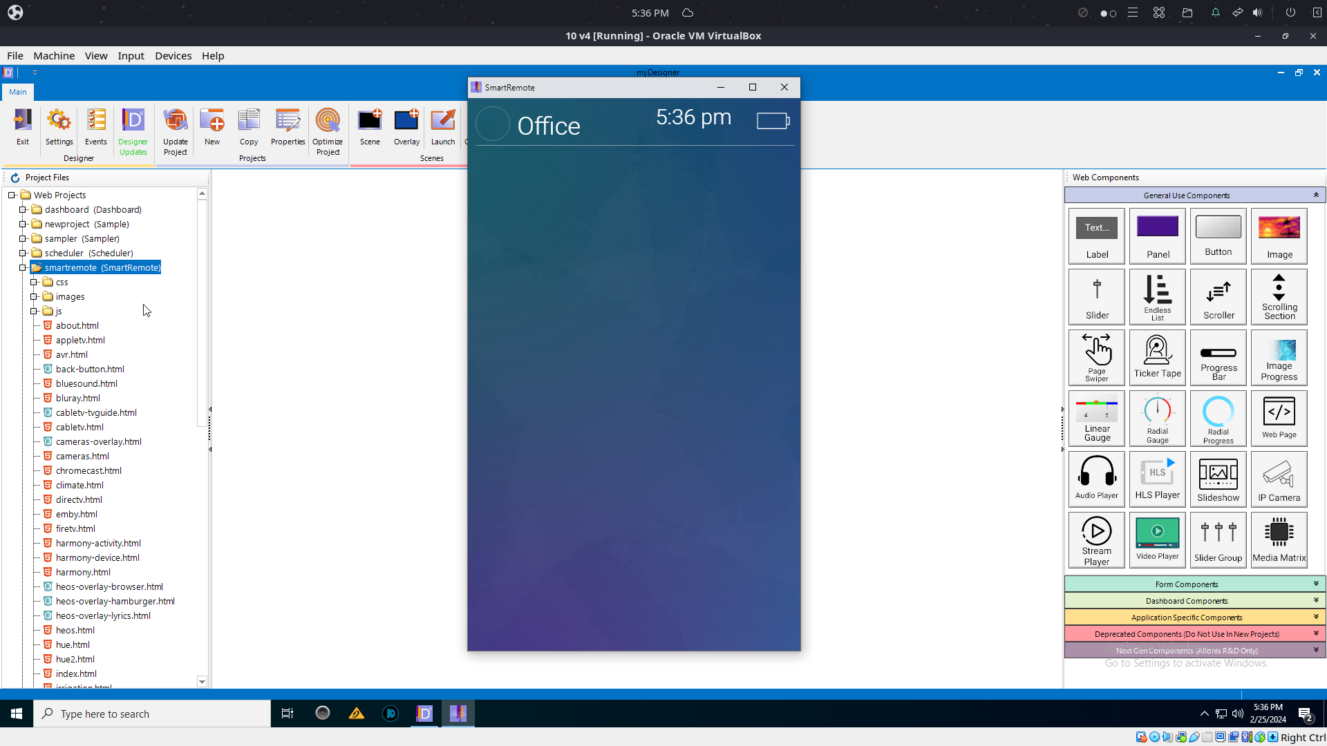

1>>I can no longer access the index.html from my smartremote even on an unmolested sample template, Is this the new "default" or did I bork something?

"1>>I can no longer access the index.html from my smartremote even on an unmolested sample template, Is this the new "default" or did I bork something? "
Yes, There is one Endless list object on the index page. It runs an api call to get the list of active sources for the room. If there is no active room, or the active room has no defined sources the screen will be blank.

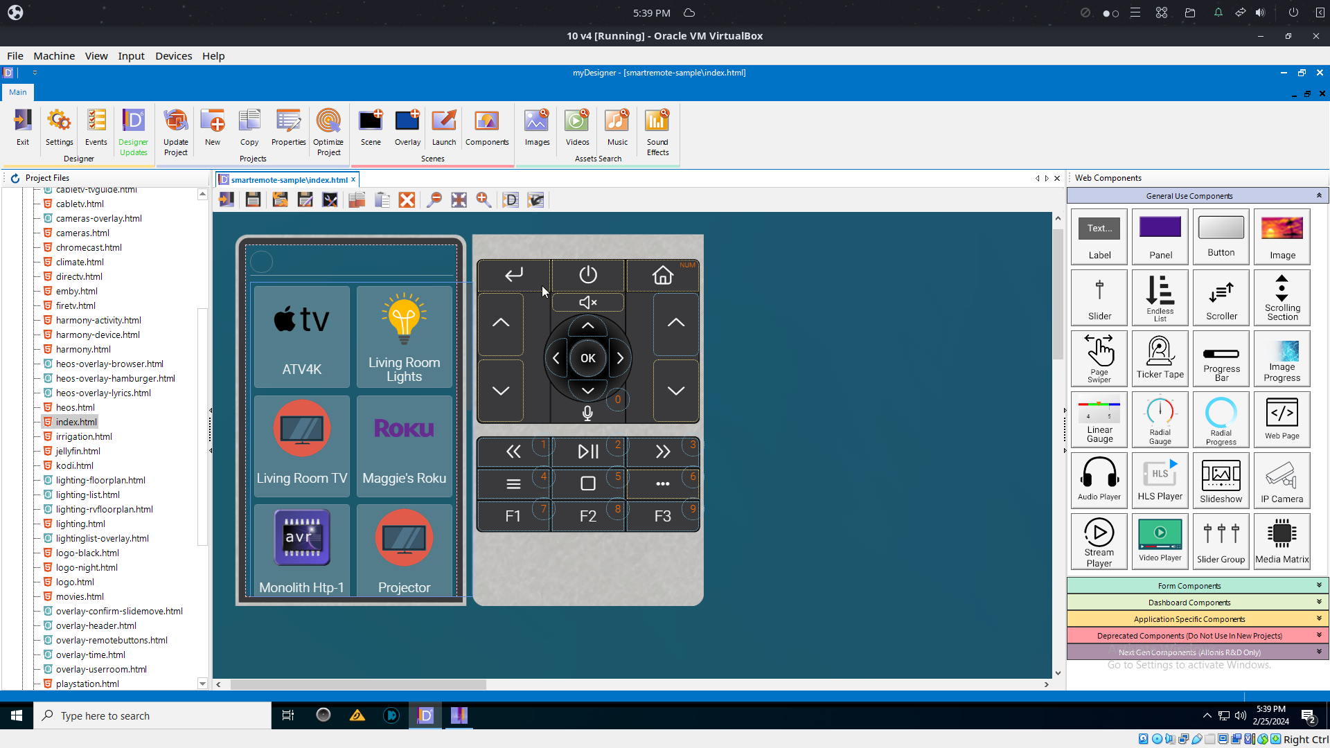

So I need to copy my edited files into the new smartremote template after every update? This is fine I just need to know.
I am missing the "endless list" index page.
I can call up the index page in the mydesigner editing window and it shows correctly but if I try and "launch" the project, it's a hard no. This is all on an un-edited smartremote template. I don't even have an office room defined for selectable in the options(see screenshot 2 and 3).. Where is it coming from?

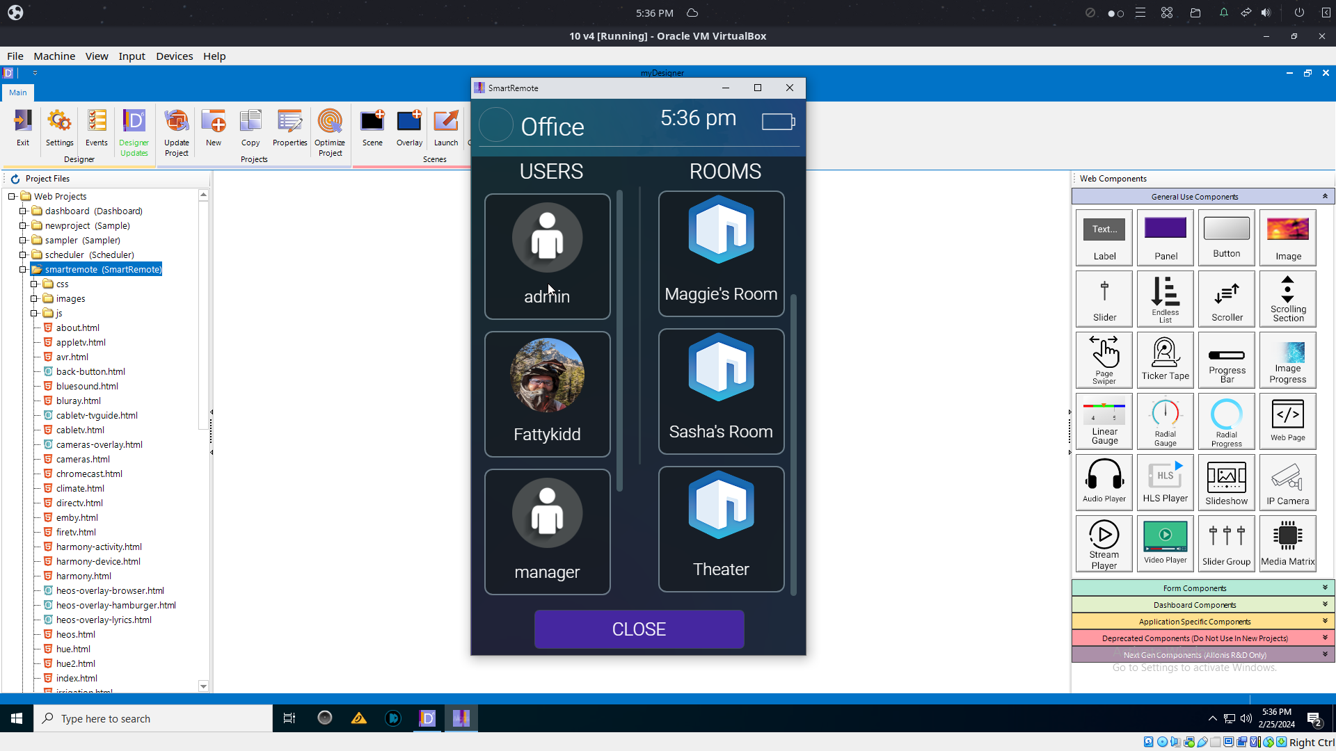

We used to be able to hit the home button and it would take us to the index page that was populated with every device in our system(see screenshot 4), it now no longer goes any further than the selected active room.
Replied by Fattykidd on topic Need some clarity/guidance
Thank you Dave that is exactly what happened, I don't remember adding the overlay to the overlay but the box had a checkmark so.. Will edit and retry"1>>I can no longer access the index.html from my smartremote even on an unmolested sample template, Is this the new "default" or did I bork something? "

2 years 5 months ago #1269
Replied by David Li on topic Need some clarity/guidance
from newer documentation
Backing up the myServer system
Now that you have done some configuration, best to do a backup of the myServer 6 system
Backup the template(s): Create a wwwroot\backups folder. Copy the "smartremote" folder into backups. Download from software updater the "smartremote-sample". Rename that "smartremote" in the wwwroot folder. You are then using the latest files from Allonis. If you had a custom "mywebpage.html", you can copy that from backups\smartremote into the wwwroot\smartremote folder.
Do you want me to TV into your system to see what's up?
