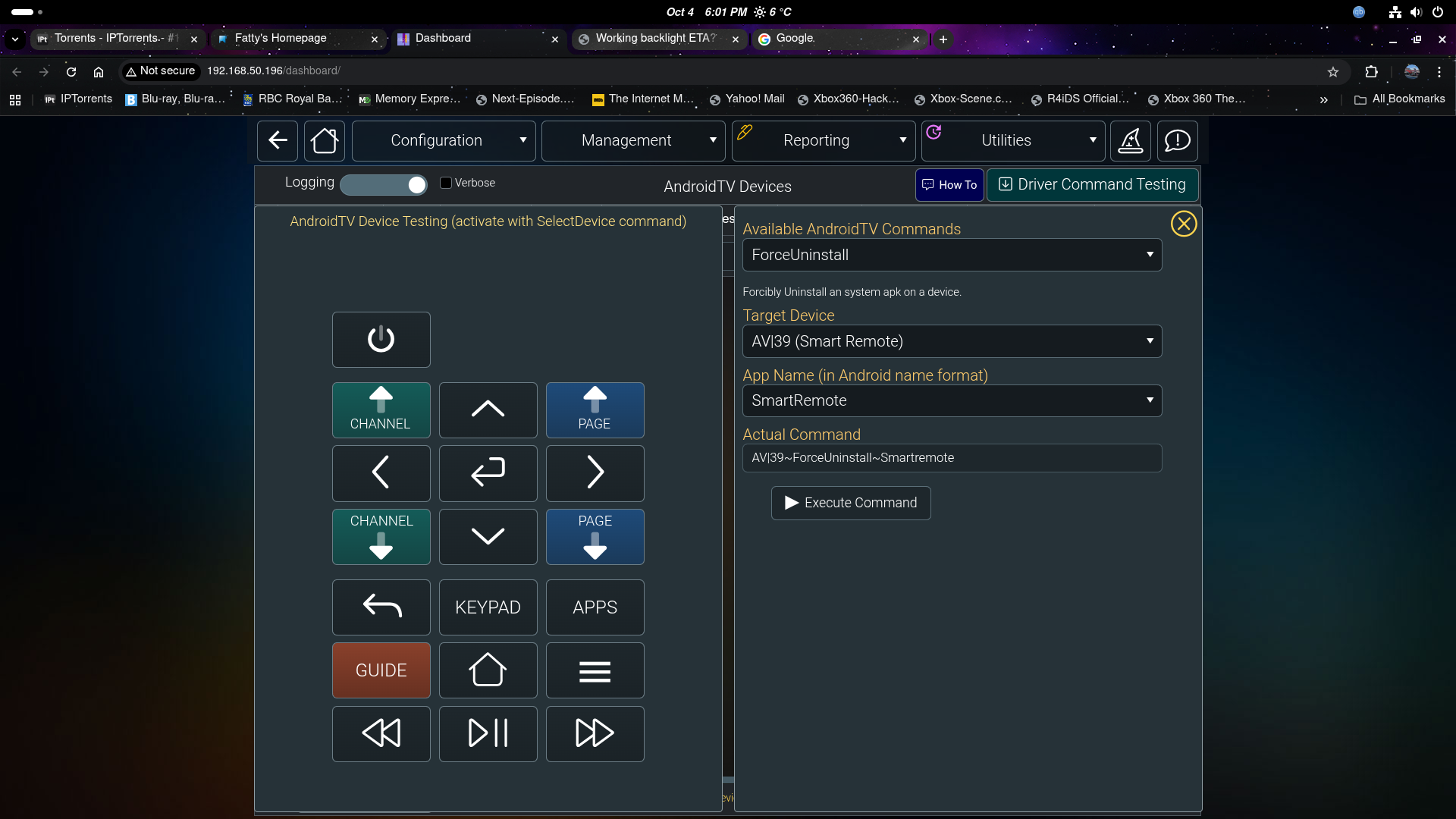

Fattykidd's Avatar
Re: Working backlight ETA?
11 months 2 weeks ago - 11 months 2 weeks ago
#4483
see below
Last edit: 11 months 2 weeks ago by Fattykidd. Reason: update picture

#4484
You need to select FORCED uninstall to remove the original apk software
From the AndroidTV Driver Commands window, (do these steps carefully!) select "Forced Uninstall" and select the SmartRemote device ID and select the smartremote app. Run the command. The SmartRemote icon will be removed, and the SmartRemote will reboot itself. Make sure you select "smartremote" so it gets included in the command to process!!! Forced Uninstall command is only used to remove the original smartremote.apk from the SmartRemote. Any subsequent uninstalls can be done with the "Uninstall" command which does not require a SmartRemote reboot.
