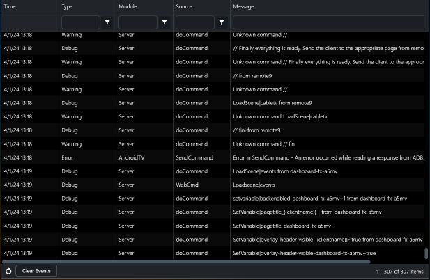

Thanks for the reply - much appreciated. I've done as you suggested and nothing happened so I had a look at the log and I can see that it's trying to do what I want but I'm getting lots of warnings and debugs about unknown commands.Any ideas?

If I had to guess, it looks like there's a missing or extra exclamation point in your activation script. MyServer is trying to run the comments in your script, not the actual commands.
Can you copy and paste your activation script into a text file and post a copy, and also show a screenshot of the activation command in MyDesigner?
