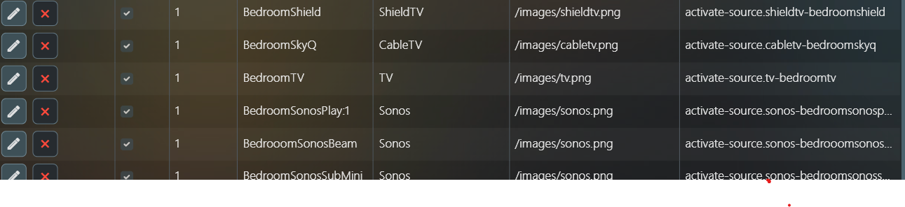

The TV is a Panasonic. I had to set it up using IR Database, Generic IR & TV IR. Following on from one of your replies I have renamed it (and Sky & Shield) to BedroomTV

If a line in a macro begins with "//" then everything after that until the exclamation point is a comment and is ignored.  Bowlingbee showed the commented SetVariable command--if the leading "//" is removed and HDMI is replaced by the proper source for your TV, the later line with the If statement will change the input on your TV,
Now that you've renamed your sources, your activation macros should change names as well.
Just to double check--all three of your devices (Sky Q, Shield, and TV) have unique names?

Yes everything has it's own unique name
