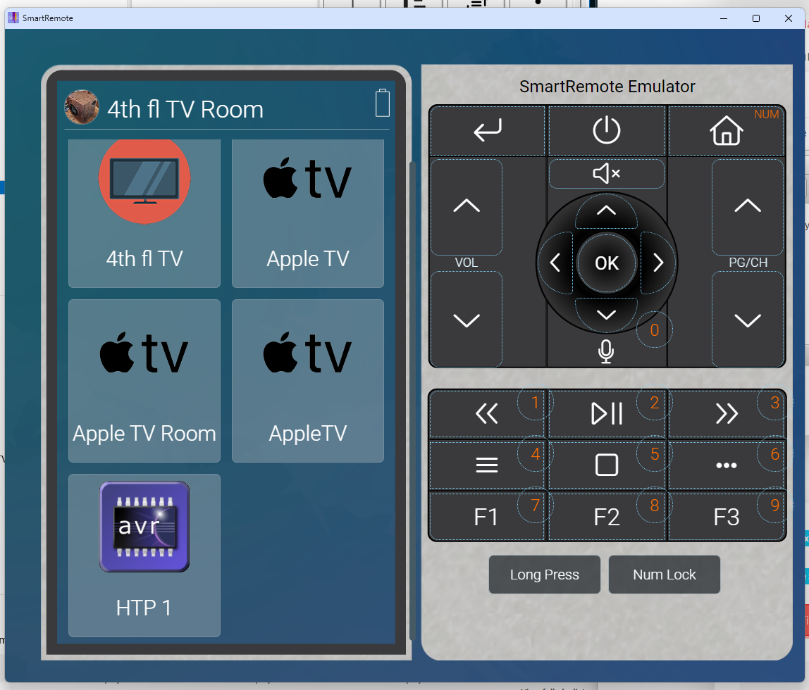

I watched the video Using Myserver and SmartRemote and followed along. Things went pretty well. But I have an issue in MyDesigner where Apple TV shows up 3 times and the Shield doesn't show up at all.

looks like you have three different AppleTV devices assigned to the room you were logged into.

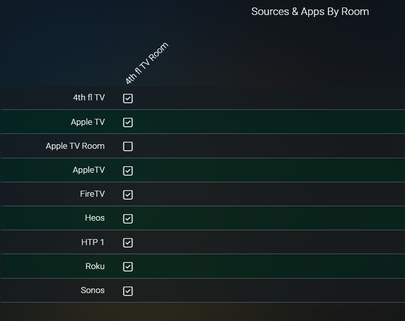

in myServer, go into Configuration / Sources and Apps by Room and deselect / delete old or unneeded devices from that room.

That list is auto populated based on your myServer configuration.. In myServer go to Sources and Apps by Room and add your Shield TV to your 4th floor room to get it to show up.
Do you have more than one ATV added to your Apple TV driver in myServer? The fact that you have one labelled "Apple TV Room" looks a little funky.
I would check your ATV driver page and your Sources and Apps page to make sure all looks in order  Also check in the same Sources and Apps by Room that you go to for the Shield TV.

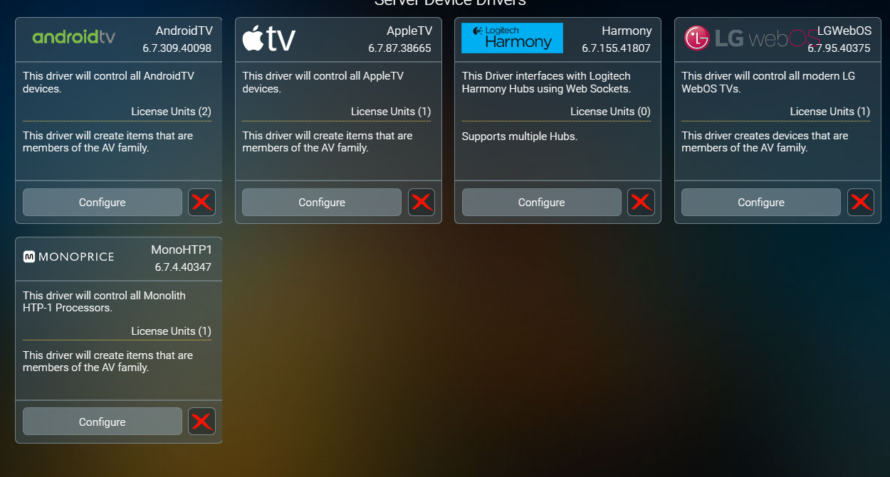

rec head's Avatar Topic Author
  • Posts: 66
Re: I still can't get this thing to work
2 years 3 months ago
#2767

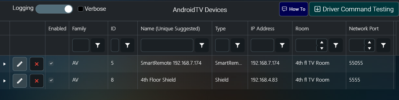

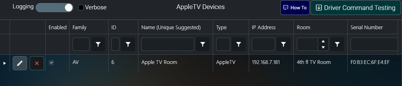

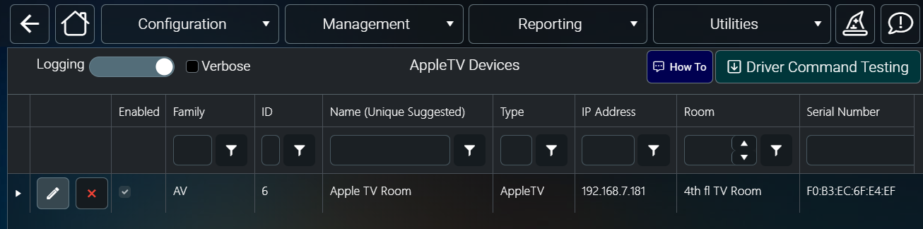

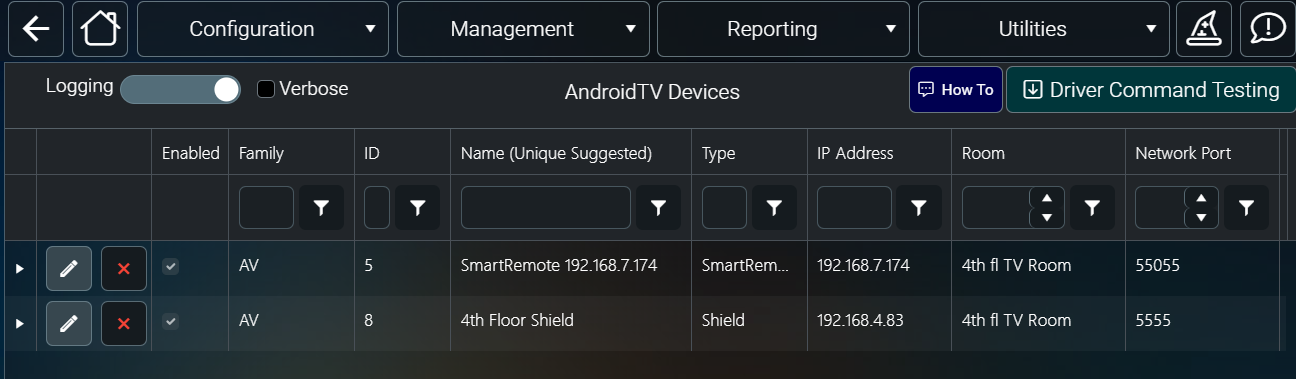

I can't directly paste images into posts and flickr is having issues so I'm adding the images as files.
Going to Sources and Apps By Room shows my devices but also a bunch that I don't have in my drivers. Clicking the check boxes does nothing. See images.
I am trying to follow the videos. I have gotten to the Working With Scenes And Overlays video but don't have the project that is being used in the example to follow along. I don't know if I'm supposed to have that project but I'm following the videos in the playlists on YT and don't have it. I'm about 3 hours in and haven't gotten anything done.
