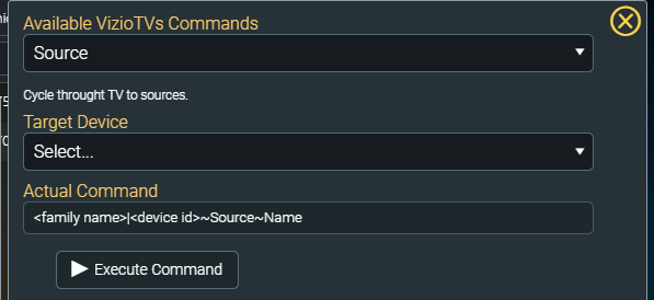

I'm trying to test the Vizio TV driver by changing inputs between HDMI2 to HDMI3 and as I'm using the driver command testing, I'm selecting the Source command and I see the Target Device and Actual Command example (which shows <family name>|<device id>~Source~Name).  After I select the device, I don't see a way to select the Source Name, like I see with the LG WebOS driver.  Is this something that's missing for the Vizio TV driver?
I tried to send the actual command of AV|2~Source~HDMI3 but it just opens the input menu on the TV and doesn't do anything else.

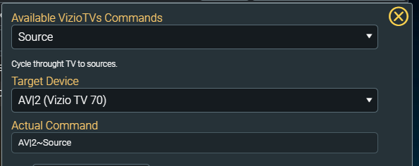

I see that a new Vizio TV driver was released but I'm still having issues changing the inputs.  When I select the Source command, I see the full command listed but then when I select the TV, the command seems to get truncated to not allow the last part.  I also tried entering an input at the end of the command manually, like so:  AV|2~Source~HDMI3
Is this something that is broken or maybe Vizio doesn't fully support this?
Here are some screen shots of what I'm seeing.
